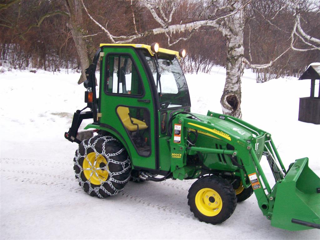

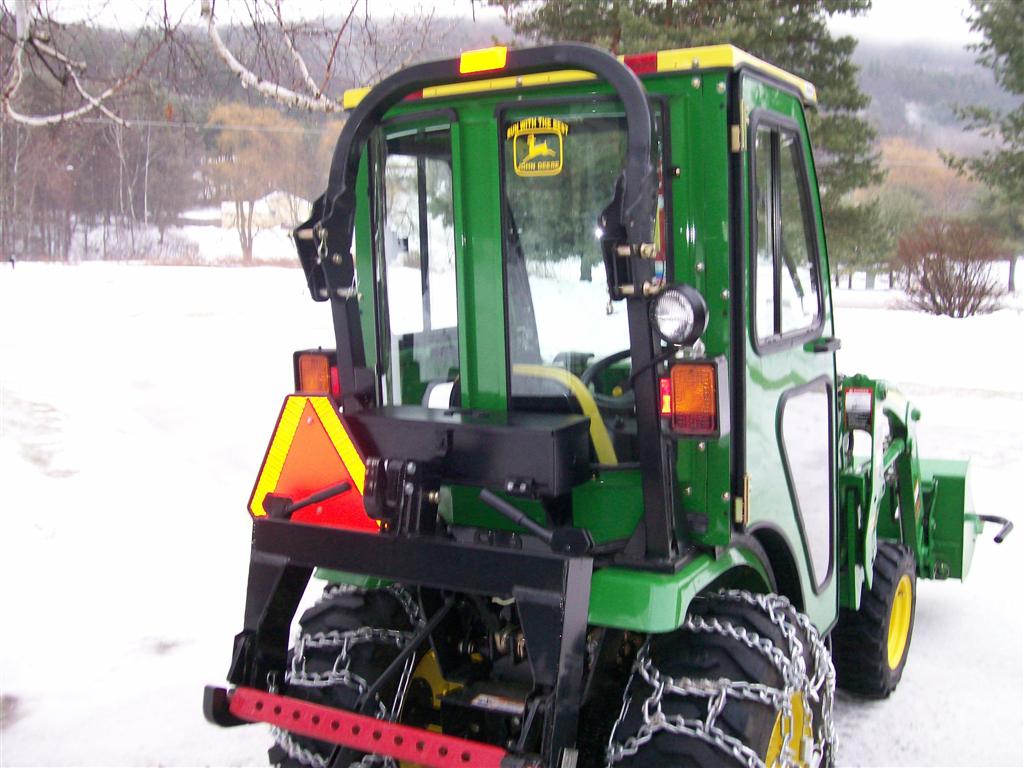

Here's a couple of pics of what they look like on my 2320.These are the Duo-ladder combos.If you have to drive over any asphalt you definitely know you have chains on! Rough ride.I don't think those cable chains would work very well,I think they would work there way in between the lugs?
Tim

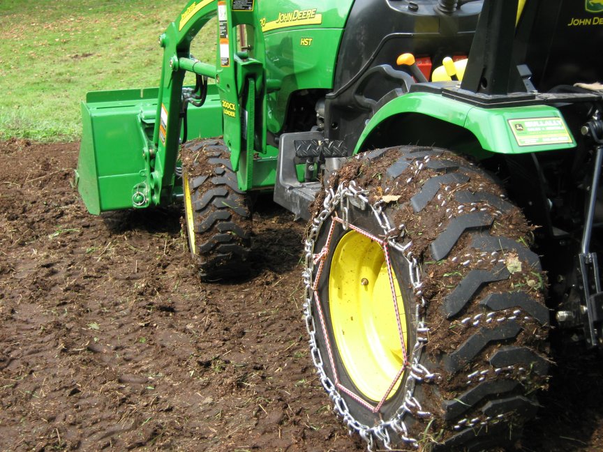

IMG_0263_1.jpgHorse manure, don't ya know!
/ Part # for 2320 Tire chains #10
Gizmo wow! Talk about working there way in between the lugs.If there was ever a competition for that you would win for sure.:p
Tim
Yup, that made me feel real good.:D As I live and learn!
