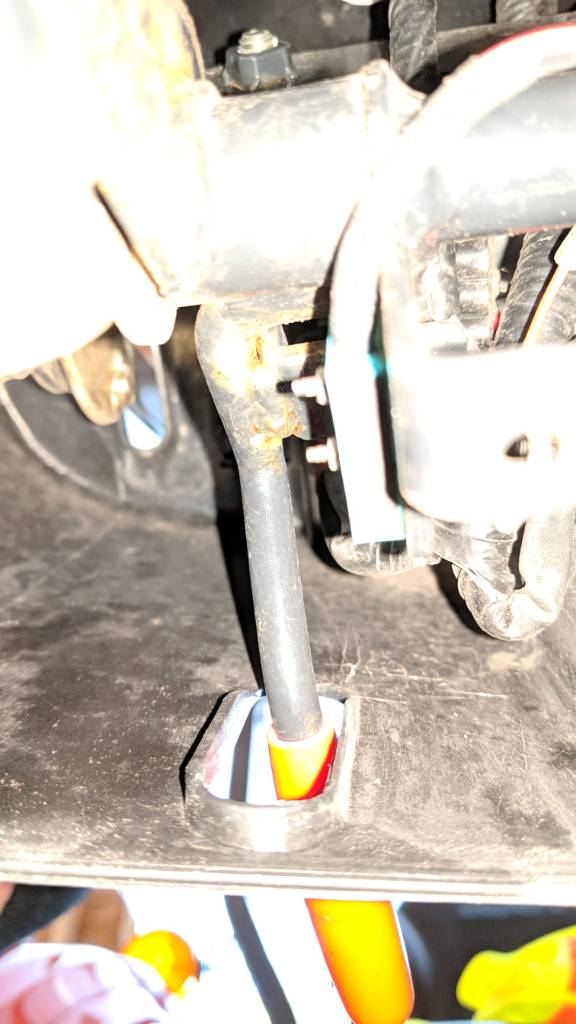

Do you get a warning light on your dash when you set the parking brake and tractor is running ?

My older DK5010 has the brake indicator and I took two photos up under the dash. The first overexposed (sorry) photo shows the brake lever going through the slot in the dash and two small bolts holding the brake switch. The second better photo shows the switch plugged into two barrow connectors.
The second photo is the important one. If your wiring harness has two connectors dangling where a switch would go then you may be able to get the indicator working. Start by connecting the two terminals together to simulate the switch closing and confirm that the brake light comes on (with ignition on). If it does, buy a switch at the dealer or on Amazon and you'll be good to go.
Let us know what you find and it will help other owners.

My 2004 model year CK30hst has the parking brake light and it works. There is a small micro switch that works off the lever that locks the brake pedal. There is one or two dash indicators on mine that were never used by Kioti on my model but the same dash was used for other models and the light was wired for them.

KIOTI CK10 Tractors do not have a Parking Brake switch. You will only see the light when the key is turned to "on".

Thanks for the reply and link ThreePoint , and Michigan Iron. I guess if I want a brake light and 4WD Light I’ll have to wire it up
myself. Appreciate all the input.

Dullpain:. Can you confirm if you at least have a set of connectors on your newer CK to enable you to add a switch? Then also reply if/when you decide to jumper them together to test the light to your dash.
Since the 4WD indicator discussion came up, I would like someone with a working 4wd indicator to share a photo of the switch setup and where the connector is located. This is something that I would like to get working on my DK.

My 2018 CK35010SE HST has a parking brake light on the instrument panel that illuminates with the rest when the ignition is switched to "on", but, as Michigan Iron & Equipment posted, there is no switch installed to illuminate it when the parking brake is set.
Also, I'm wondering if your linkage might need adjustment on your parking brake. When my brake is firmly set, the tractor won't move! :no: So, as a practical matter, I don't even need an indicator light to tell me I forgot to release the brake. :laughing:
