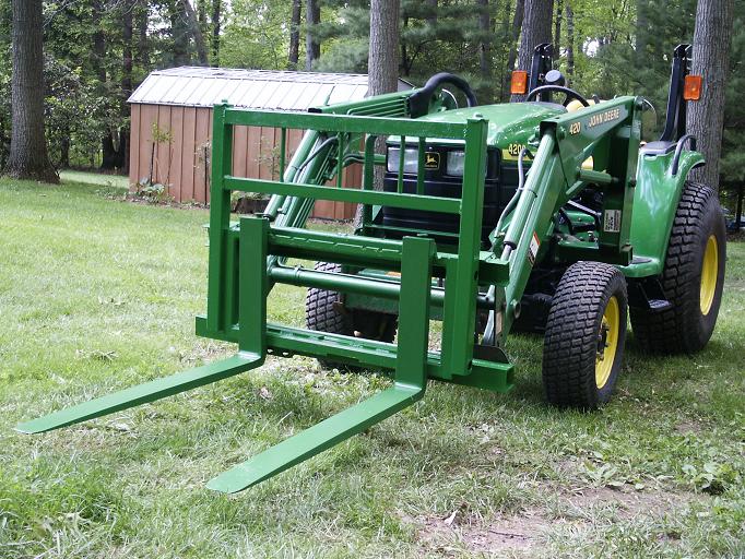

   / pallet forks #40
If you can weld or have a friend that does you fan build them fairly easily.
I bought the bare forks and frame at an auction for $80. Bought the attaching hardware from Deere. I figure the total cost was around $160.
M.D.
