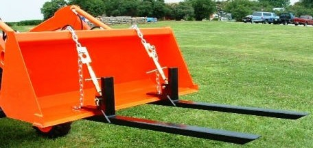

Between the clamp on forks and the SSQA forks are these chain on forks, spreads the load on the bucket, I have these, good quality and work well. Has a hole for a spreader bar but I haven't needed one. Good service on the sale and delivery: Bucket Pallet Forks - Pair

Clamp on forks might work depending on how high your standards are but they’ll never work well.
You're not wrong, per se, but I do this all the time with my clamp on forks. My bucket would probably be pretty tweaked if I didn't have the iowa-farms toothbar on there reinforcing the lip (my forks actually clamp directly onto the toothbar steel). But the forks go on/off easily, and carry loads like this quite reliably. That said! I am upgrading to a new tractor with SSQA and real forks very soon.

I thought of one advantage that I like with the bolt on forks - I can install them at the very outside edges of my bucket, to get them nearly 60" apart. This is really nice when moving large logs, for side-to-side stability. Narrow forks make logs much more tipsy.
Also you can buy another set etc. and have 4 or more forks!
When I had my tractors co-located I tried that when moving a lot of various sized limbs.
When I use my forks I also USUALLY use a chain or rope also for stabilizing the load.

i had a set i used for a couple years until i got a quick attach set.
the stabilizer bar and chains are necessary for the forks so they wont turn or swivel. i did get a lot of use out of them but i get more use out of the ones i have now.
