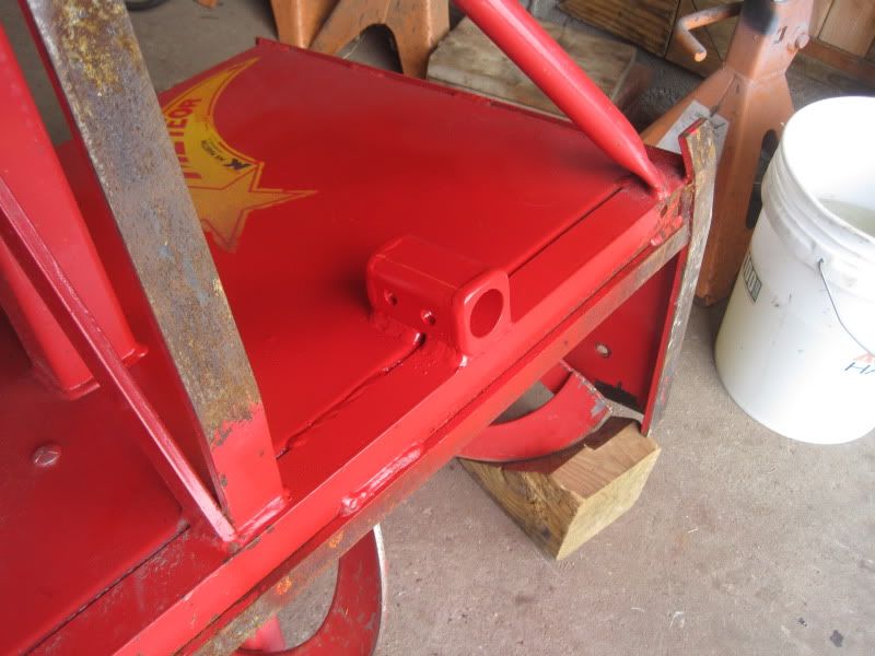

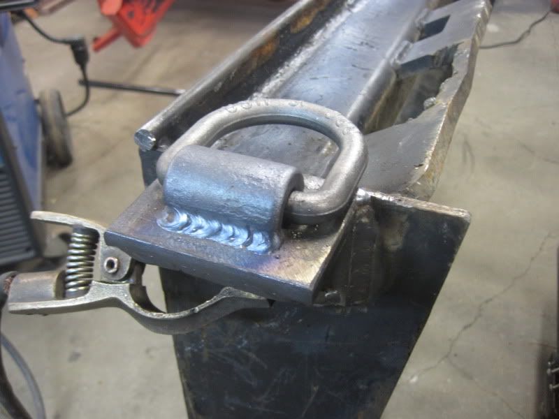

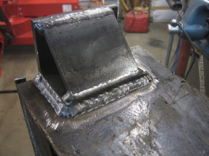

Wanted to get a plate for simple lifting purposes, but realized that I could do the same with my pallet fork plate. I wanted to eliminate the forks for lifting stuff, so I added some D rings on the outside. After some thinking, it seems the outside was the best place to avoid intereference with the forks themselves...
Pics...1/2" x 2" x 2" angle iron gusseted with 1/4" x 3" strap...
Final product..

Nice feature, did you build your pallet forks?

Very nice! I have a set of 48" Bobcat brand forks that I picked up on eBay. I believe I may make the same modifications. Thanks for sharing.

Like a pocket on a shirt!

Welding on chain hooks also works well.
I thought about those, but they don't work well with lifting straps and I already have 3 on my bucket. For lifting I use my straps and I can still use chains with the d rings.
   / Pallet forks add on D rings for lifting... #10
I've used the weld-on D rings quite a few times too, and they work very well.
Funny thing is, right above them on the shelf at the local steel supply is a label from the manufacturer stating that D rings are not suitable for lifting or use in any overhead application whatsoever. Tie-down/lashing applications are the only *approved* duties as per the manufacturer's literature....
