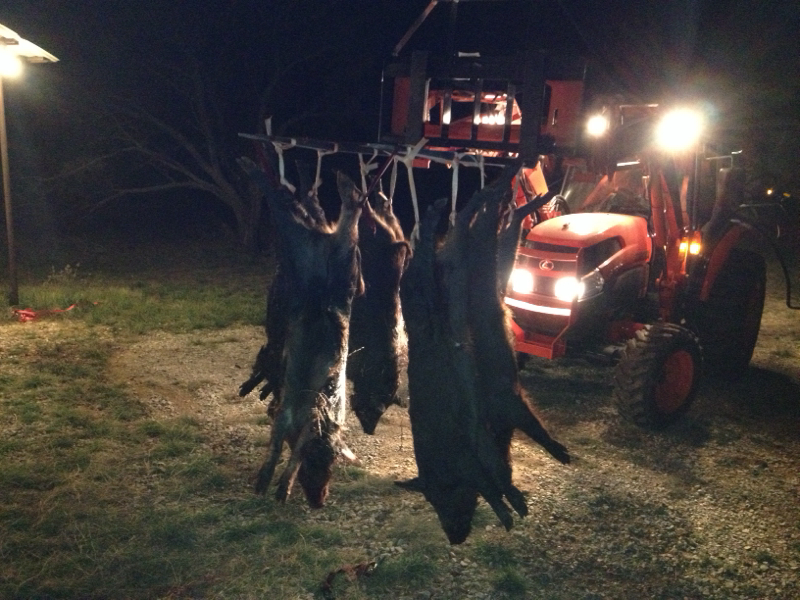

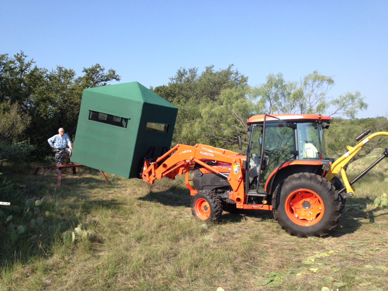

My approach to attachments or implements is go as big as possible based on current tractor so if I upgrade tractors it will be on the lower end of the bigger tractor and can get by. Did this with my forks and 76" Gannon box blade so far. I can see 70-95hp in my future.
Here are a couple pics of things I would struggle with if I had smaller forks. Have 48", kinda wish I went 60".
YMMV
J

Yeah i agree I'd rather have slightly over rated implements
I managed to bend one of mine about 12" back from the tip they areconstruction attachments 48" 5500 lb heavy lift forks forged. I got it traped under a dumpster when i tried to roll out it was in a 3pt bend

My approach to attachments or implements is go as big as possible based on current tractor so if I upgrade tractors it will be on the lower end of the bigger tractor and can get by. Did this with my forks and 76" Gannon box blade so far. I can see 70-95hp in my future. Here are a couple pics of things I would struggle with if I had smaller forks. Have 48", kinda wish I went 60". YMMV J
C4;
You could look into longer (60", 72"?) pieces of channel with a few flat bar straps across open side of channel, that could just slide over your existing fork for the times you need the length.
