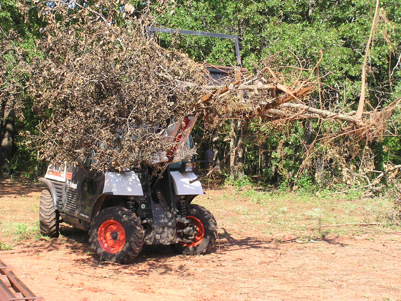

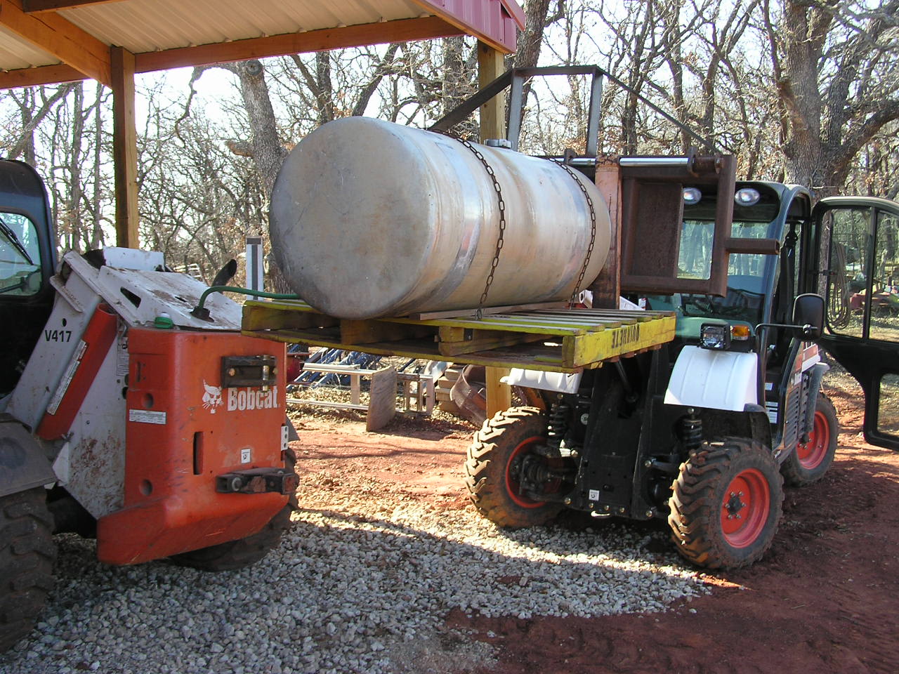

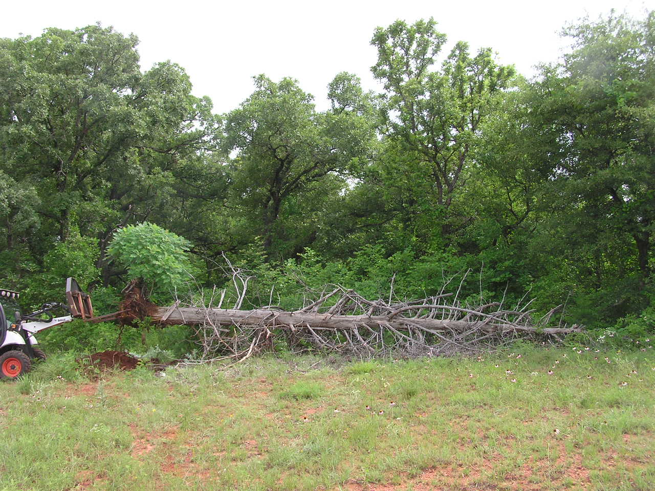

/ Pallet fork size - 36", 42" or 48"? #18
These are 42" pin top forks from a forklift repair shop. Each fork weighs 135 pounds, frame is 284 pounds.
Found these 48" block forks on eBay. 2" square and weigh 80 pounds each. Already had the light frame.
