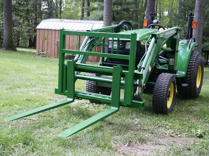

If you're handy with a welder make your own. I got the forks and frame for $75. at an auction, had some channel and angle iron laying around and bought the connecting hardware from Deere. They cost about $160. total.

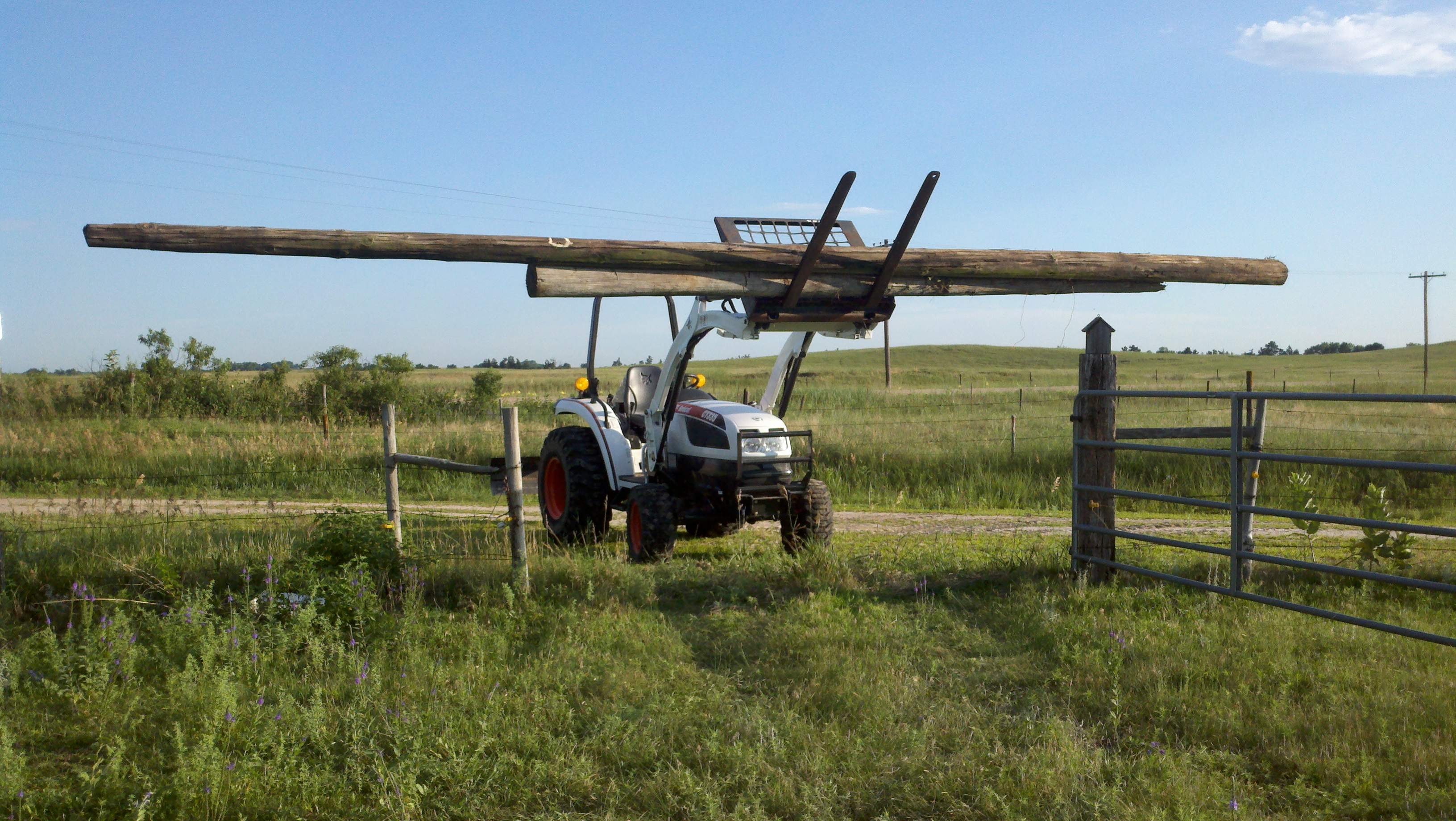

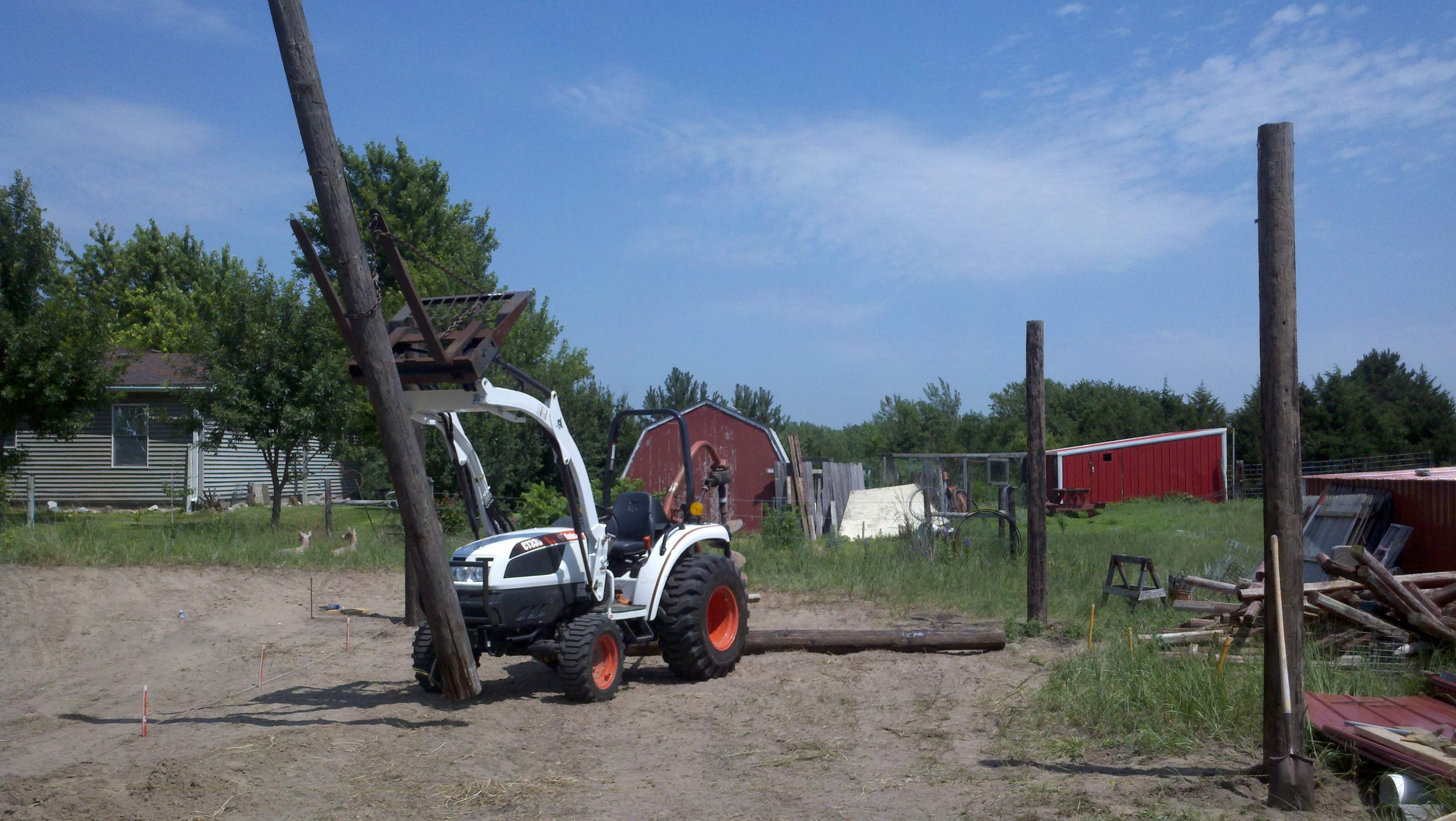

The Bob Tach attachment system and a set of good forks is the only way to go if you own a tractor. Tons of uses I find more all the time.
