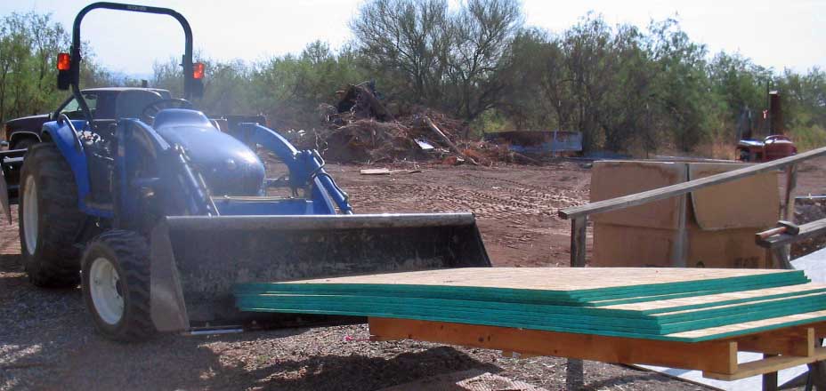

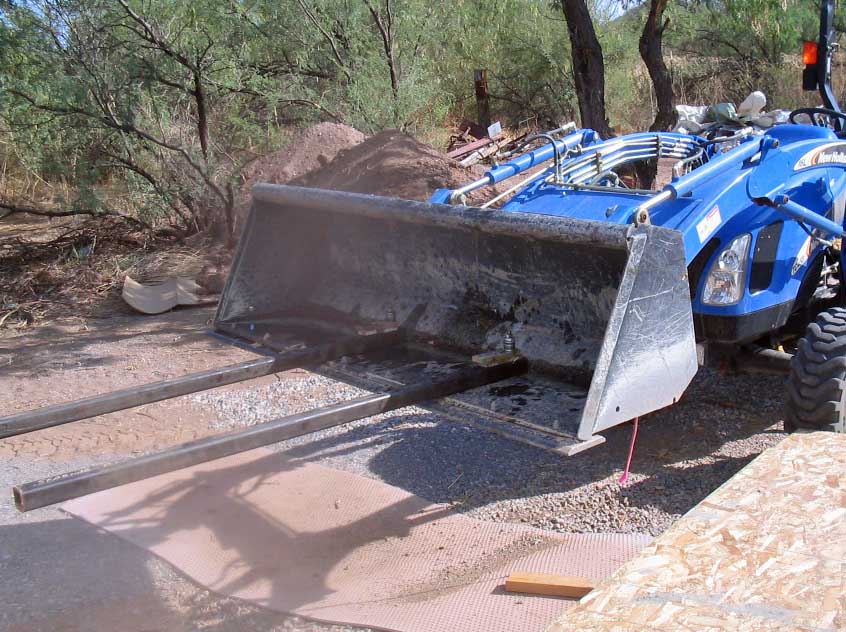

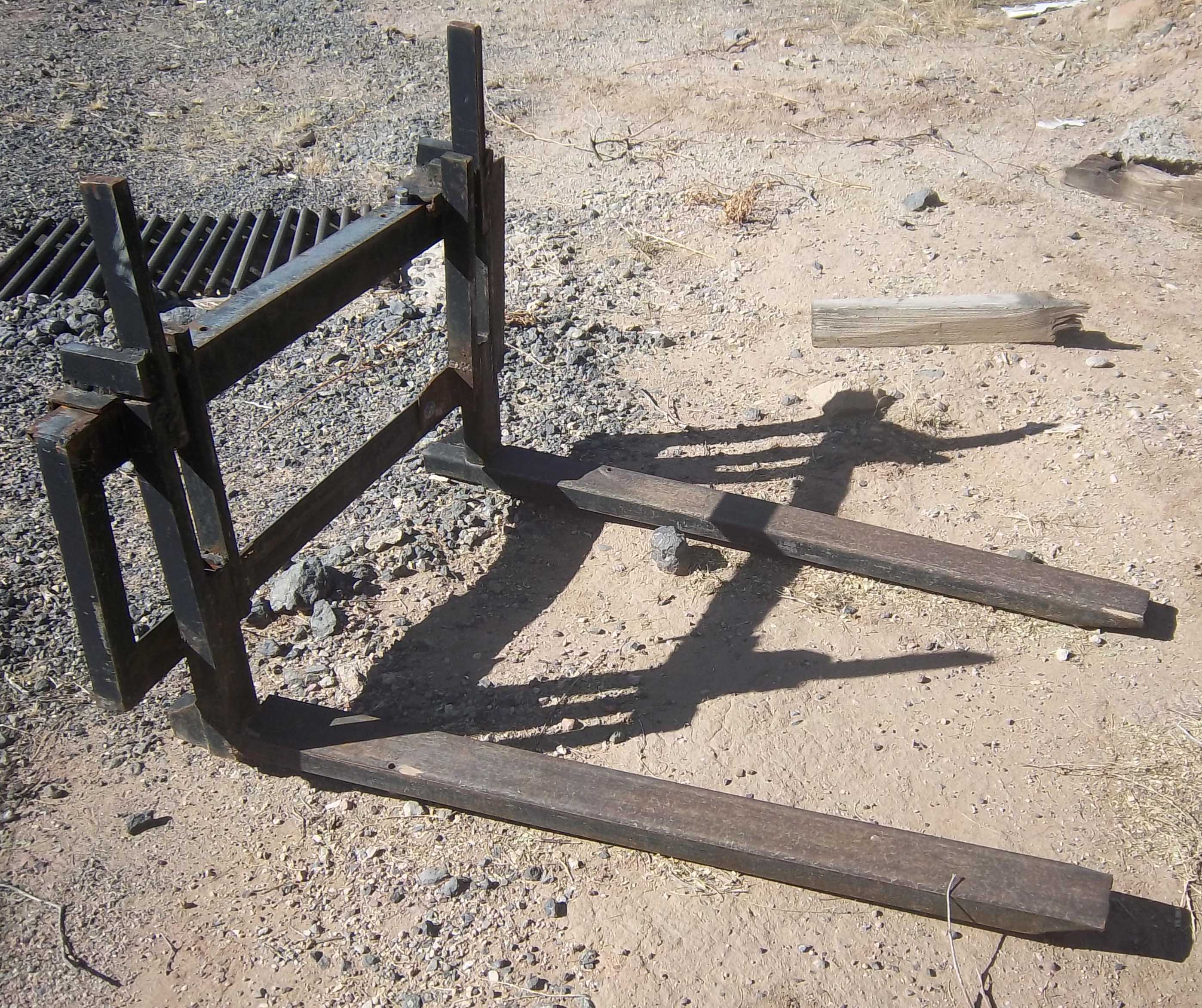

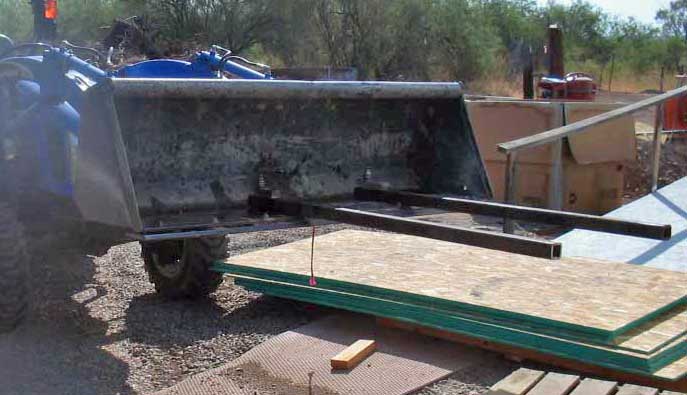

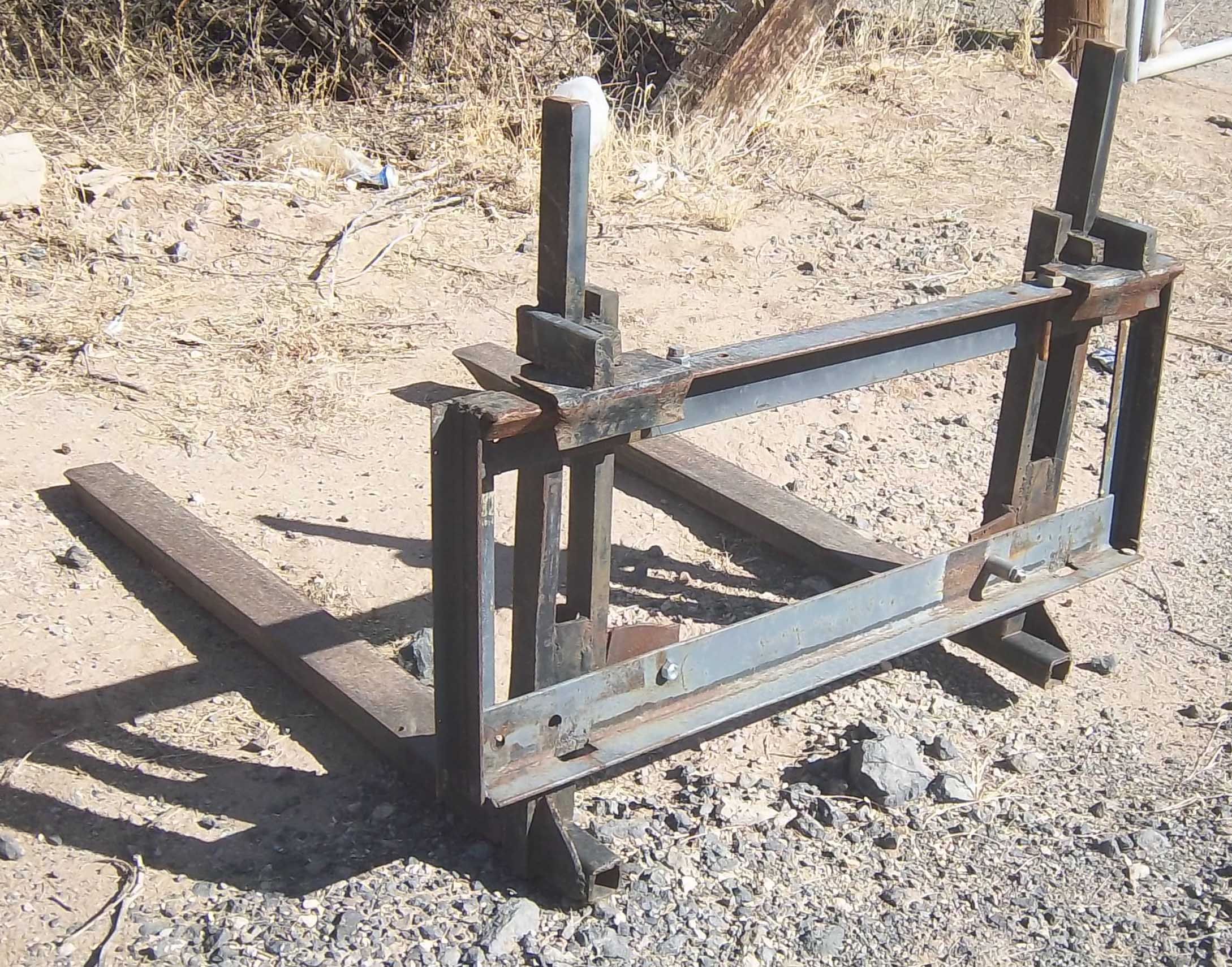

I have 3 sets of forks for my TC45 all home made. Simple and very cheap. #1 set is for lighter loads, rarely used anymore as it is so quick & easy to put on the "real forks". #1 would pick up over 1,000 pounds (11 or 12 sacks of cement.) Real Forks will lift 2,000 pounds if at the back of the forks.
The Real Forks take 1 or 2 minuets to put on or remove. They have been used and abused for almost 4 years. Such as digging out big rocks & packing loads of brush & trash.
Not shown is a pair of shorty forks, rarely used, but handy now and then.
Took about 2 days to build the real forks and they even had a nice paint job at one time. :D
