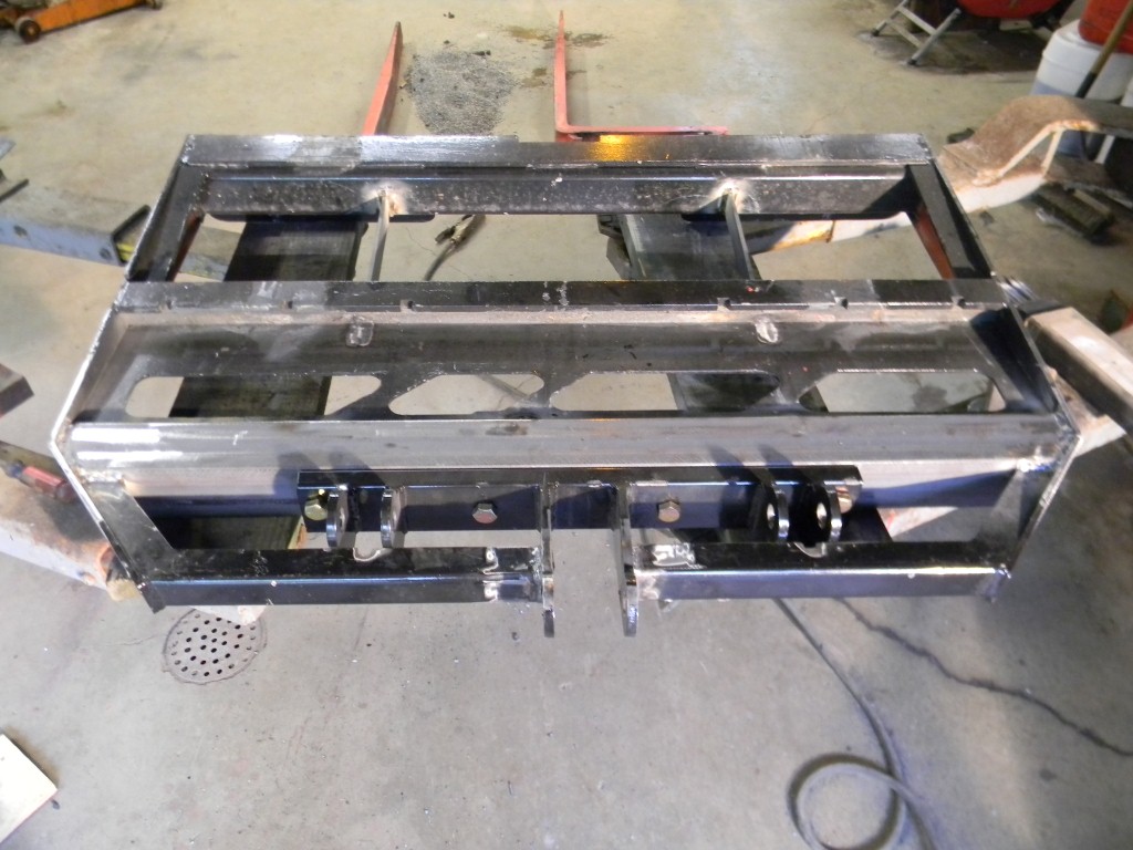

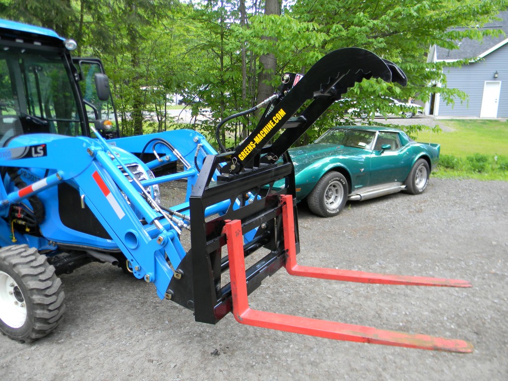

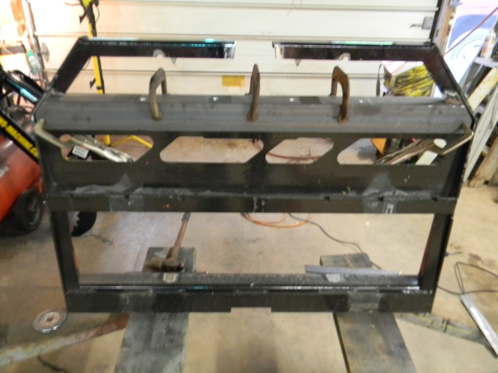

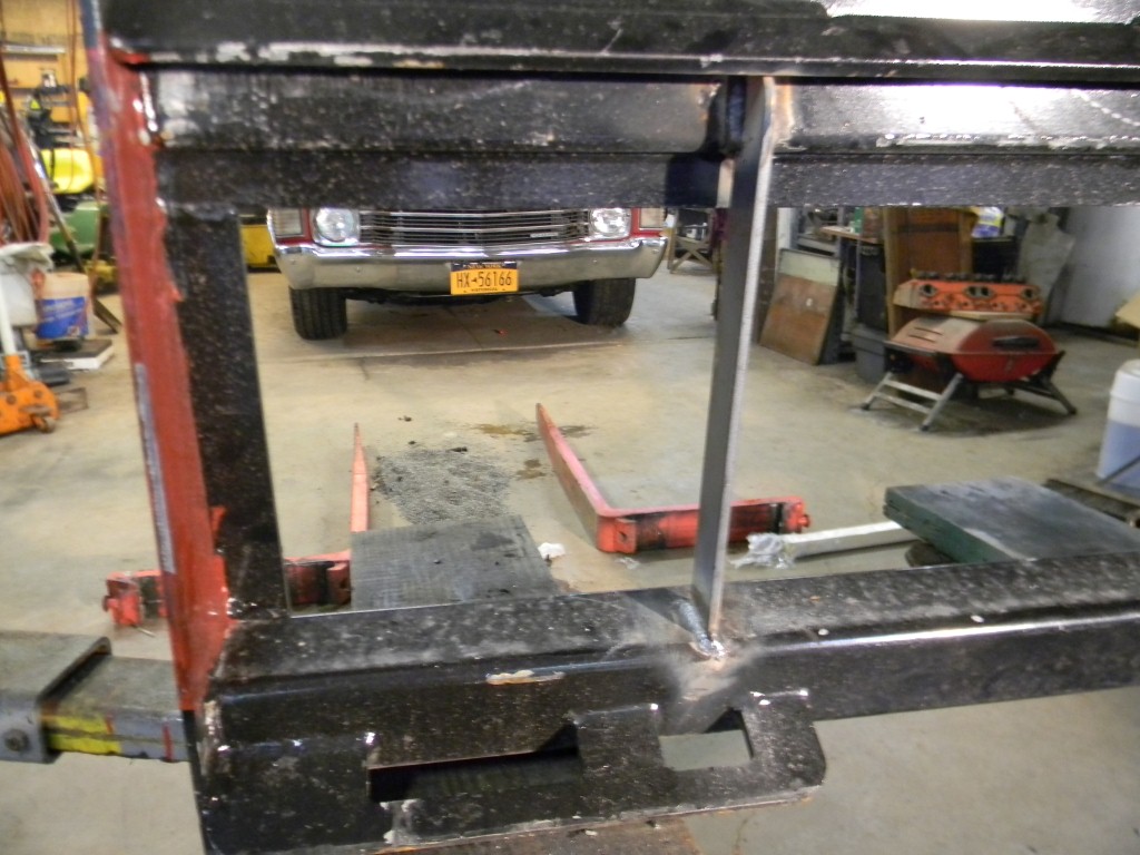

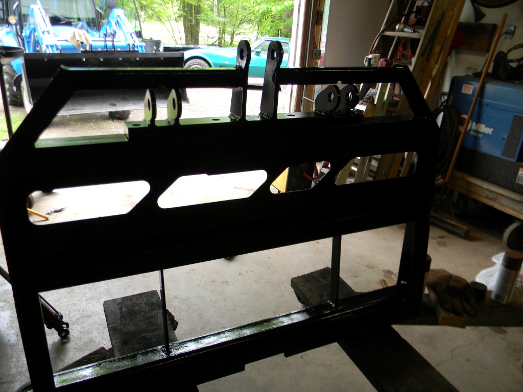

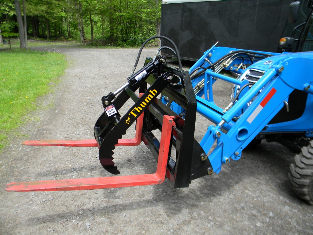

I modified my forks for adding a thumb and added additional steel bracing. In the background you can see the added thumb mount on my bucket so I can switch the thumb to it if needed.

I suppose something like The Thumb would be reason to get pallet forks (or at least the fork blades) with significantly greater capacity than the loader so they can hold up to the additional down force?

I bought my forks from a local supplier. Mine are sold as skid steer forks. I don't remember the rating but they are either 4000 or 5000 lb. I think the rating is stamped somewhere on the forks. I didn't pay too much attention because I know the rating is almost double what my loader can lift and that gives me confidence they shouldn't break with a 2K load. The thumb just holds things such as logs or brush from falling off the forks and no pressure is on them from the thumb.

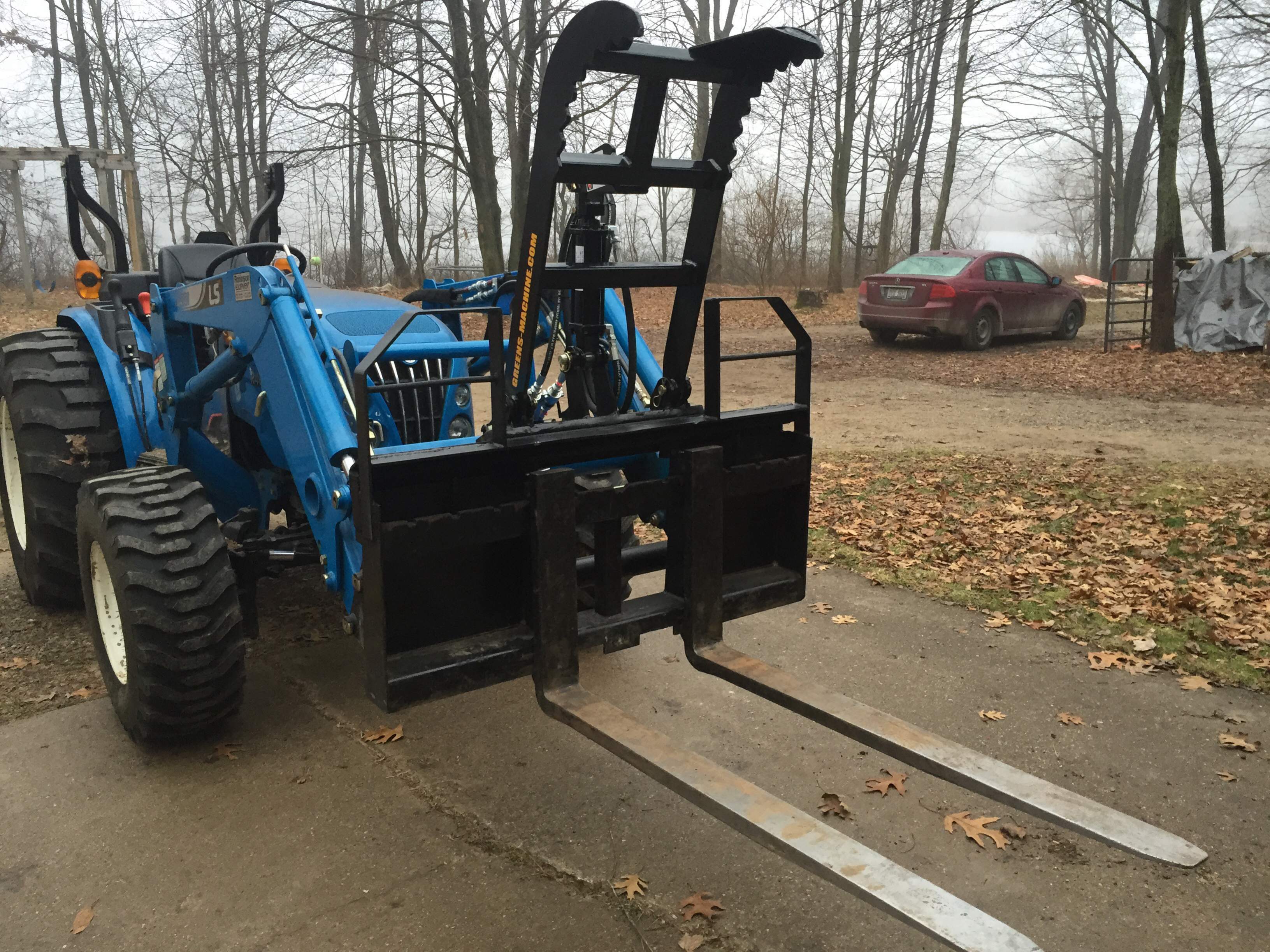

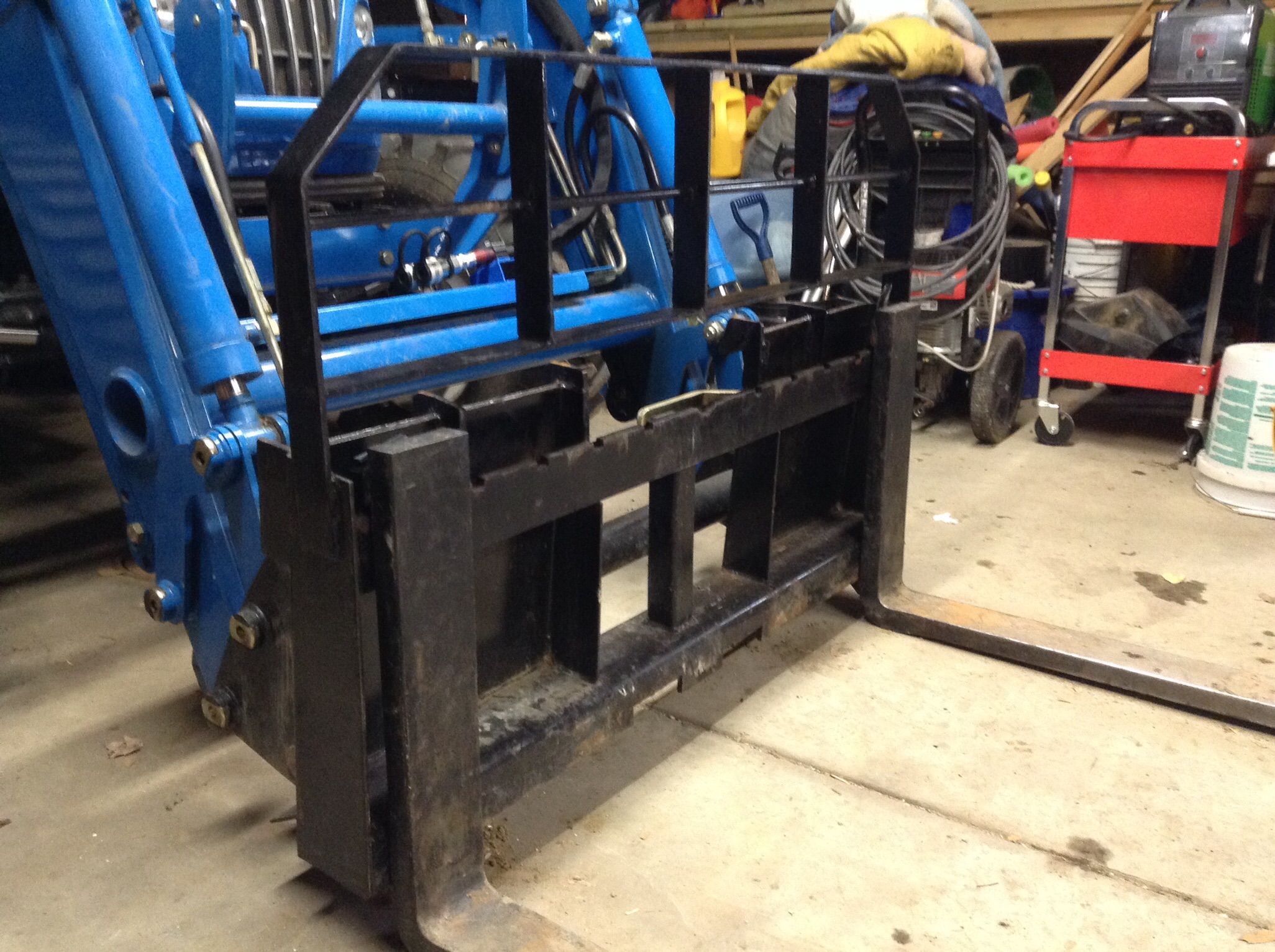

Here is a picture of the Titan Forks before and after I installed the Thumb.
I am very happy with the Titan Forks, I abused them pretty hard last summer digging out stumps and they didn't bend at all. The only thing I wish was different would be to have only one fork removal notch in the center of the bottom rail instead of the 2 notches on either side of the center. I like to push the forks close together for digging & grappling. :2cents:
