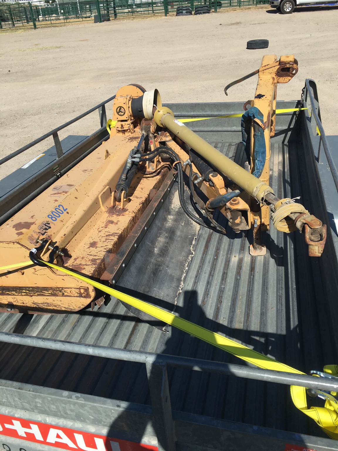

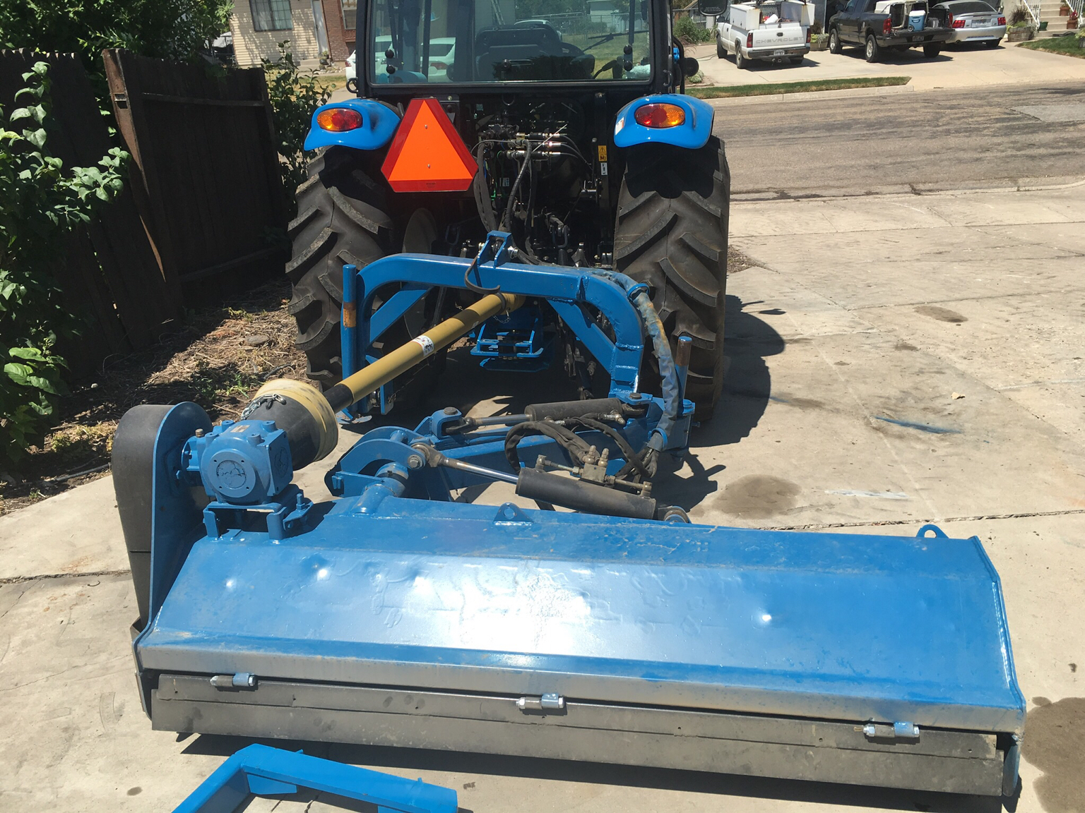

I used that same Majic paint and hardened to paint my old Berti flail mower. I couldn’t bear putting it on my brand new (at the time) LS. Sprayed with a 15 year old HF HVLP gun and it turned out well. Painted it on the 4th of July and let it sit for a week before using it. The mower is kept inside to help prevent dry rot on the hoses, so I don’t know how well it will resist fading.
Before.
After.

Nice work! Made a big difference in the look. There's just something about color matched implements.
