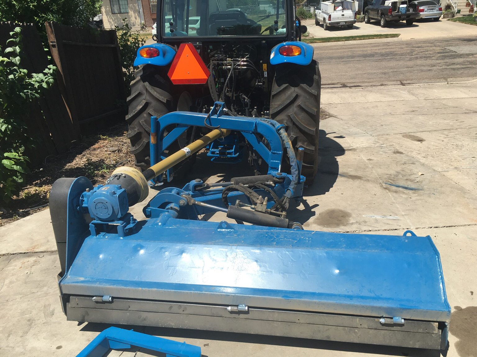

It was done w/ sprayer. Oil enamel, added hardener / glossifier. Used little under 2qts of paint. There was minor surface rust specs on both, and I figured I may as well match the color of the tractor if I was going to paint them.

Good job:thumbsup: What brand paint ,hardner, spray gun. What was your ratio .? How did the paint harden? I ve have been painting tractor projects and restoration stuff for years and I still suck at paint. Mainly use rustoleum with mixed results. Some get hard some you could scratch your name into it with your finger nail.:mad:The worst thing is they all seem to fade way to fast . I tried tsc implement paint and that came out the worst.Like to hear your formula.:drink:
   / Painting my implements to match tractor #14

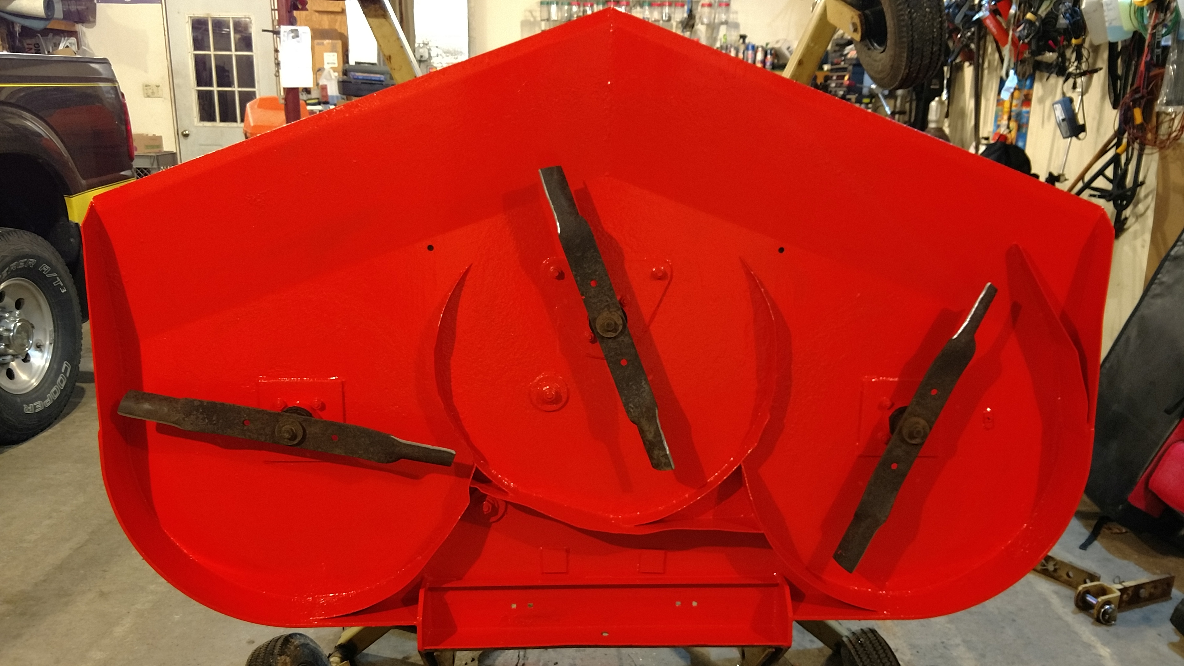

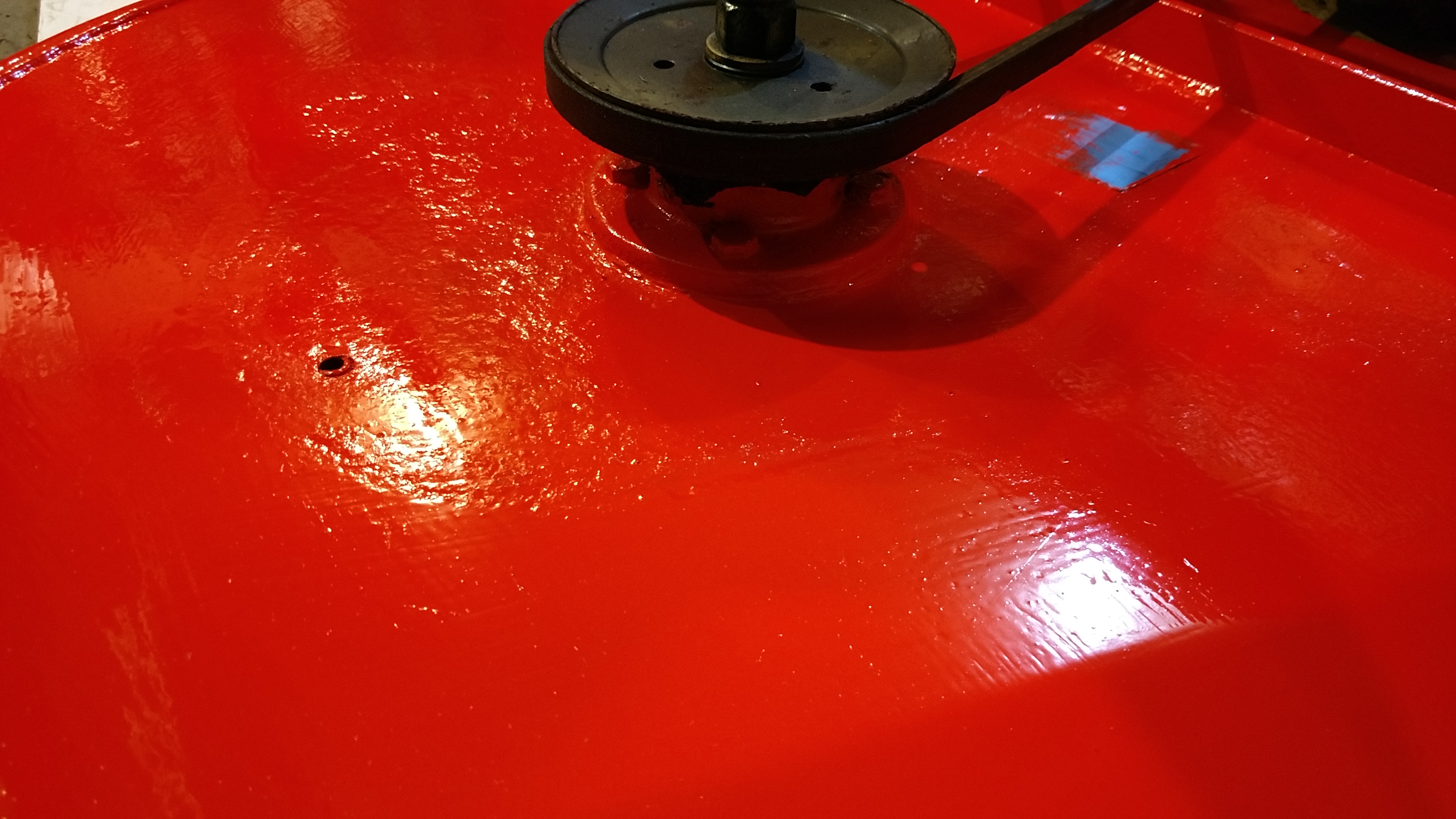

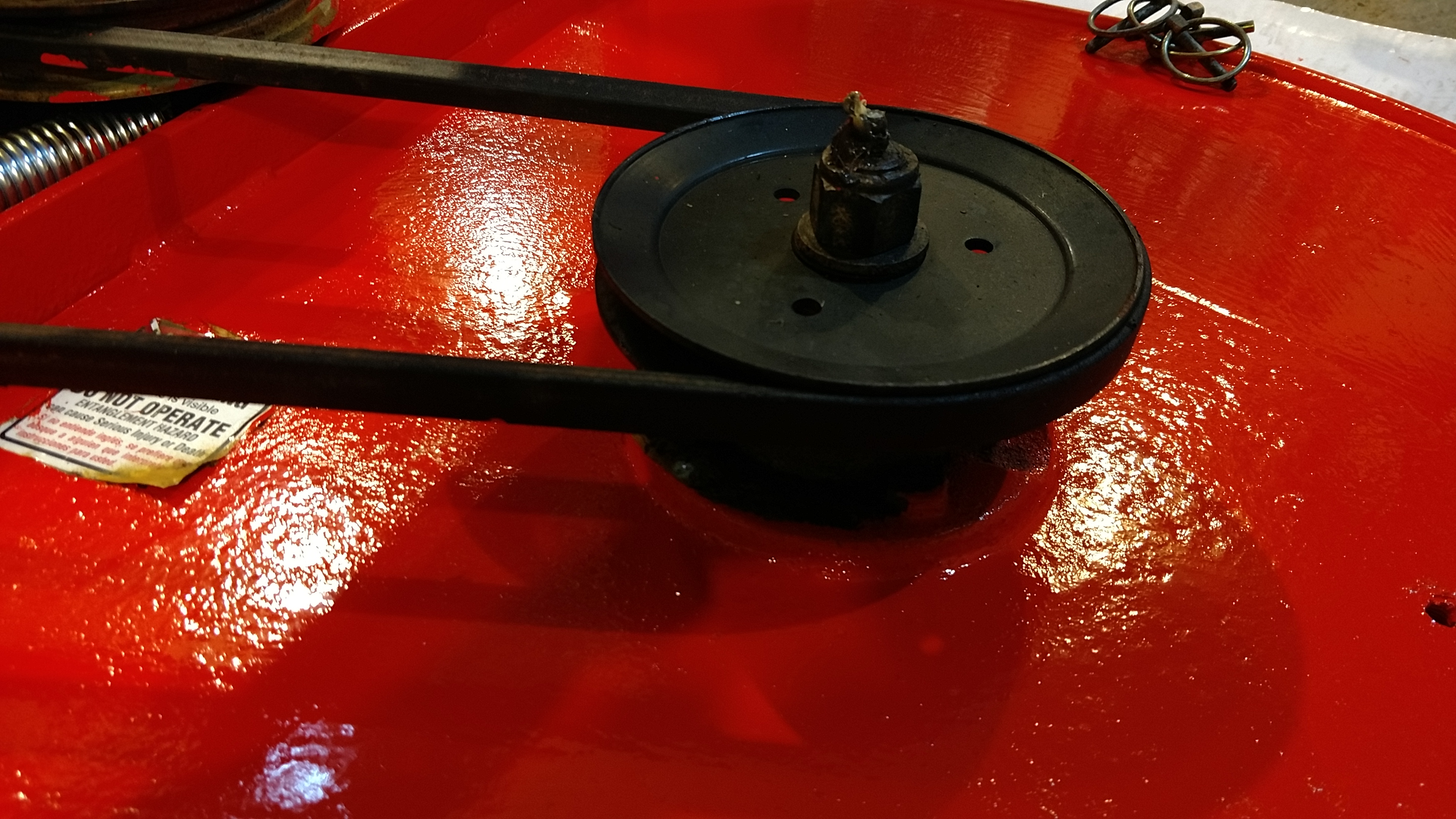

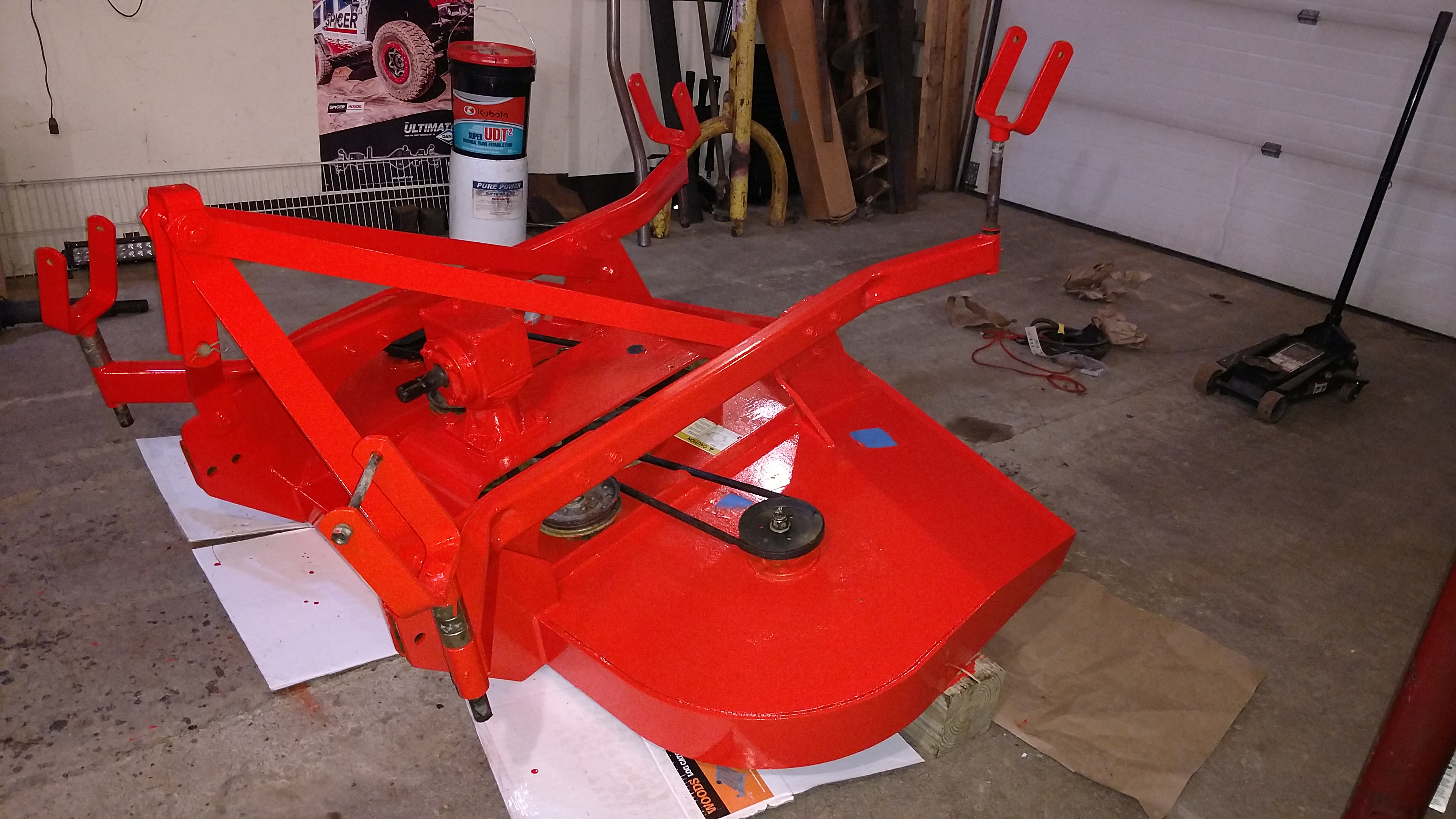

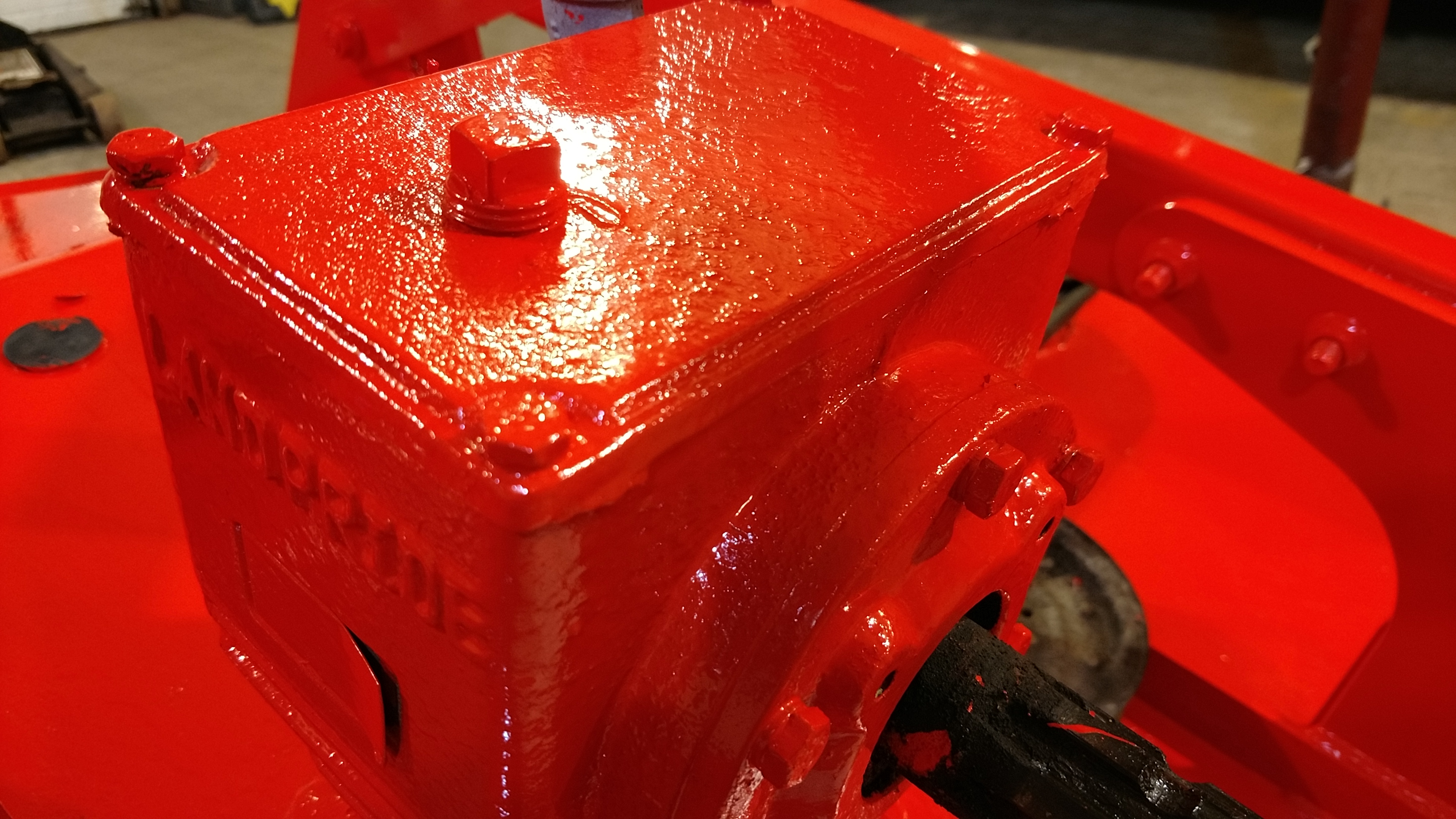

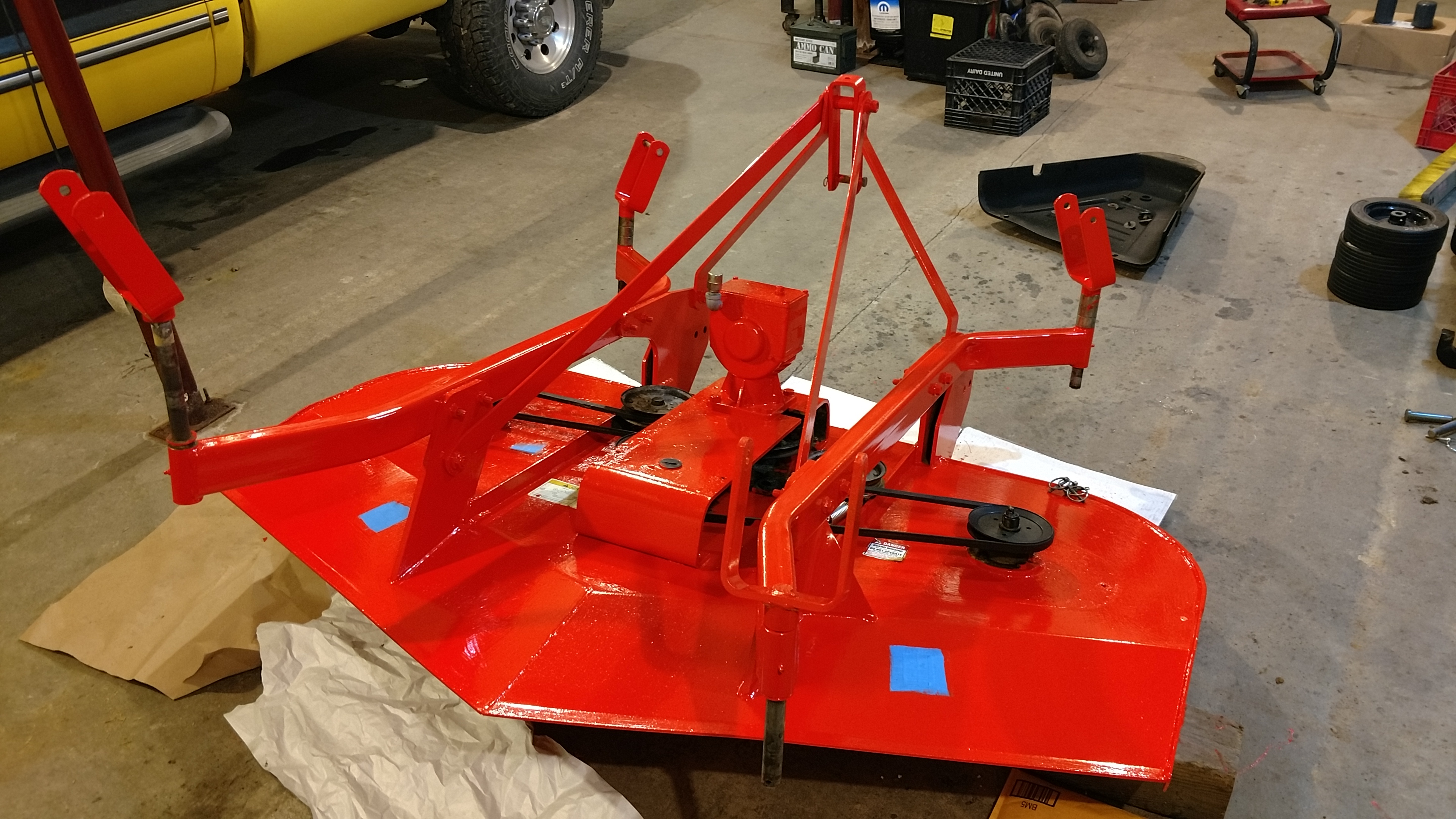

Similar drive as you, I bought older used equipment and want it all color matched to my machine. So I clean them up, wipe them down with denatured alcohol, wipe grease areas with acetone, and slather on Rust-Oleum with a brush. It leaves a little bit of lines in the areas that I flood to deep, but I am okay with that.
I also order the stickers for brands and models, I just paint around the safety ones since I don't care much about them.
I know that I do not get spray finish quality, but I am very happy with the finish I do get. I have painted a good deal with the Rust-Oleum gallons and it always impresses me with the thick paint and how it covers and then how is lays itself smooth over night. It does take a few days to dry, so I leave the item in the garage for a few days while I wait for it to get hard. I don't use hardeners or anything, I just open the can and start brushing. It is a very forgiving paint for not so clean surfaces or dirt. Just paint the light/fine dirt/oil right in to the finish!

   / Painting my implements to match tractor #15
@Rock Crawler
nice job on the underside, looks good.
