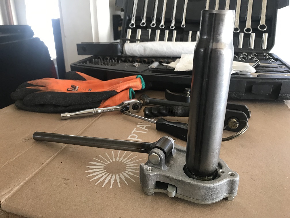

I broke the casting on the 3 point tilt adjust arm and bought a new one. It came in unpainted. Was planning to just wipe down with alcohol or so, then prime and paint with Rustoleum spray. But I'm wondering if the original was powder coated - it gets a fair amount of exposure and "abuse"...
Or am I making a mountain out of a mole hill?

I use rustoleum on implements and parts but I brush it on instead of spray. I think it lasts longer.

I would prime it. I heat it with a propane torch til it's nice and warm and spray it.

If the manufacture left oil on it, alcohol will not cut it. Use paint thinner, or better yet, a mixture of thinner and acetone. Just for cleaning parts I keep a bottle of that handy with a 30/70 mix of that. The paint thinner is the 70% part and I also wear gloves handling it.

Same here, but I usually use brake cleaner on a cotton rag to clean a part before painting (rattle can or brush). Paint will at least be able to be touched up. TS usually carries rattle cans with tractor paints that match pretty well.
I've also never knew that 3pt hitch equipment should be dry, so I liberally apply Fluid Film to the hitch components. So I wash and re-lube pretty regularly that that helps to keep the rust down and the paint on.

Thanks for the tips!

I like to warm up parts before painting like atsah. I found those 1500watt (give or take) heat guns would quite well for that and lots of other little jobs around the shop as well.

I find acetone works well for cleaning oily, greasy parts. It is carcinogenic - wear gloves.
