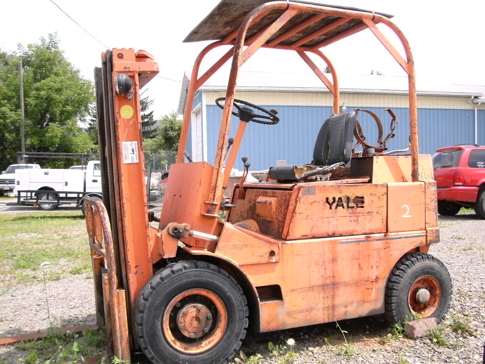

Thanks for the replys...I'll be spraying (Rust-oleum) with a HF HLVP gun, I might just get 2 quarts instead of a gallon which is probably an excessive amount for a 5k sized forklift. I wanted AC orange, nothing regionally in quarts or gallons, so Kubota orange it will be. Back around 1991 I sprayed TC 'tractor paint' with hardener on my IH330, must be that was the Valspar stuff? Still holding up very well all these years later.
