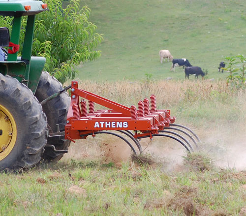

I need break up hard packed clay on my racetrack. I need to get down as far as I could. I have spots of fine sand that need to be mixed into the clay with my grader BUT first it needs to be broken up. What is my best 3ph option?

Without above answers I will tentatively suggest a Chisel Plow (Photo #1) or Chisel Plow's lighter duty clone called a Field Cultivator. (Photo #2)
These implements will go deep but not disrupt the surface too much.

I recommend a Chisel Plow. With your heavy tractor you should get down 10" the first pass, 14" the second pass OR DEEPER. These implements will go deep but not disrupt the surface of your track too much.
Chisel Plows are plains soil implements. There are likely Canadian producers.
LINKS: Athens Plow - Model 156 Chisel Plow

Chisel plows work great for fields and pastures that have suffered normal compaction. But you're talking about a race track that has been professionally compacted, and the dirt is going to be like concrete. You will likely break some shanks on a chisel plow trying to break it up.
Instead of a chisel plow, I'd look at a subsoiler. Something like this: Sub Soiler
Or this: V-Ripper Subsoiler | Northstar Attachments
I'm not sure you can get enough traction with your tractor to bust up the soil on that tract. The best solution may be to hire a dozer with a ripper on the back. That would do it.

Subsoilers and Chisel Plows are not too separated in function, perhaps overlap in some manufacture's descriptions. Both will get beneath track surface to disrupt deeper, per OP's desire and best pothole elimination practice. In either case, PARABOLIC shaped rippers decrease draft force resistance and strain on the shanks/rippers and would be essential were I making the choice, based on limited information we have. I am sticking with my Chisel Plow recommendation for the moment. I like spring-protected Chisel Plow's ability to reset/trip if encountering a finite hard area or boulder, over shear bolt protection on some subsoilers.
With either a Chisel Plow or Subsoiler the OP can vary the "bite" of the implement by adjusting the Three Point Hitch Top Link.
Chisel Plow will leave the track surface easy to smooth with the grader, while leaving some undisturbed, supportive subsurface after the first pass. Less labor intensive to smooth track surface with a grader, which the OP has, than using a jumping jack. Tractor has a loader if he needs to move material. I speculate OP grades entire track surface after each race.
Chisel Plow should speed rain absorption/drainage as sand and clay is amalgamated over time.
Clay absorbs a lot of sand and remains clay.
Most Chisel Plows are sized for a Category III Three Point Hitch, which I speculate matches the OP's 14,000 pound tractor. Various width Chisel Plows available, with varying census of shanks.

I would go ripper/subsoiler. Given the relatively finite width and distance, you don't need many shanks to do the job. A chisel plow will put a lot of stress on your 3pt given what you are trying to tear up. They are designed for field cultivation, not purposely compacted material.
You could probably purchase a single or double shank Cat 3 ripper and get everything loosened up quickly. Regardless, you are likely to also need a disc to break up the larger chunks which will invariably be brought up by the ripper or whatever implement you choose. The track will break along fault/stress lines through the compacted material and since you have compacted the entire track, as densely as possible, the chunks are likely to be large initially.
I would just get a Cat 3 subsoiler, 2 or 3 shank, just make sure they are heavy. The parabolic shape would be fine for your purposes although the curve causes more compaction along the shank midpoint in a field. Take a more shallow pass initially and see how it fractures as well as how your tractor pulls. Then alter as needed.
