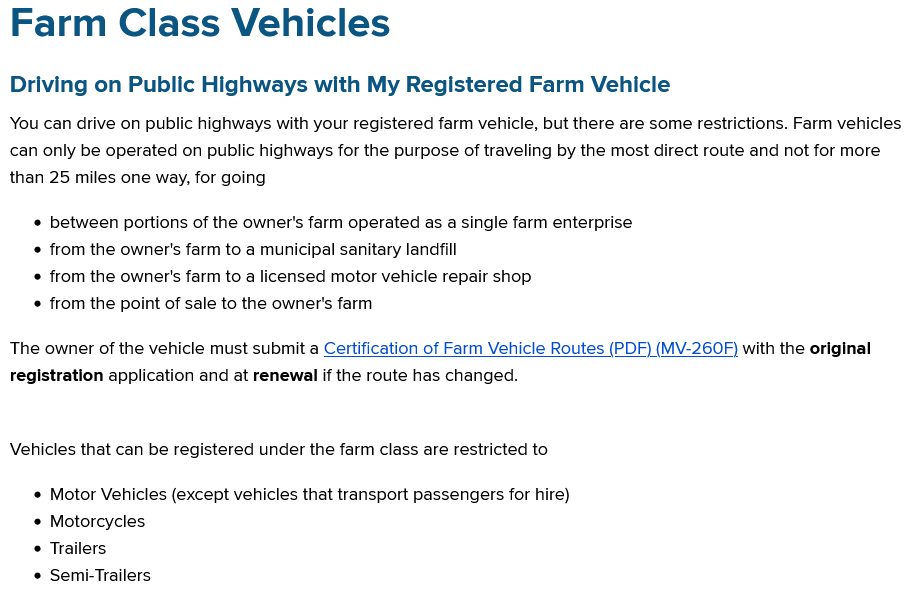

Around here the State DOT would be looking for your pickup and trailer, better have your CDL or be ready to spend a bunch of money fighting the tickets, after getting a CDL licensed driver to come get your trailer.

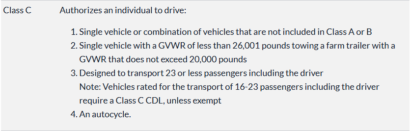

I am legal. Texas allows for hauling a 20,000# GVWR trailer with farm plates with a Class C license. All three of my 15,900# GVWR trailers have farm plates.
Classes of Driver Licenses | Department of Public Safety

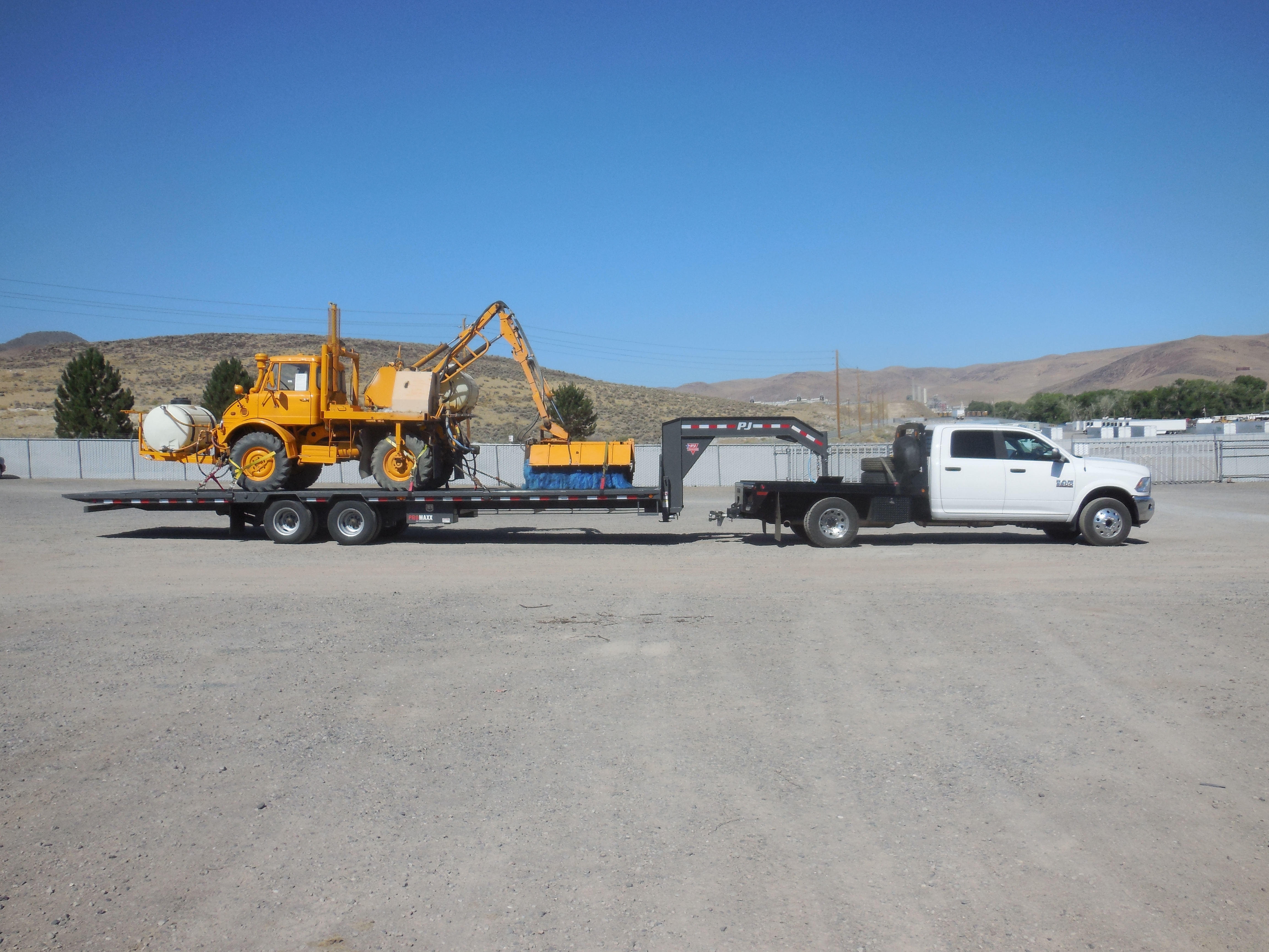

I'm fortunate that here a basic license allows me to max out my 3500 (14,000 GVWR) and trailer (25,000 GVWR).
Most of my trailering miles are out of state, went through three states to get the pictured machinery (about 16,000 lbs.) and I have yet to be hassled by any cops or scales. Not that I stop at them.
For the most part both the 3500 and trailer are overkill, but I much prefer it that way.

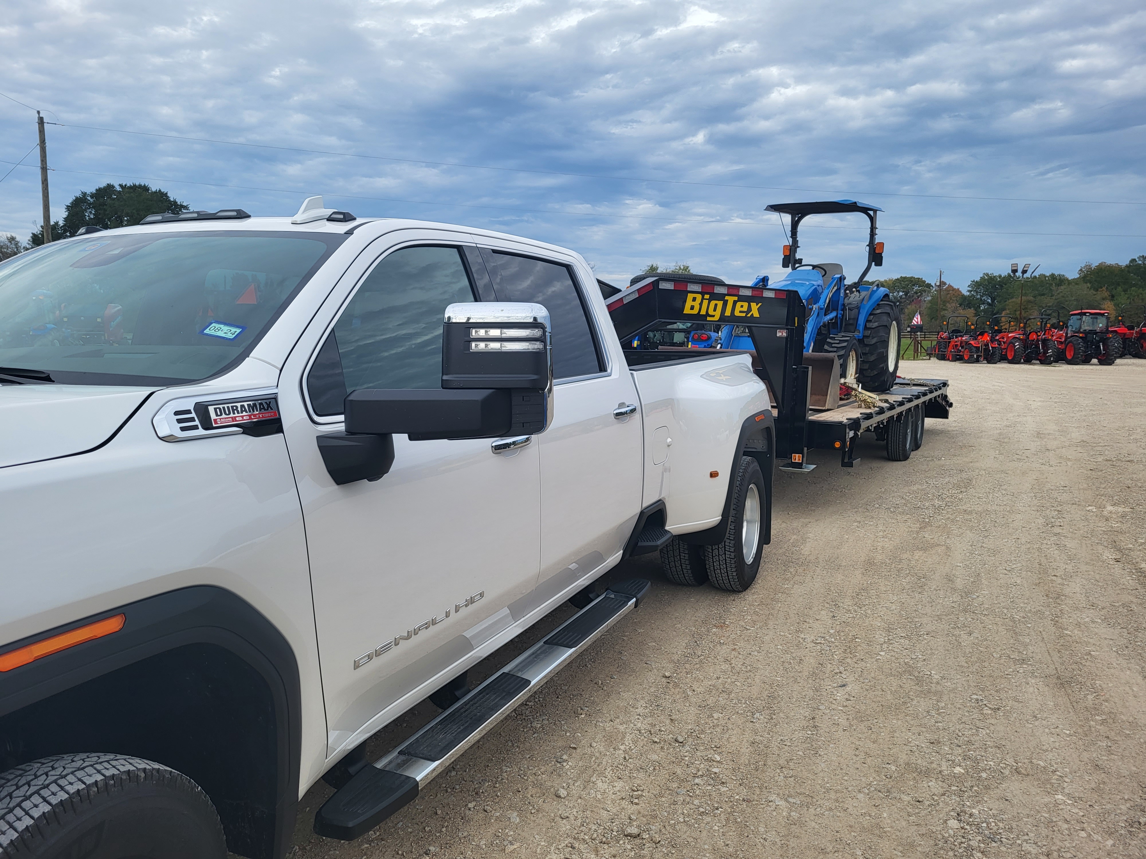

As you get older it gets easier to justify some purchases. I wanted to be self-sufficient in unloading square bales of hay, hard to find help to stack it in the barn. Tractor was too small for hay grapple, so got a bigger tractor (WM75). Trailer was too small now, so got bigger trailer (Big Tex 14N 20+5). Truck was too small, so got bigger truck (GMC 3500HD). Yes, it was expensive, truck and trailer were $100,000. Not only do I use them to haul tractors, but I use them for hauling hay and other things such as corral panels. I looked at it as a long-term investment. And we went to a Sundowner 3-horse bumper pull trailer so my wife can hook it up easier than the GN we had.
Dealer will transport the tractors, $150 one way. Mobile service tech is also available, extra $100 for a trip charge. While it didn't make good financial sense to buy a truck and trailer just for moving tractors, the other uses made good sense. I now have a 7-yard 14GX dump trailer for hauling mulch, fill dirt, and pallets of shavings. My 16' 70PI trailer is used to transporting lawn mowers and the Mule for repairs. After a while paying for delivery or moving of those things on a regular basis gets expensive.
Nice rig! A pleasure to tow with no doubt.
Most of my trailering miles are out of state, went through three states to get the pictured machinery (about 16,000 lbs.) and I have yet to be hassled by any cops or scales. Not that I stop at them.View attachment 978773
Nice equipment. What is that? A Unimog with some sort of bush scrubbing attachment?
   / Owning a new(er) tractor that's too heavy to haul with your pickup? #37
Yep, you got it.
I didn't even know there was such a thing as a tunnel washer until I ended up owning one (kind of a long story).
The original idea was to run the snowblower off of it since it has front and rear PTOs and hydraulics (and the 2,000:1 lower gearing), but once I figured the washer part out I wanted to put a flail mower on there instead of the brush.
Well, that would've likely worked well, but required a second person to operate.
Removed all the washer stuff (do you want it?), then ended up selling the Unimog.
That 32' trailer is for sale by the way. Bought a 35-footer, also with hydraulic dove tail, air suspension, and disc brakes.

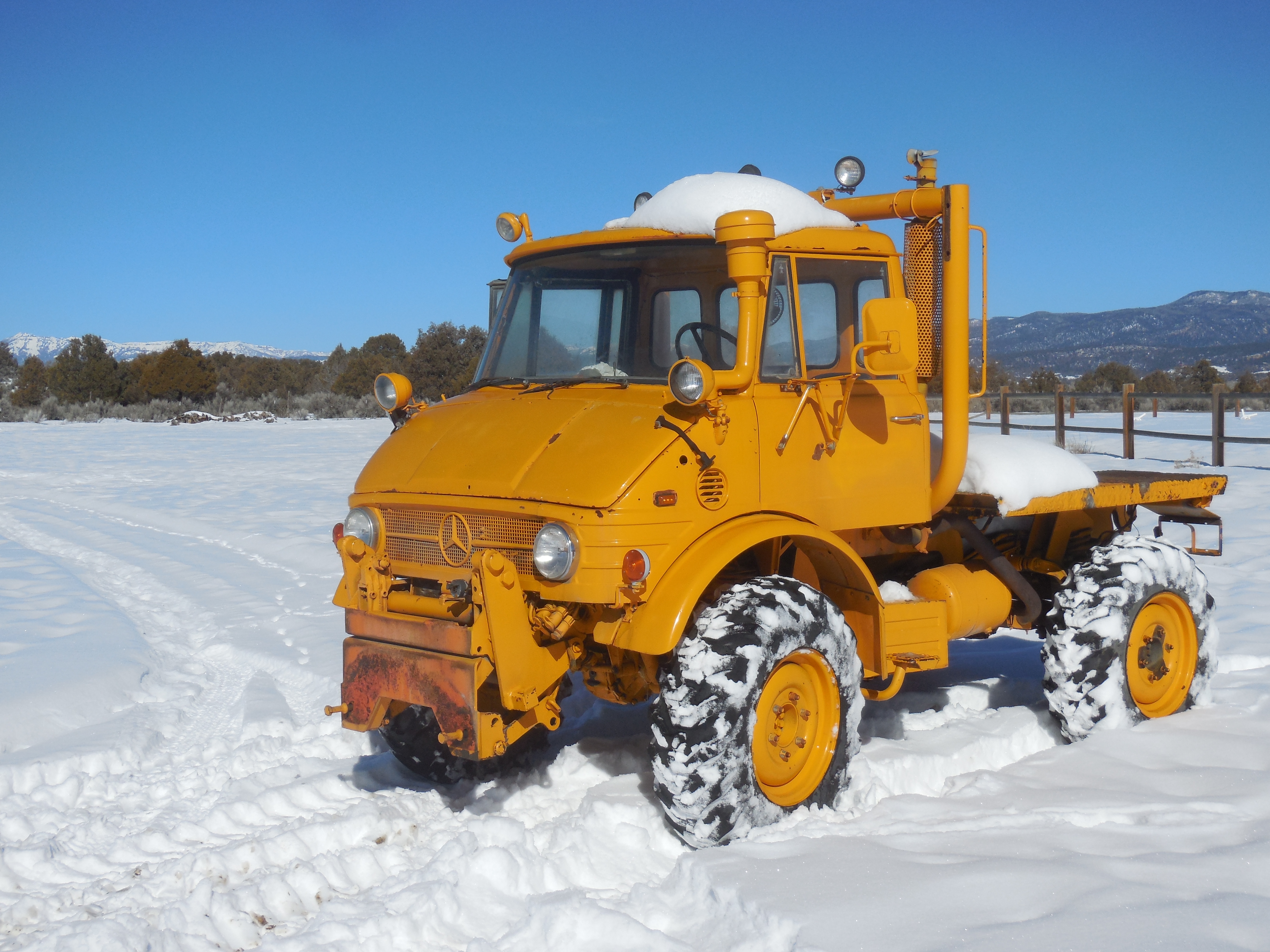

Yep, you got it.
That 32' trailer is for sale by the way. Bought a 35-footer, also with hydraulic dove tail, air suspension, and disc brakes. View attachment 978800View attachment 978801
It's a shame you couldn't make the mower work. That would have been a sight to see.
Oh, I probably could have, but it'd been a bit costly and work intensive.
As delivered, all the hydraulics are operated through switches and would've had to be converted to valves, so I could adjust at least the height of the mover with some precision. The ground next to my ditches isn't exactly smooth and consistent, and that's where it would've been useful.
Also, a hydraulic flail mower would've cost more than I paid for that Unimog.
