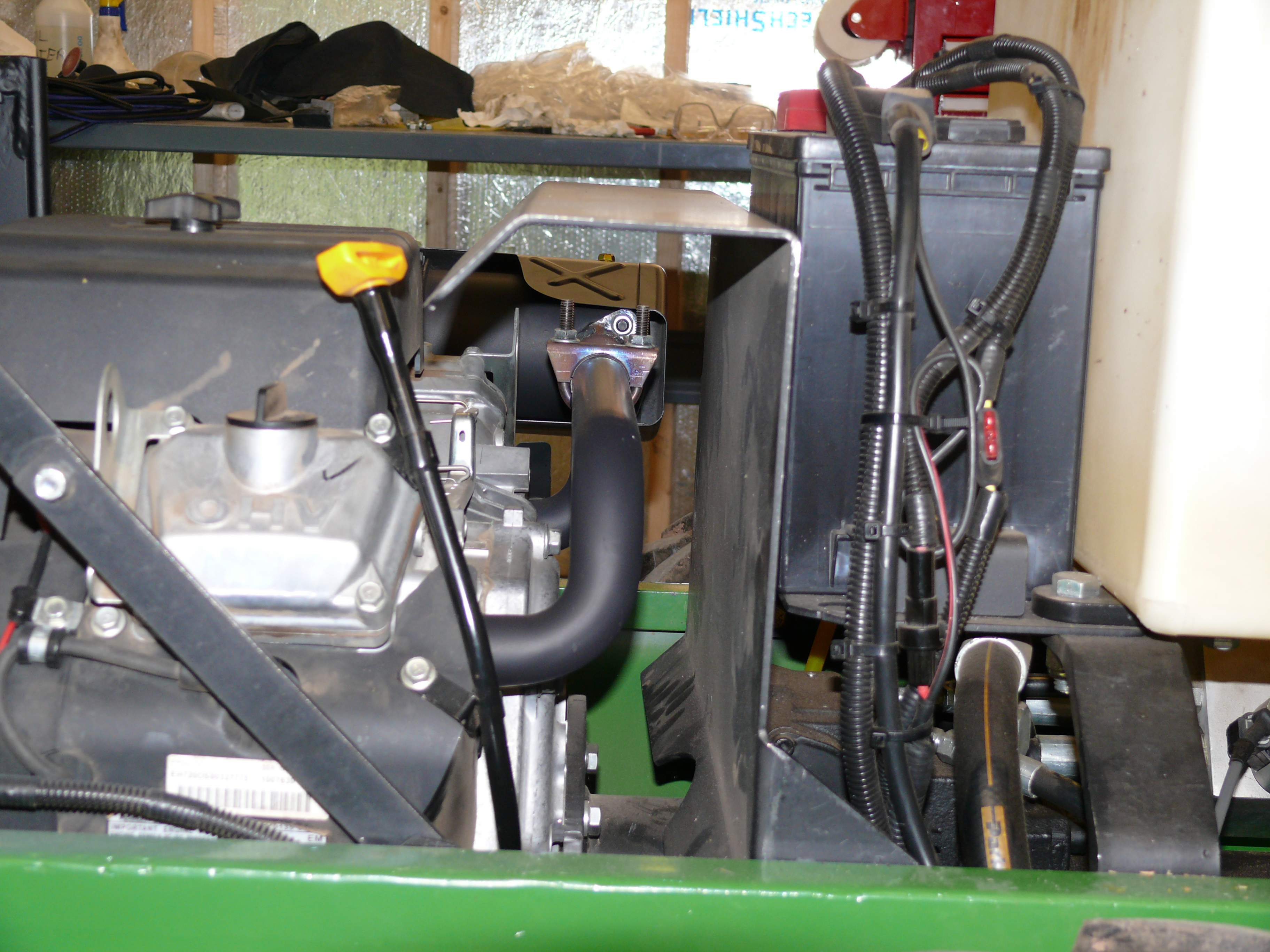

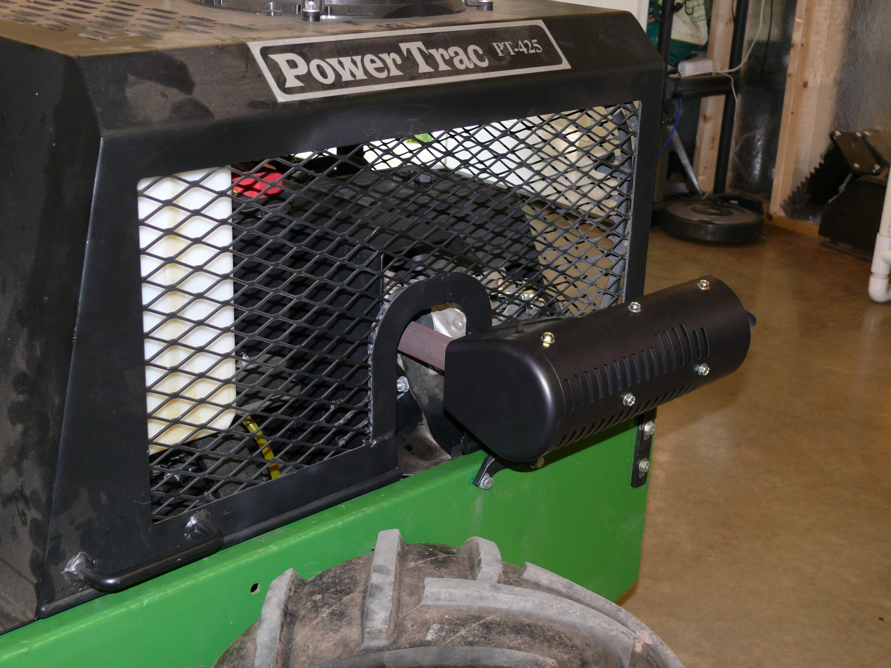

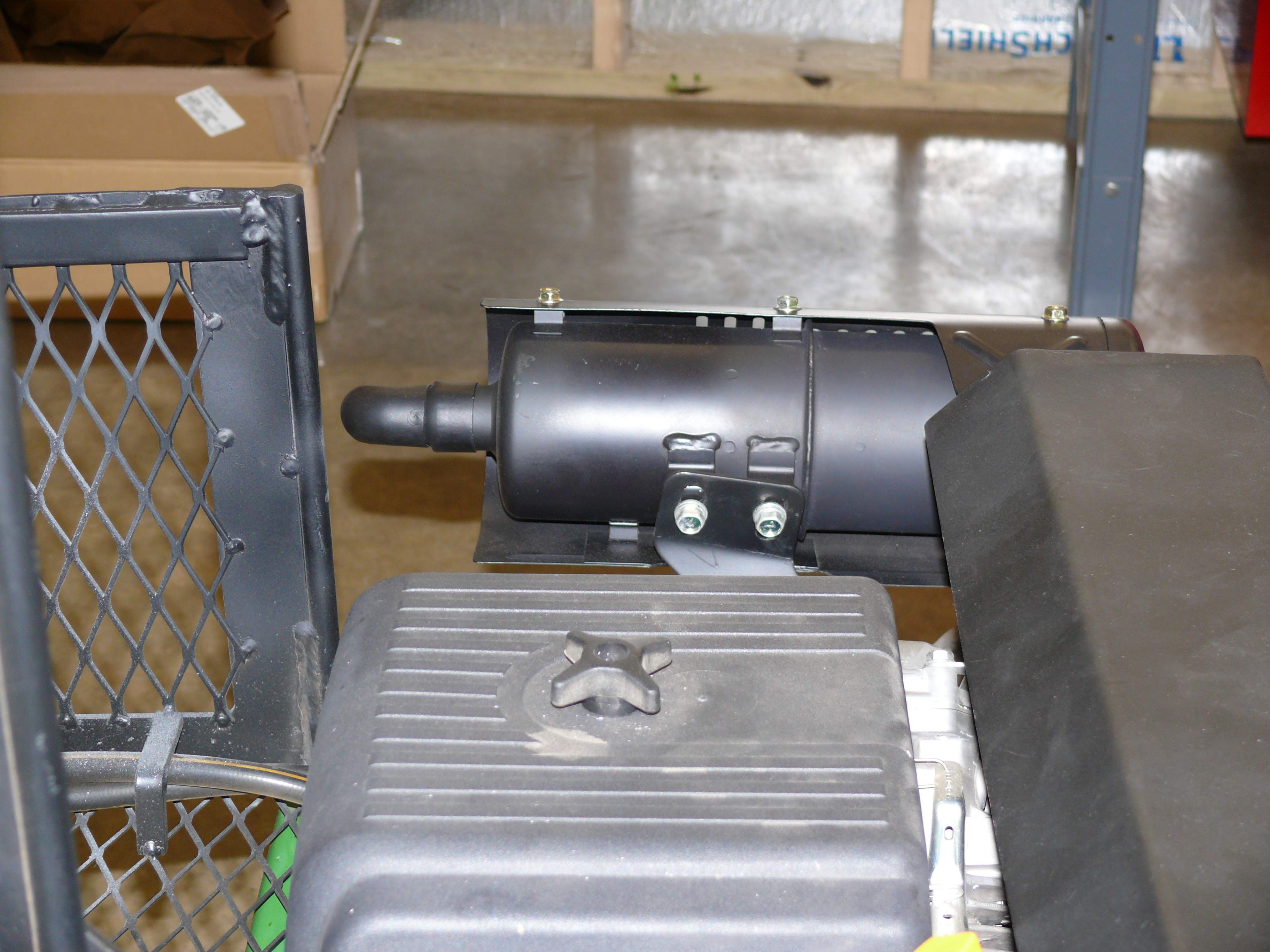

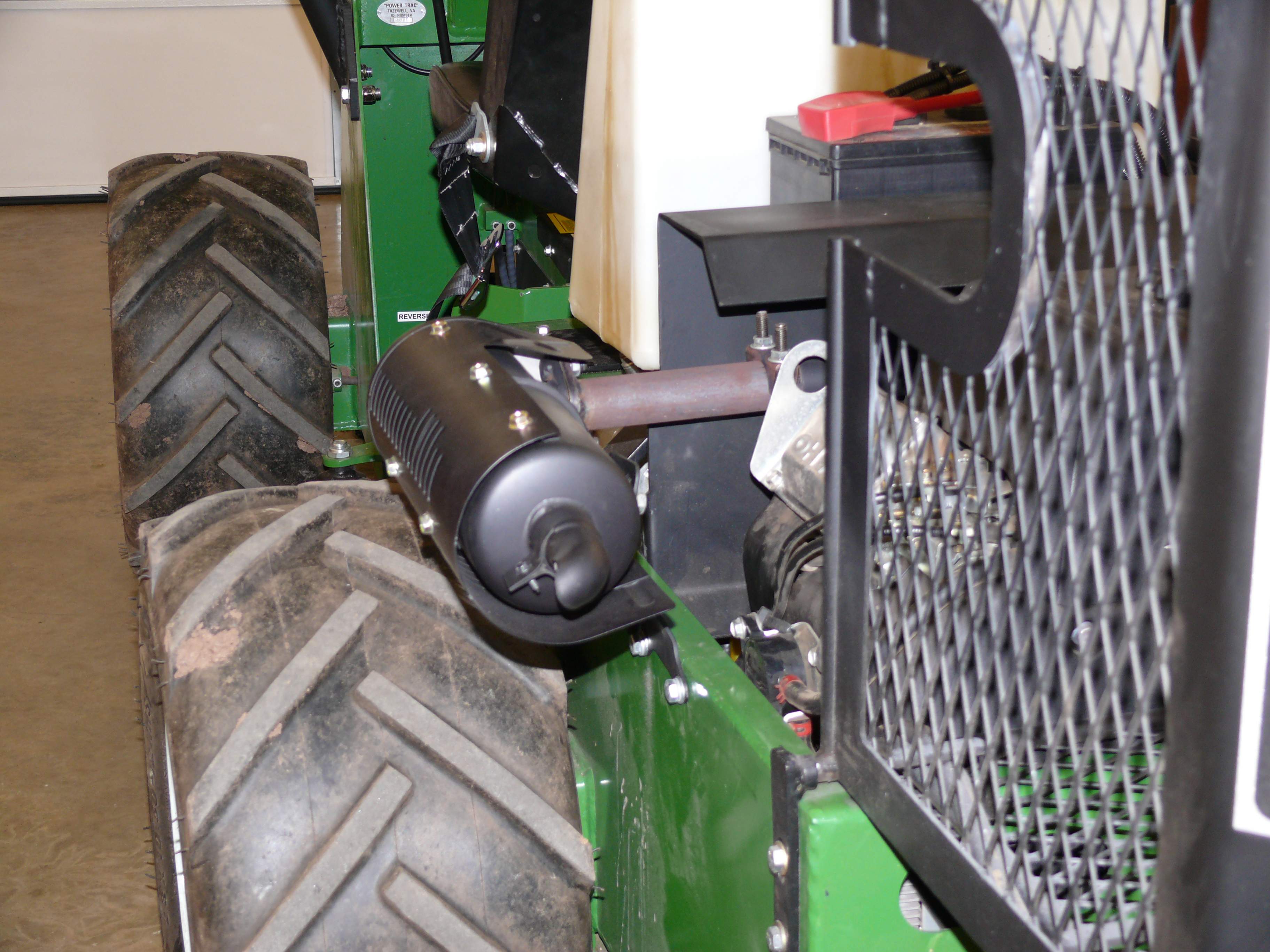

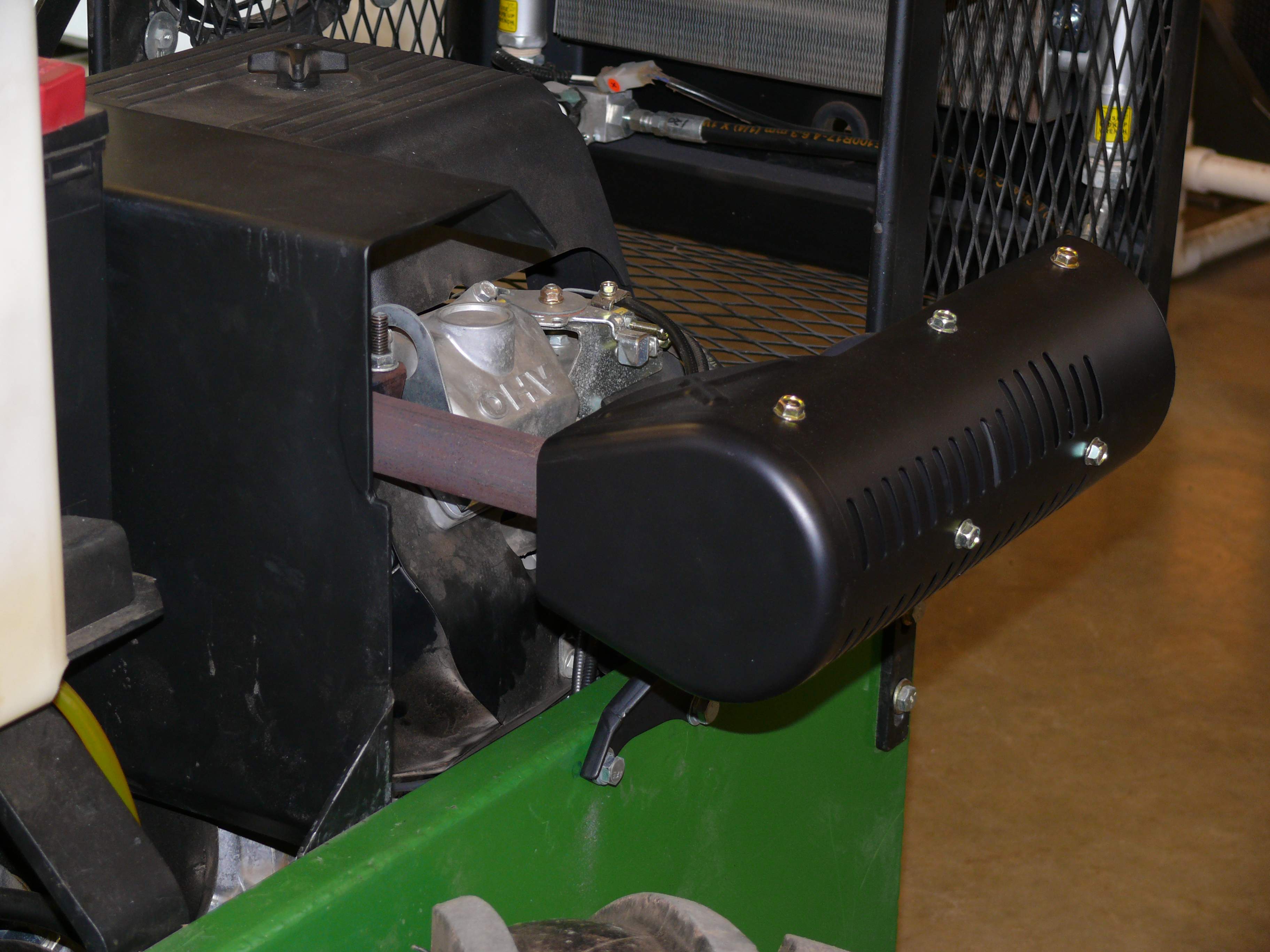

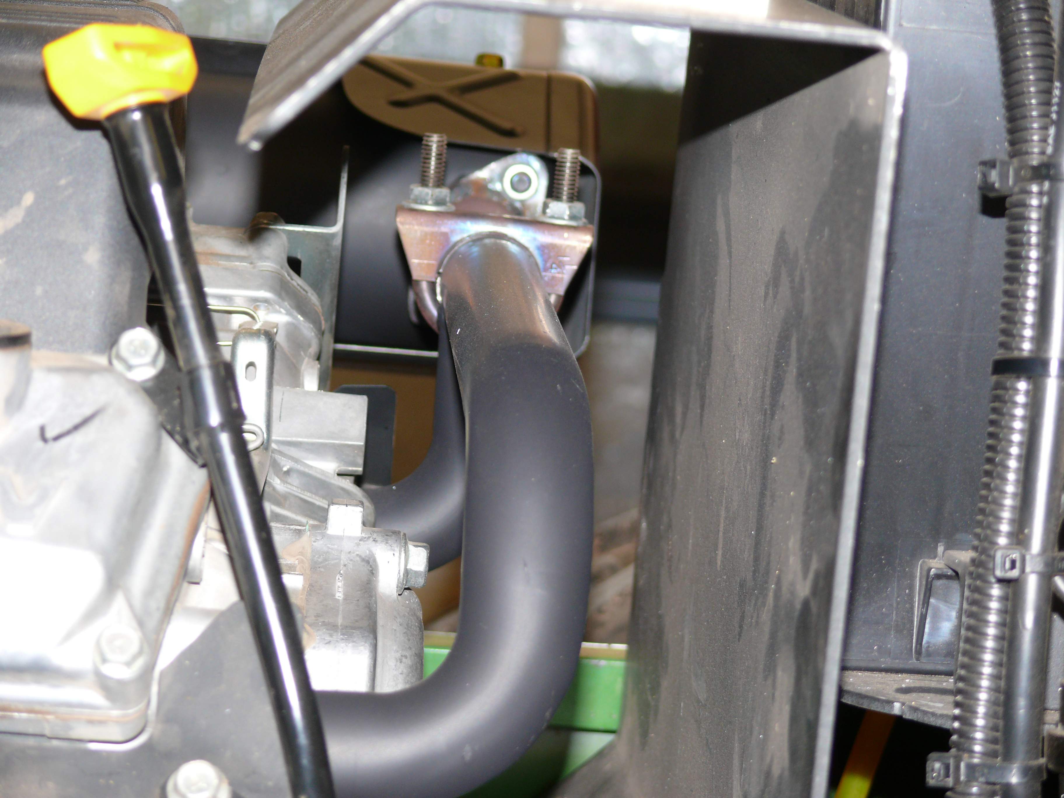

Changes to the Subaru Exhaust
Josh and a few others had been asking me what I had done to my Exhaust on my Subaru. At first I did the wrap on the stock exhaust, added the fan and all but I still felt that there could be more done to help it.
Below I have added a few pictures to show the changes with the Subaru header and muffler. Excuse the nasty welds, the hands aren't as steady as they used to be.

I like where you have it. Its far enough away from the hood to prevent from the heat radiating back into the engine. Its looks like the muffler is bolted very securely, and it seems like the muffler is out of the way from the tire enough. Its in a position that seems it would resist coming in contact with tree branches and stuff, too. I have to laugh every time I think about these Subaru header/muffler packages coming from Home Depot, of all places.

I'm going to add a bracket for the muffler, yet. Maybe the I'll bring the muffler in toward the hood about an inch more, too? We'll see how it goes after the bracket is made for the muffler.
