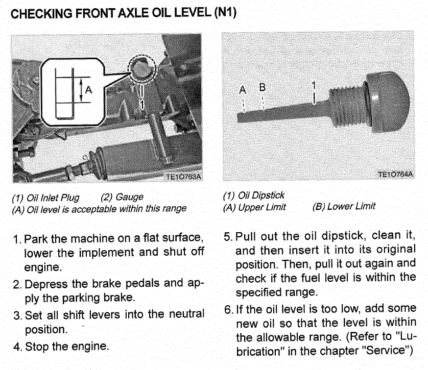

My front axle has a dipstick just like the hydro dipstick.:)
   / Overfilled with hydraulic oil - should I drain the excess? #12
That's good! Mine is a stubby tapered rectangle orange plastic half covered in factory paint horrible little thing :) The only way I can read it is to press it against paper or a rag and read the level as transferred. At least no harm in overfilling there - will just weep out :)
I would like it if it were same as HST one - that one is easy to read. Only issue there is the hole is small enough oil can kind of stay there from surface tension so when you pull it out it drags that out and reads like its way over full. Simply wiping & rechecking fixes that, but was :eek: first couple times.

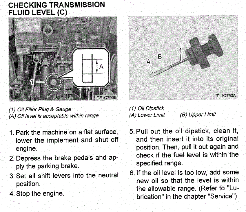

On the topic of Kioti axle and hydro dipsticks, what are y'all referring to when you say they are terrible?
I ask because my CK3510HST came new with just the barest bit of fluid evident on both of these dipsticks when checking fluid. My dealer indicated that was OK, but it seems weird to me. Is this part of the weird-ness that you are talking about? Just trying to learn my tractor... (and determine if I should top the fluid off).
Thanks!
   / Overfilled with hydraulic oil - should I drain the excess? #14
Yours are probably slightly different but there are min/max levels on the dipsticks & you should be within those ranges.
Not great pics but you can see how my F/A one is. What you can't tell from the b&w grainy pic is it is orange plastic & you can't really see clean oil on it. Also note how long the threaded area is - it's screw in to check. Compared to the hyd oil check - that's a nice dipstick that just pushes in w/o threads. And it's stainless steel and easy to see. Has notches for min/max vs scribed lines too. Just a huge difference in design between the two on same machine where one is good & the other is poor.
The engine oil is fine and typical of what one would expect for an engine oil dipstick.

Both of mine are nice metal dipsticks, but neither has scribed lines on it - just a flattened area in which the high level is implied by a change from flat to round, and a low level implied by the length of the dipstick. My fluid registers just a drop at the very bottom.
I'm currently struggling with the 50-hour change-or-not-change fluids quandary. I don't want to add more fluid just yet in either case. If I change only the filters then lower fluid means less pressure and less likelihood of fluid loss during the swap. If I change fluid then obviously I don't want to waste fluid topping it off. Everything is working well, but I want to sort it out in the next week or two before I start using the tractor.

Anyway, add to both so you're in the center of that flat. Won't take much for either
