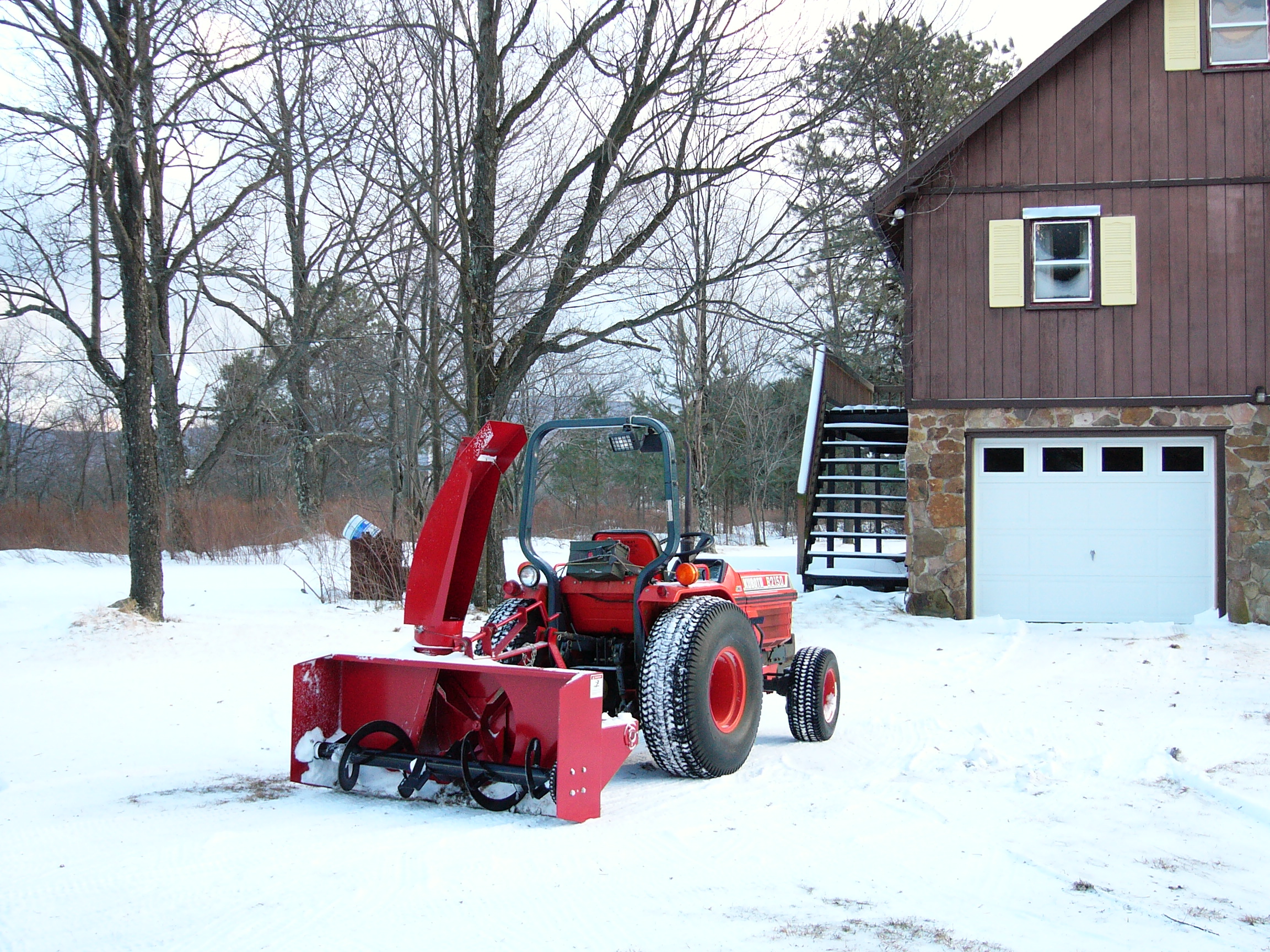

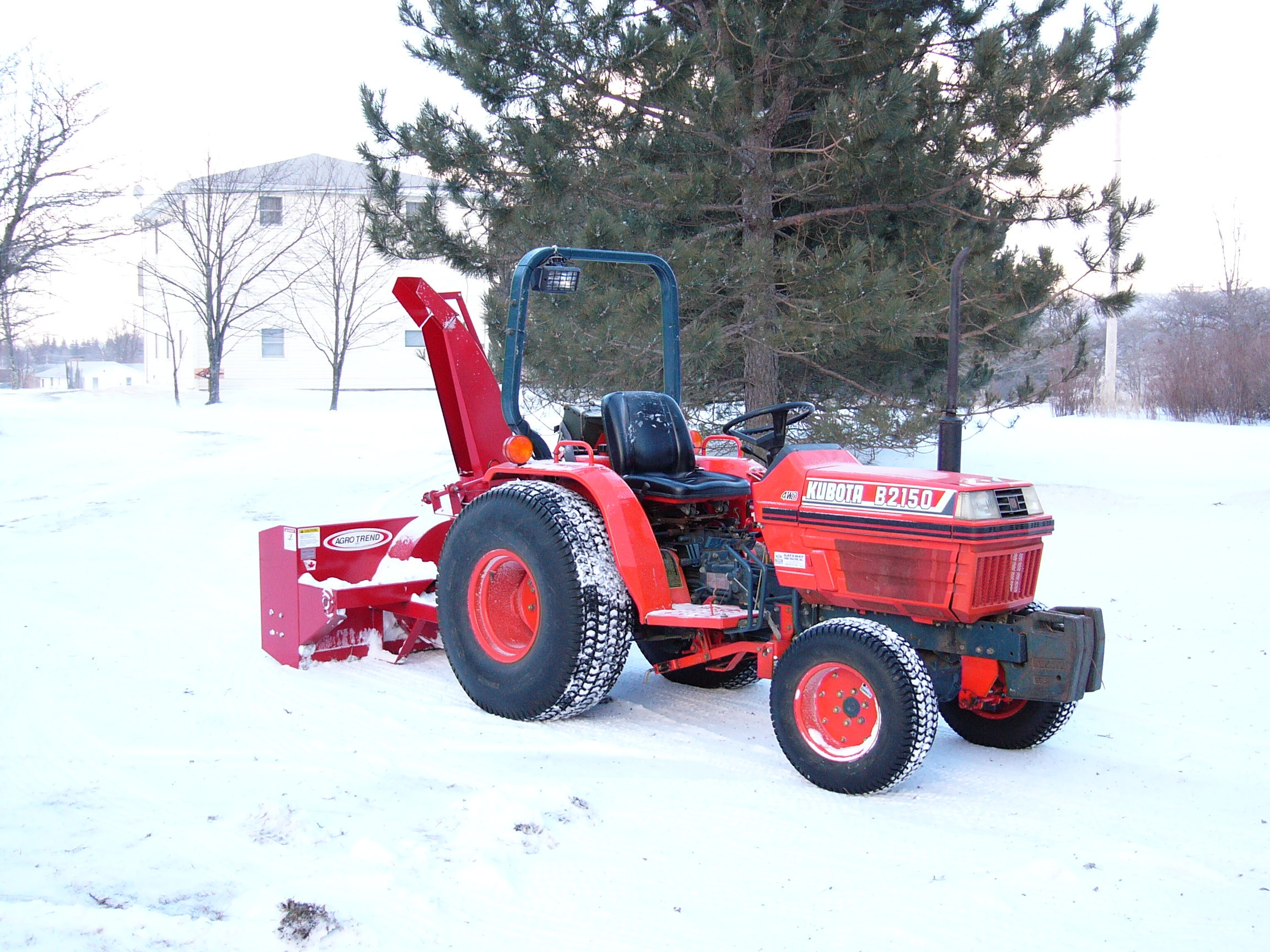

Nothing great about this, but here are 2 pics of the blower I use up in WV with an older B2150 Kubota. This is a 5ft Agro-Trend blower made in Canada. For some reason a lot of blowers are made up there. I got it new from a dealer in PA. Never a problem with it , but I sure recommend buying from a dealer close to you.
Note the fat turf tires on the B2150 which totally preclude chains on the rear. These pics are from 12 or 13 years ago. I have since swapped these tires out for R1 ag tread tires and found they are so much better in snow that I don't even need/want chains anymore. I'm sure my snow challenges are quite minor compared to Hailey Idaho (!) and your new machine should be a thing of beauty for that area. I see a foot or two most seasons and a few times 30 inches. Big problem back East is heavy wet snow at times and snow followed by rain and freezing. Only being up there (in WV) sporadically, I tend to face badly packed snow that has been on the ground a while.

genze -- I don't want to influence your buying but there is no magic in a Kubota brand snowblower. The paint will sure look nice all matching, but they are all made by someone else. There are many good brands of snowblowers on the market and a large variety of widths. You can get whatever you want in width. You said "Boy it sure doesn't give you very much extra room for that snowblower." Maybe it is just the frailty of our English language, (I'm often caught saying not exactly what I meant) but I'm wondering because of what you said -- you do realize the 3pt mounted snowblower is back behind your tires far enough that it is not restricted in any way in width by your tires ?
View attachment 503631 View attachment 503632
