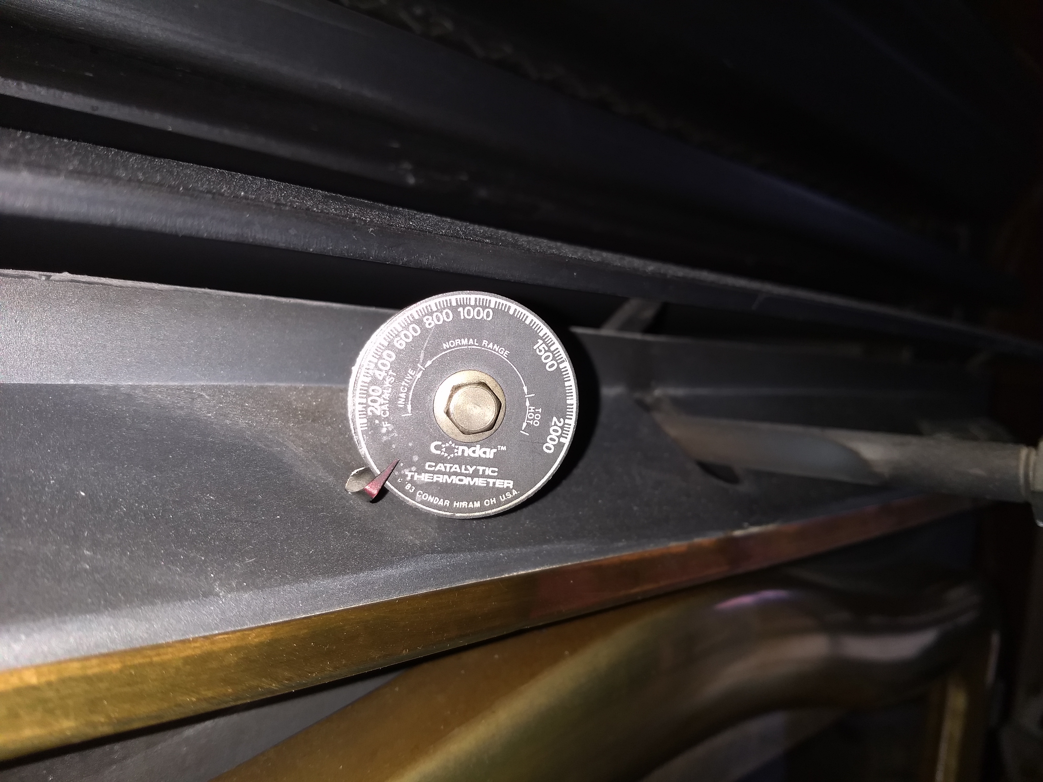

Ultrarunner your basicly running it in damper open mode until it reaches 550f flue temp? Wheres the themometer? 1800f running temp is to hot. **** i hardly ever see over 550f alone.
Stove pipe thermometers should be 1ft above the stove as per the two i own.

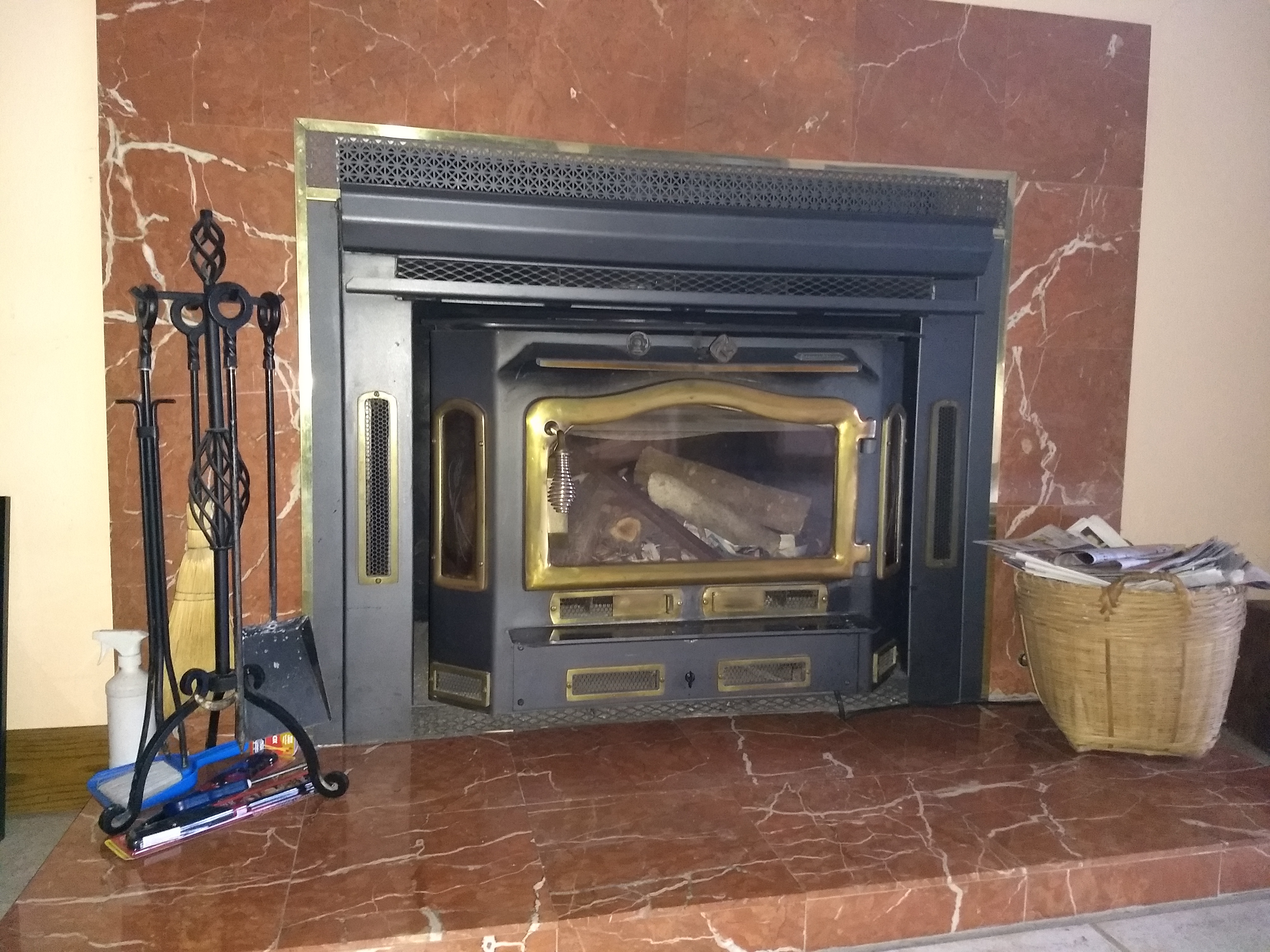

I don't want to damage the stove and am new to outside air and Catalytic Stoves...
The "Normal" operating range as indicated on the Thermometer is 525F to 1750F... so I'm thinking anywhere in normal is good?
Interesting. I think most of us are thinking of the temperature of the chimney pipe.
