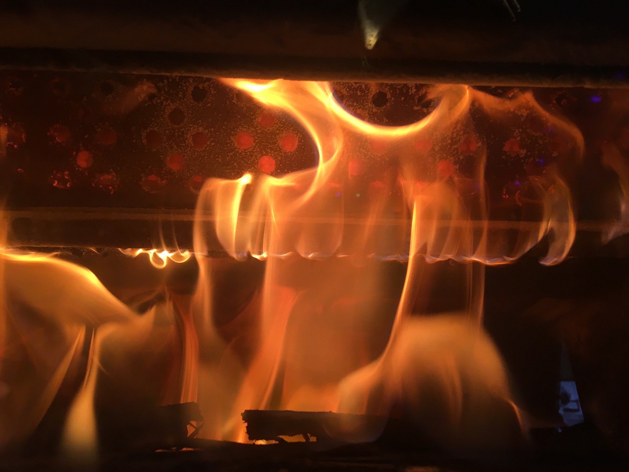

If you have the proper amount of air for proper combustion ( burns hot ) the glass stays clear. Insufficient combustion air and there is soot on the glass and creosote in the chimney. Too much air and the burn is cooler making soot on glass and creosote in the chimney.

On my CAT stove when the bypass is closed the flames and heat off of the fire get directed straight towards the door at the front of the stove and turn up through a baffle and reverse themselves and head back towards the flue stack. So that thermometer is in just about the hottest spot there is short of the fire itself. But it cannot be that much hotter than the flue gasses. I did not install my thermometer since it is a big ugly digital version. CAT stoves need to run HOT to be efficient. The trouble in that is they run you out of the house. Not that I want to, but my stove in moderate temperatures outside is running without the CAT being active. Or at least without it glowing (waffle looking glowing grid in attached picture behind baffle). Personally I would rather not have a CAT stove but you cannot legally install a regular stove where I live. The CAT is removeable and I do run it that way at times. It has secondary burn (gas burner looking tube in the picture below the glowing grid) so I think it would still qualify as an EPA stove. If smoke from the stack is any indication as long as I burn dry, dry wood and keep it hot you cannot tell I have a fire going CAT or no CAT operating. But I am sure the CAT does take out some nasty stuff.
