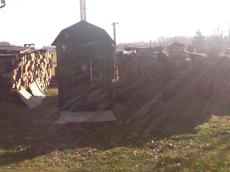

/ Outdoor Wood Burners #11
I love my central boiler
