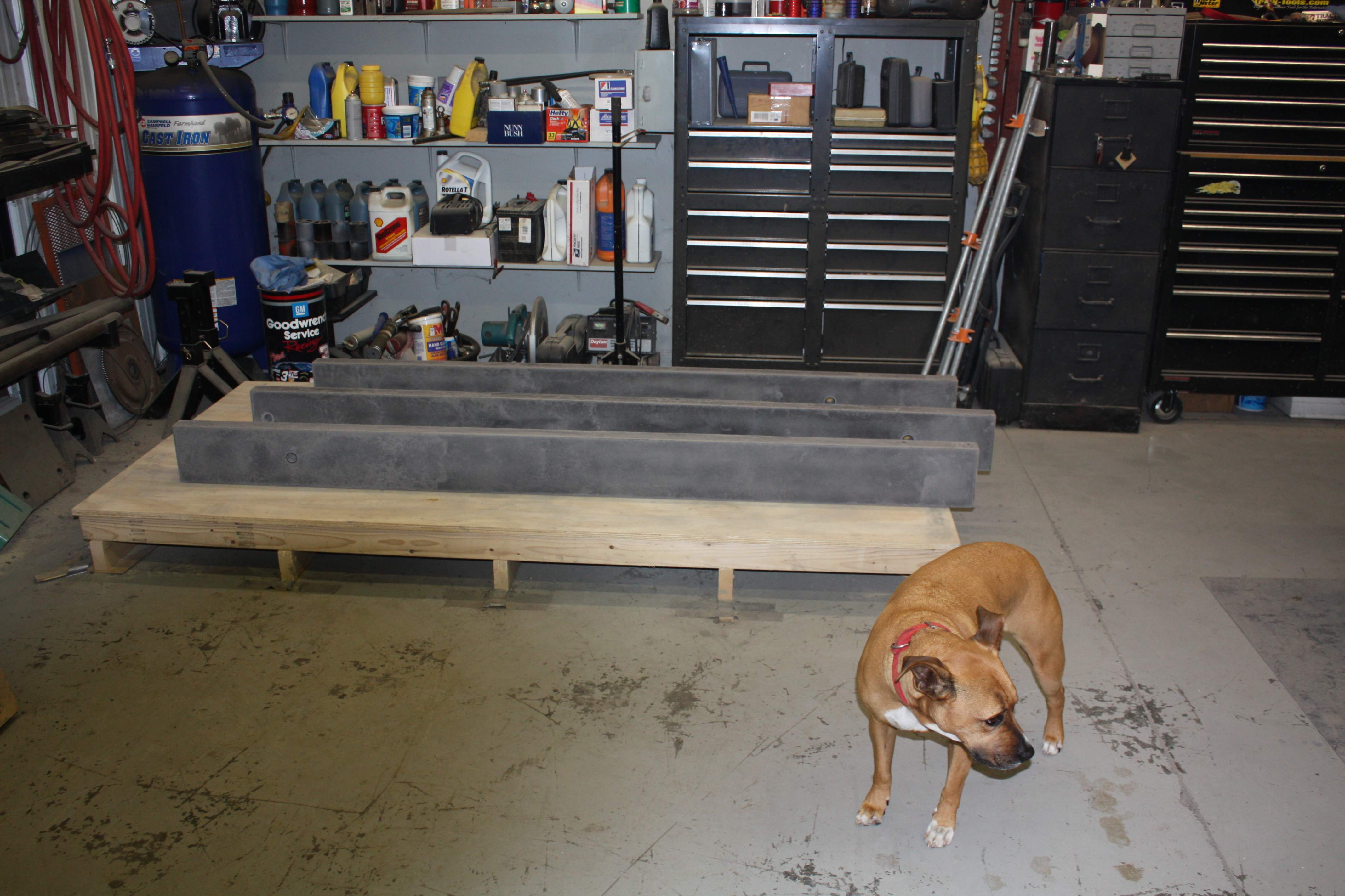

Got the last four molds made and siliconed, ran out of rebar, i'll have to get some tomorrow. The worse part of making the molds is taping for the silicone. Hopefully i'll get the last of the molds poured tomorrow, and start sanding on the other tops. I have seven bags of mix left, should be more than enough, including the slurry. Hopefully i'll get the tops done and sealed before the weather turns cold.

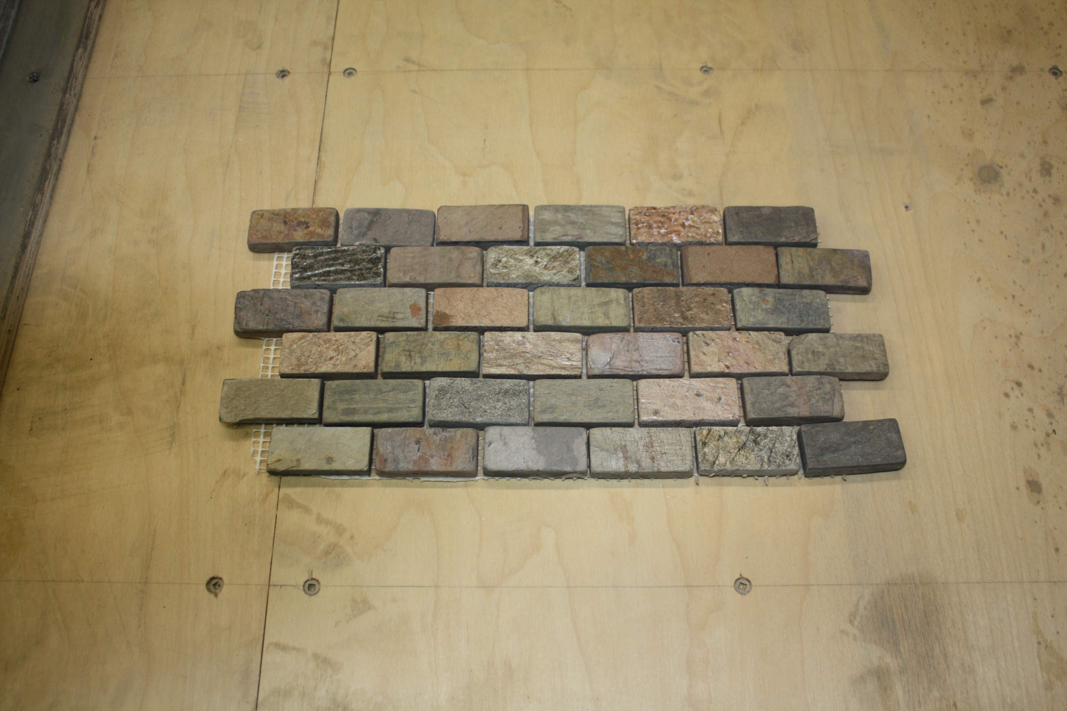

We picked out the tile for the backsplash. I've never laid tile before, should be interesting.

Got the last of the tops poured and covered up. No pics (figured everyone was tired of looking at concrete molds). It only took four bags, that leaves me with three and i think i'll only need part of one for the slurry. Didn't get a chance to do any sanding, it would have been a perfect day though.

Wet grinder will be here tuesday, if the weather cooperates i may get these wrapped-up next week (its raining here now). I'm racing winter to get these sealed. I de-molded the last of the tops tonight, tops look good, the sides still have the pin holes. The holes in these (tops of the backsplash) are for lights, i used 1 inch pvc and plan on just leaving it in, not sure if they would knock-out or not. I siliconed the pvc to the bottom (the top) of the melamine to hold them in place.
