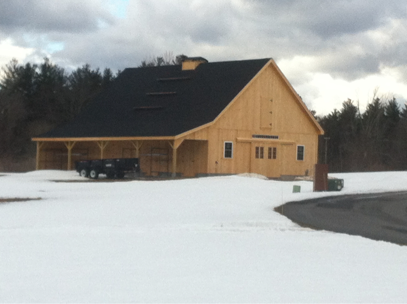

Thanks for the info so far,
Attached is the picture of the barn
As far as drainage, would a perimeter drain be sufficient or do you suggest drainage underneath the ring itself as well?
Thanks
Dave

First, nice looking barn.
second, under drains could end up being a pain in the horses rear. Erosion and sink holes pop to mind and one of my worst fears is having a horse drop a hoof into a hole. One of my friends bought a place that looked great. Come to find out, the previous owner buried all of the debris when they cleared. How did he find out, one of his daughters less expensive Hanoverian's found it.
