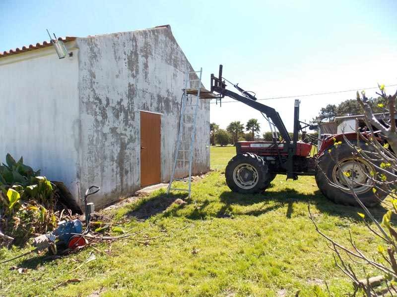

I don't have as much lift as you do; but it's all in one.
