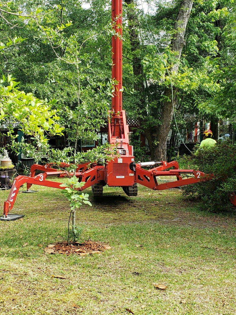

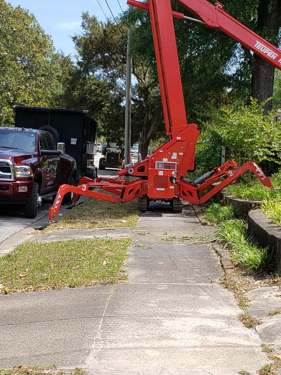

If you don't need the tractor for anything else, you might come out cheaper overall if you sell that lift and buy a spider lift. Self propelled on tracks and is great if you have uneven terrain.

Spider self propelled lifts can cost upwards of 80 to 100 grand.
View attachment 701635View attachment 701636
I dont really have any other legitimate uses for a tractor. Although my wife would say I've been making up some good rationalizations....
Would also have to buy a bigger truck and trailer. not a bad thought but where would I live. :_)
