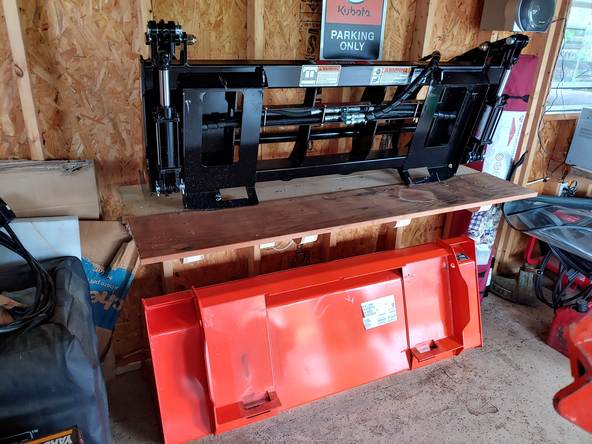

Here is where I keep my grapple and bucket when not needed.

I'm reserving comment until I see the supports. I think my grapple would collapse that, wall and all. o_O
   / Out of room for your attachments? Adding a shelf helps. #8
My grapple is 920 lbs, my bucket is 7 feet wide… the rear blade is 850 lbs….Do they come in concrete reinforced with steel :confused:
   / Out of room for your attachments? Adding a shelf helps. #9
OP's grapple is only a 55" or so and only weighs about 250lbs.
My EA 60" weighs 440lbs so it wouldn't require a lot of extra support. If you have a bigger grapple then yes, you would need some serious supports.

I would want a diagonal brace going down to the sill plate just to make it stronger. There will come a time when engaging or disengaging the grapple to the tractor doesn't go as planned and extra weight is applied to the shelf. It is nice to stack items to make more room though.
