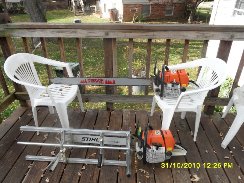

Be very careful that you get enough chain oil diispensed. Stihl has these highly engineered bars and chains which require less chain oil.
So on my 660's w/ a 28" Stihl bar and 28" stihl chain I get enough oil when it's cranked full. If I put on a non Stihl chain it's not enough.
attachment.php
Forget about it on the 42" bar, I hire a fuel truck to make deliveries.:)
