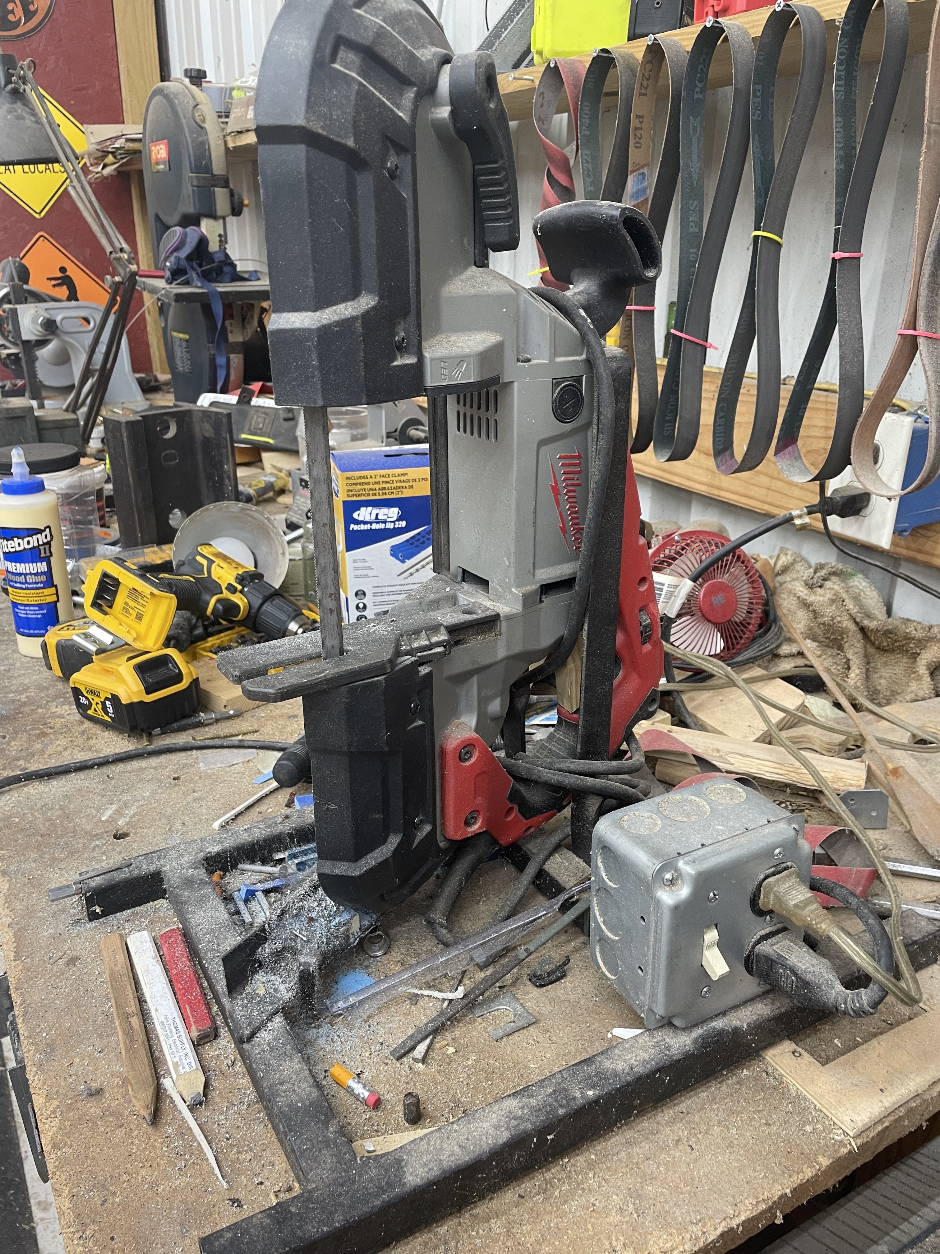

My bands are 18tpi. I have used them to cut metal, plastic, PVC, and just about everything else. Even wood occasionally. My saw is a corded Milwaukee deep cut that I picked up used a dozen years ago. It usually resides on a stand I made for it, but can go from stationary to portable in about five minutes: two screws at the top hold it in, unplug the cord from the switched outlet, and remove the wood block holding the throttle open. Good luck with your new purchase, I hope it serves you well.
