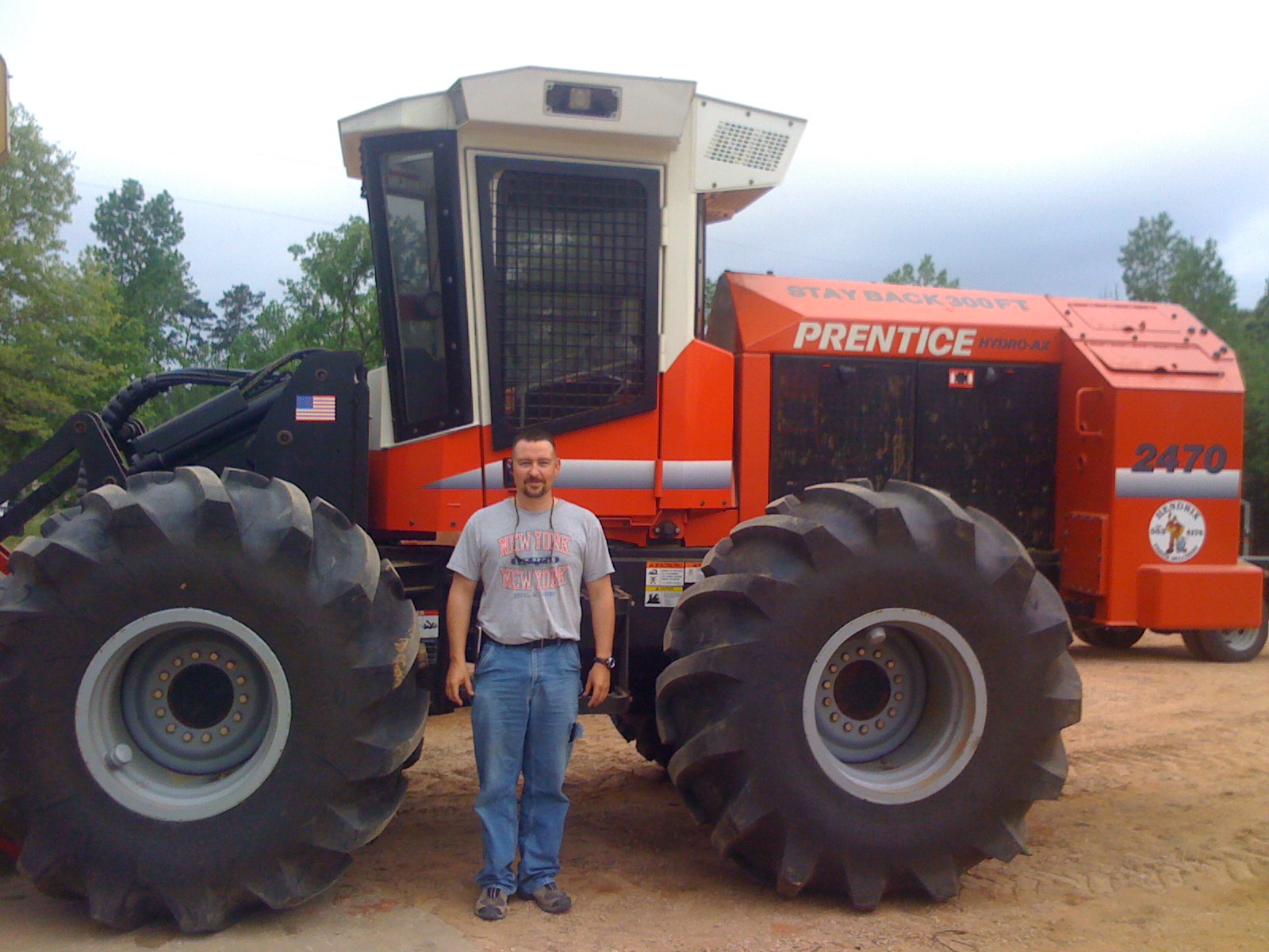

Possibly a long delay on the Prentice 2470! Because of things out of my control, it does not appear that we will be able to reach an agreement soon so I will probably have to change the head from the Fecon BH120 to an FAE head. Unfortunately there is not one in stock and it will be the end of June before a head comes in and then a couple of weeks to prep her out before she is ready to get to work. You can see a picture of the old girl and the ugly guy. I assume that they will sell the machine that was going to be mine and get me another one ready when the head comes in.
