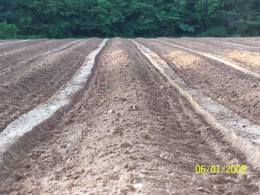

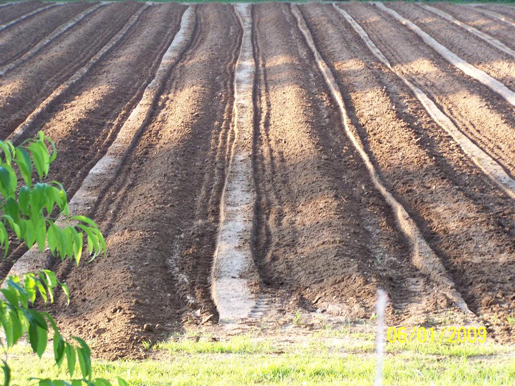

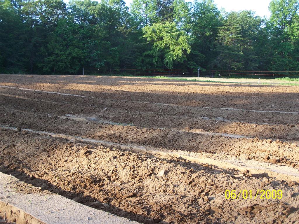

I have a KK tiller and plow & disc. I only plant 3-4 acres and don't use the tiller every year. 9 acres would take a long time to till but if thats is what you want then get what you want. My opinion is you can work faster with the plow and disc. This year I added weight to my disc and did not have to plow. Last year I plowed and disc most of the acreage and maybe tilled 1/2 acre and the year before I tilled the entire 3-4 acres to make sure the cover crop was tilled in good. One thing to consider is once a field has been worked a few years, depending on the soil, you may only need to run the disc over it a couple of times. As far as large clumps left by the disc, that depends on the soil and the moisture content when it is plowed and disc. Also if you do the wheat and barley is this for harvest or cover crop? Tiller is not much good tilling in tall cover crops since it will wrap around the tines.
Another thing I like about the disc is you can raise the front of the disc and make hills for planting potatoes, pumpkins, and other crops. Not as good as a hiller but works ok, see pictures. If it was me I would start with the plow and disc and add the tiller later.
Let us know what you decide, both will work.
