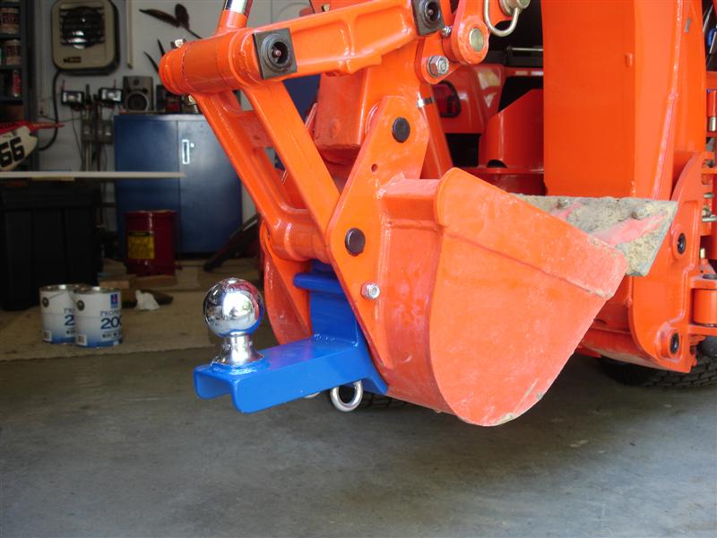

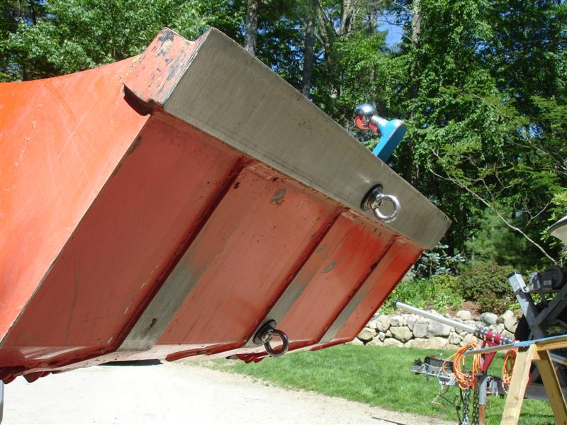

Thanks RMan, the blue tube thing is the strut for the BH thumb and stores there along with BH hitch - each with one wing nut. Also made a bucket hitch with two stainless eyes for lifting - see pics. The BH hitch is kept in place with a 7/16 bolt that replaces the keeper bolt for the bucket pin. Also made an insert for the BH bucket that leaves a nice flat bottom & pics up a bit more.
I love it. I am surprised I didnt see an earlier post in this? these are great ideas! I am surprised BXpanded didnt steal your ideas yet.
I really love the fabbed hitch and storage location. That sounds like something I really can use. Question is, how did you mange to bend that short of a thick peice of metal to fit contour of bucket?

RMan, the backer plate on the hitch could have been made out of thinner plate, but 1/2" was the only scrap I could find on hand - red hot with a torch and beat the snot out of it on the anvil - lit the cardboard template on fire a couple times in the process. The original piece was left long til the bend was correct, and then cut to length.
