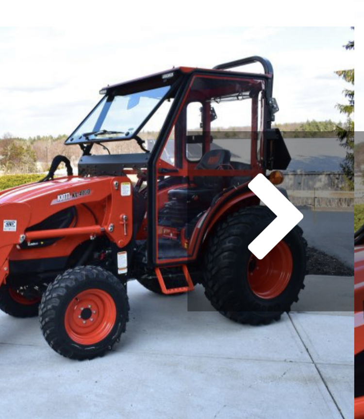

What about Curtis’ aftermarket cab for Kioti tractors. I was seriously considering buying one for my bobcat 2035, they are almost the same tractors aren’t they?
