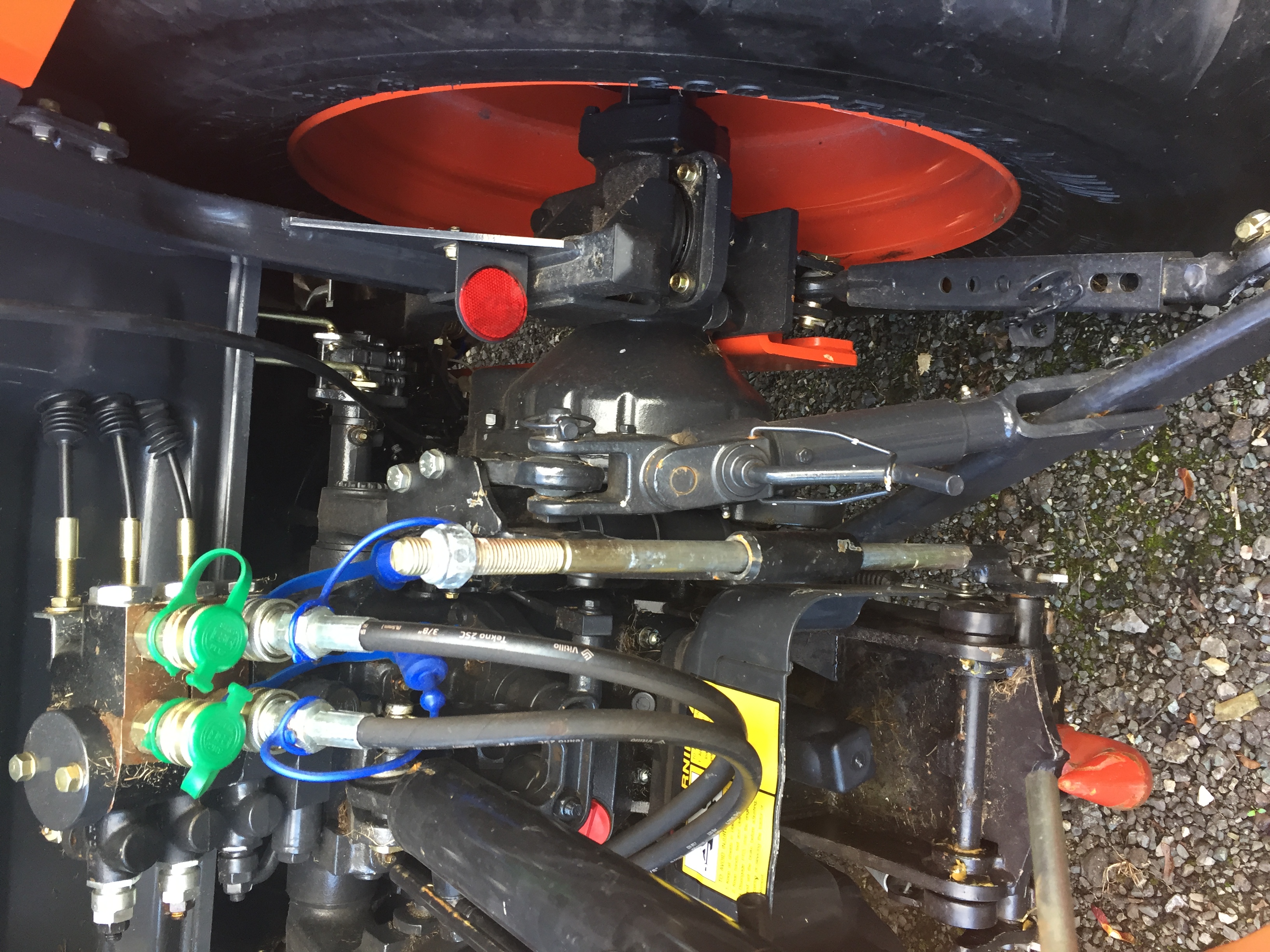

In that case, as a temporary fix, get some woven Kevlar sleeving for the two hoses, and run them along the inside of the loader bracket which extends right the way back to the rear axle. With some hefty zip ties you should be able to keep them out of harms way.

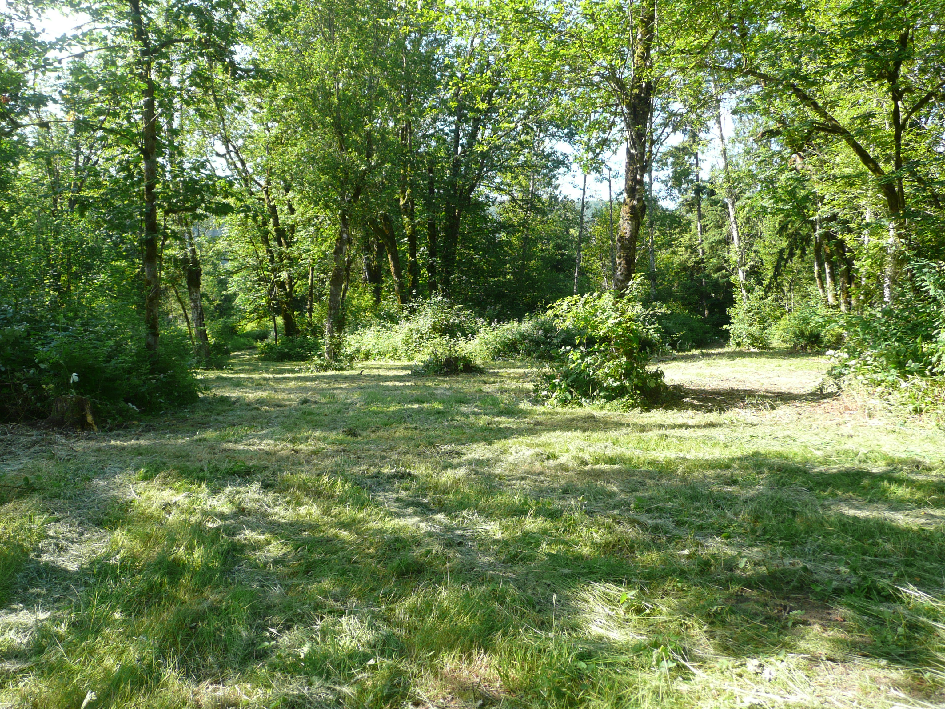

My place is pretty hard to describe, it's a mix of extremes. Here's a picture that shows a sample:
Seems that at every "turn" there are stumps and or logging debris, in addition to tons of blackberries and salmon berries. As a general rule I don't look to cut down trees. Also have ruts here and there, though I think that many of the really bad ones that are in my regularly used pathways have been taken care of.
I'm hoping to get some reasonably defined areas in which I can run goats to help clear. Longer-term is to bring in some cattle: whether this will ever materialize for/to me is the question, but it's my plan.

What you show looks lovely - and it's a nice part of the US.
I have friends who are just over the border between Abbotsford and Langley.
Been to Seattle on business a few times too - but not exactly up to where you are...
As far as it looks your ground doesn't look too bad at all. Plenty of space around things (in the main part)..

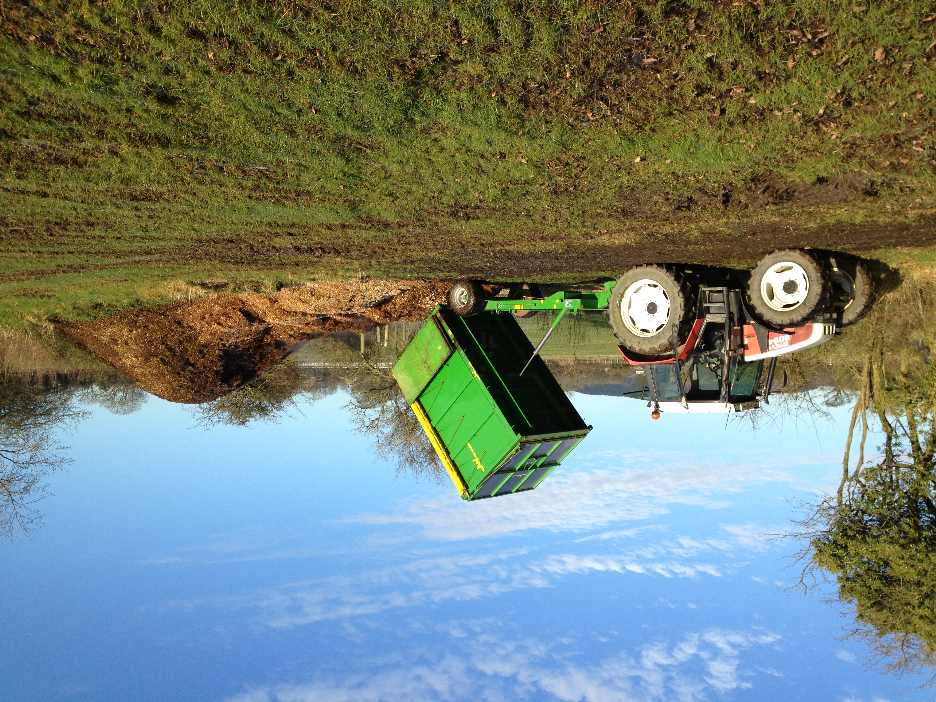

This is ours..
IMG_0744.JPG it doesn't show well that this is a 40degree slope!
Goats are good clearers - but do need to be well fenced in. Cattle a bit more destructive - and will churn the ground - but good to get it sorted at the start..
Like sheep, though - they are all just Houdini in costume..

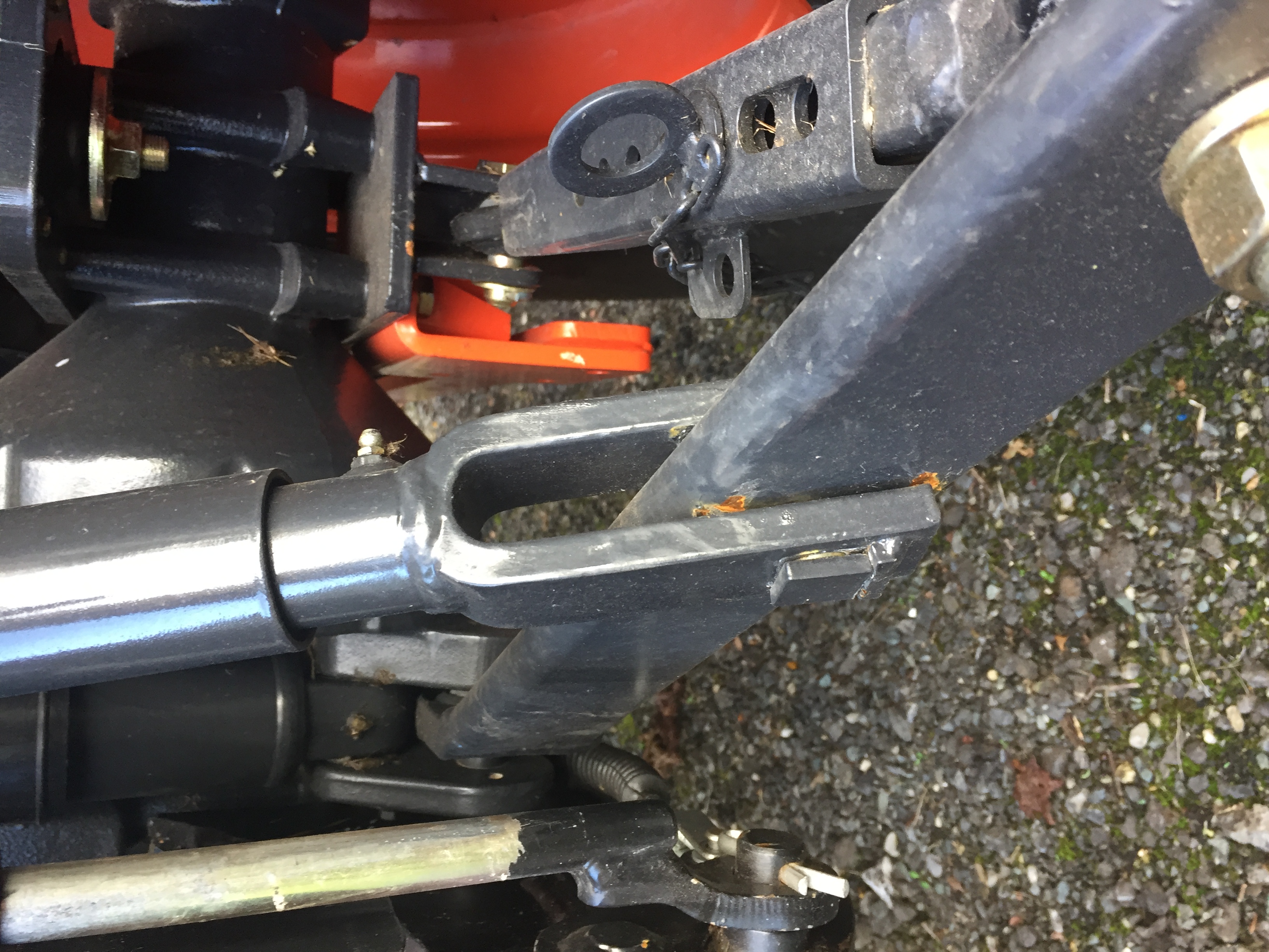

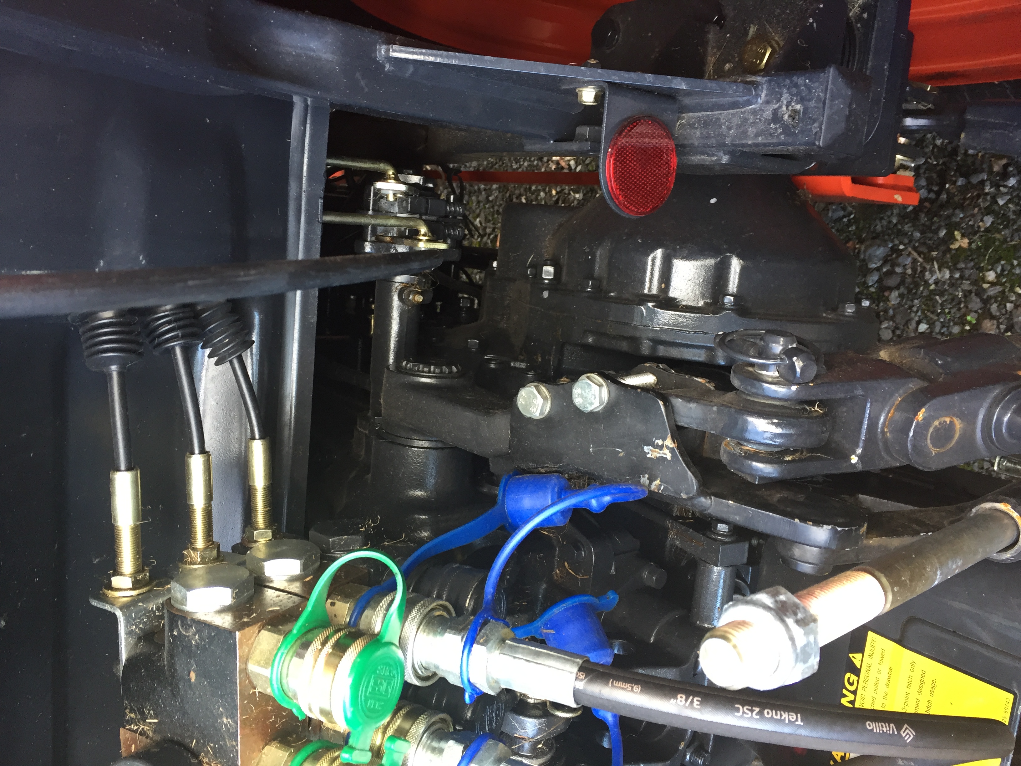

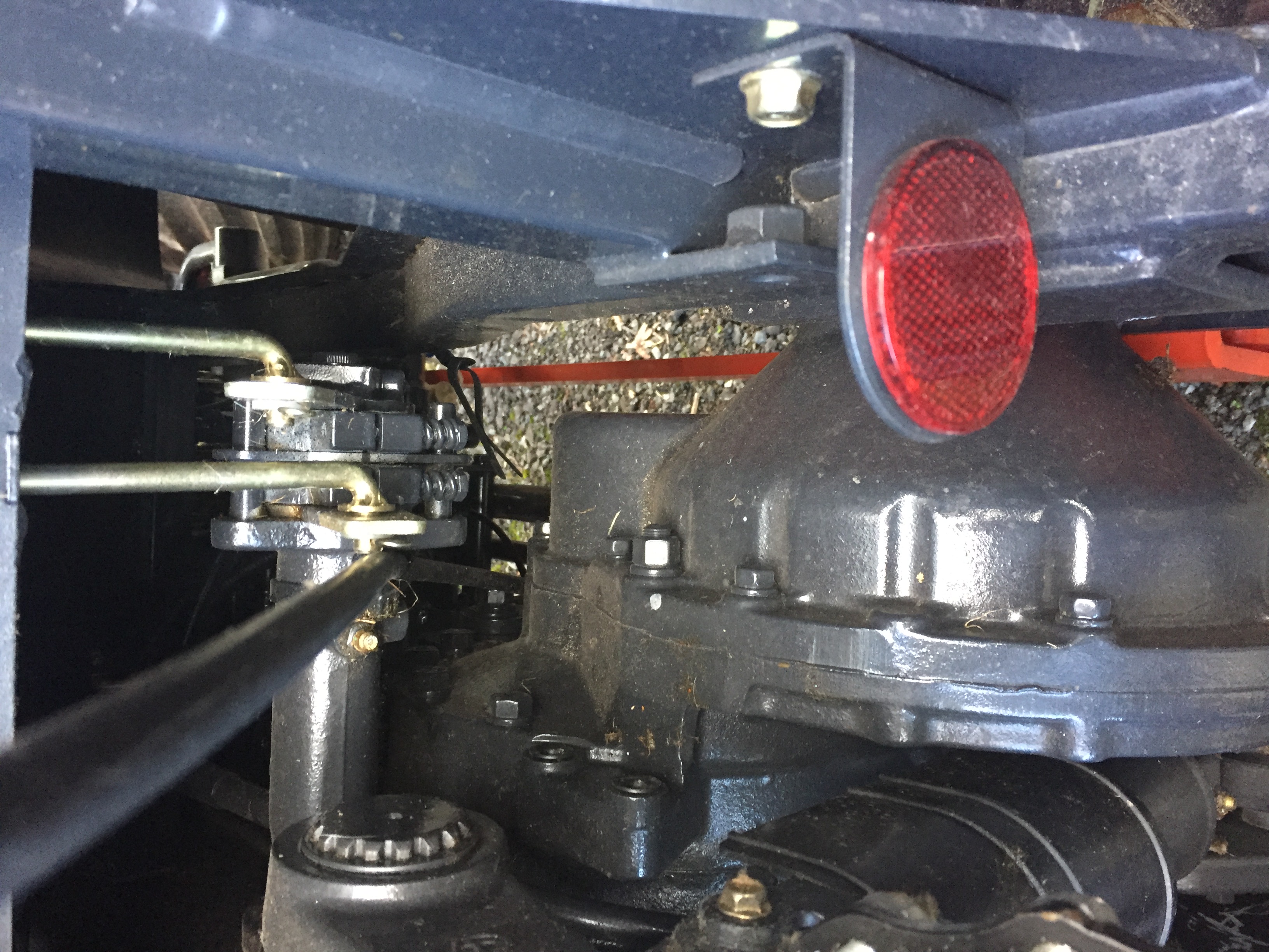

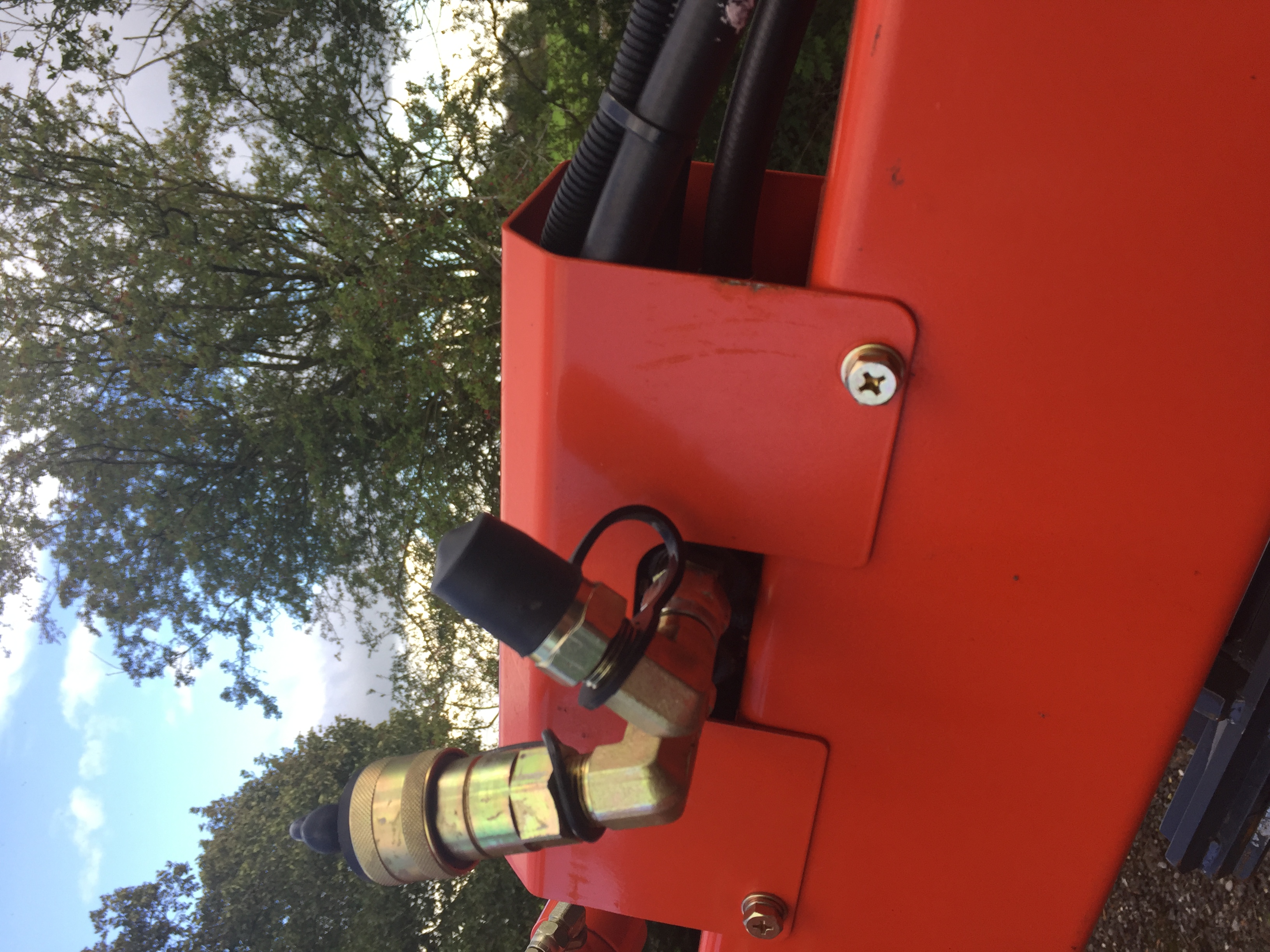

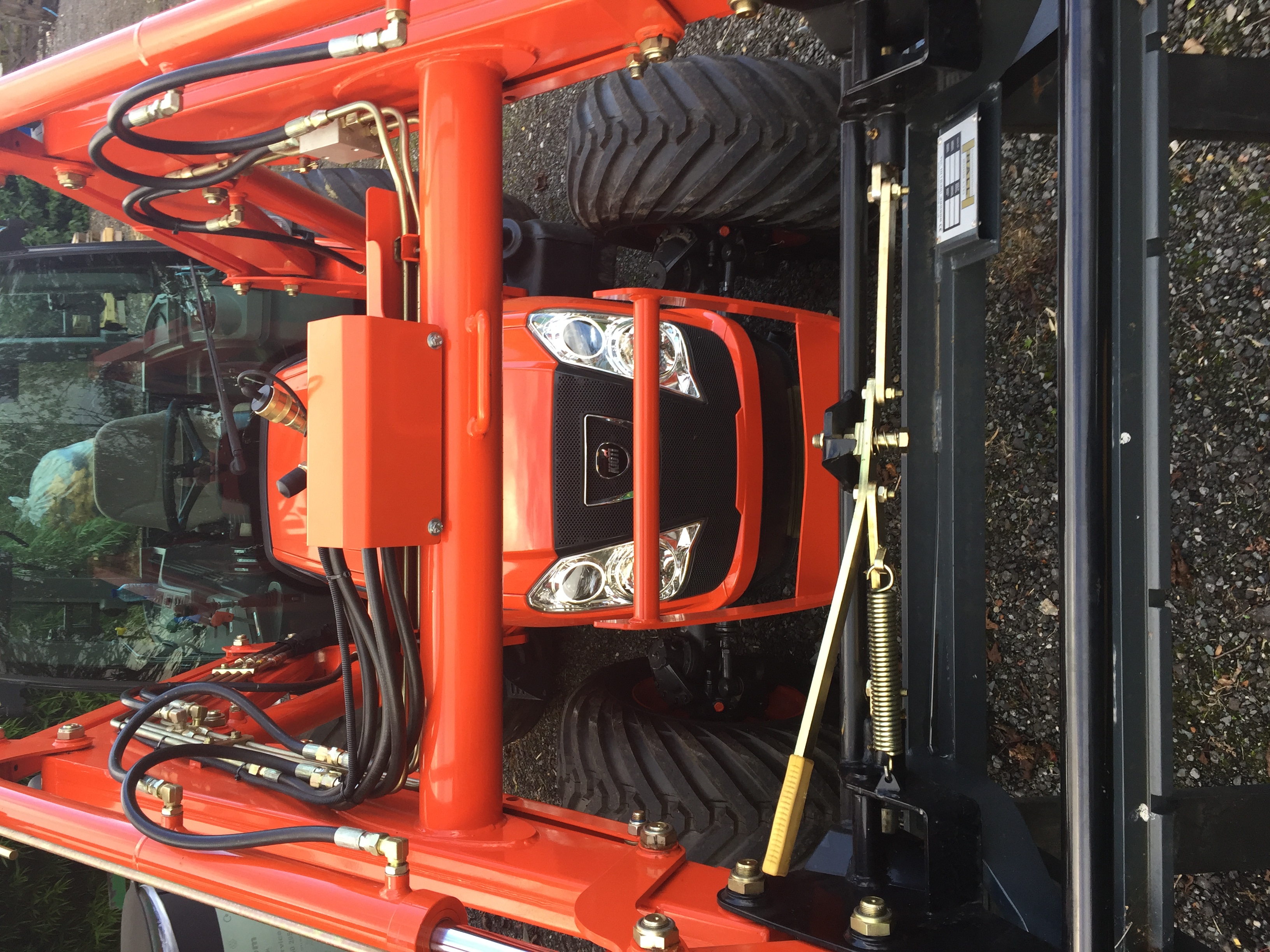

With luck these will show a possible route for your grapple hydraulic hoses.
My third service can be seen here on the front end loader.
You can see the orange bracket for the FEL clearly as it heads under the tractor - sheathed hoses tied tight to this should be OK for a while - until you can plumb in a pukka 3rd service.
