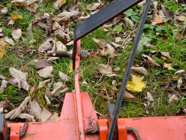

I have a TSC box blade and kind of put a bend in it. I didn't notice it until my son pointed it out to me. I was using the blade both pulling and pushing some undergrowth so I figure it was done while pushing. Otherwise it has done tons of work for me and it was worth the price........

/ Opinions on Box Blades? #12
Another view

/ Opinions on Box Blades? #15
I think I bent it because I had too much swing side to side. Didn't have the turnbuckles tight and when I was pushing backwards with it, away she went....
