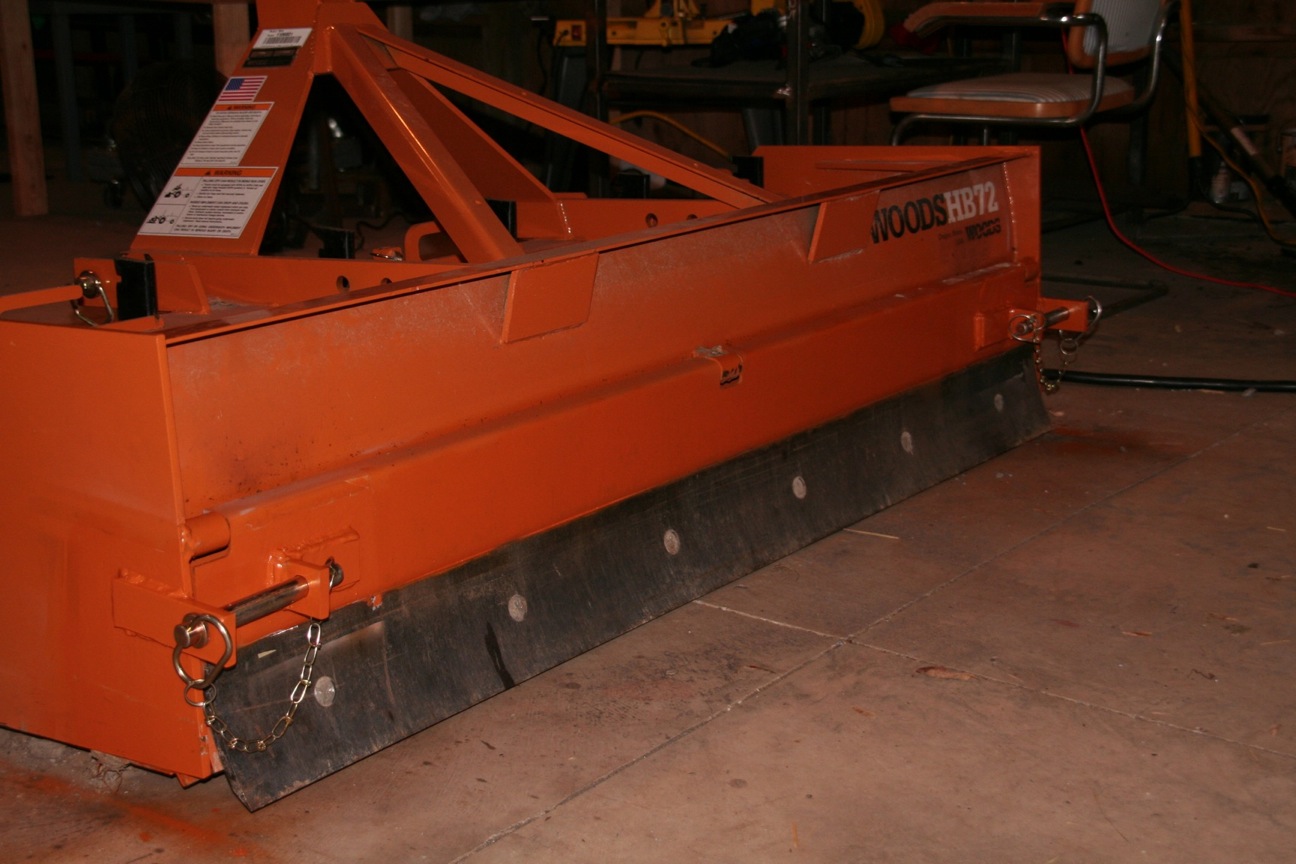

Well this project took me quite a while to get finished. I played around with my welder on scrap steel to get enough confidence to take it to my box blade. I did make a few mistakes and learned very quickly that making mistakes with 1/2" steel is NOT fun.
Many hours of grinding ensued. The finished product is not quite as neat as I think I could probably achieve now after having learned a LOT about welding just on this project.
That said - it is done and now I have the option of fixing my rear blade or having it float.
I am using two 7/8" pins and the blade does not move more than a couple of mm.
I've posted a photograph for anyone interested.

Canoe, Good job!! There is satisfaction in finishing something like that and in the process learning new skills.
I have a couple suggestions that You can take or leave as you will. You can make it a bit more aesthetic by rounding off the corners (It might save a shin scrape too). Secondly, with the two tabs a distance apart you will eventually get a bit of movement and the holes will elongate into ovals. You can eliminate that by putting a third tab between the two tabs that are there now.
I would wait to do any mods though until after you work some of that "purty" paint off. :D
OK now that you have a taste of "fabricating" you will have a thirst for something more--so what is next in your mind. After all you have a great welder that is just itching for a new project. :rolleyes:
