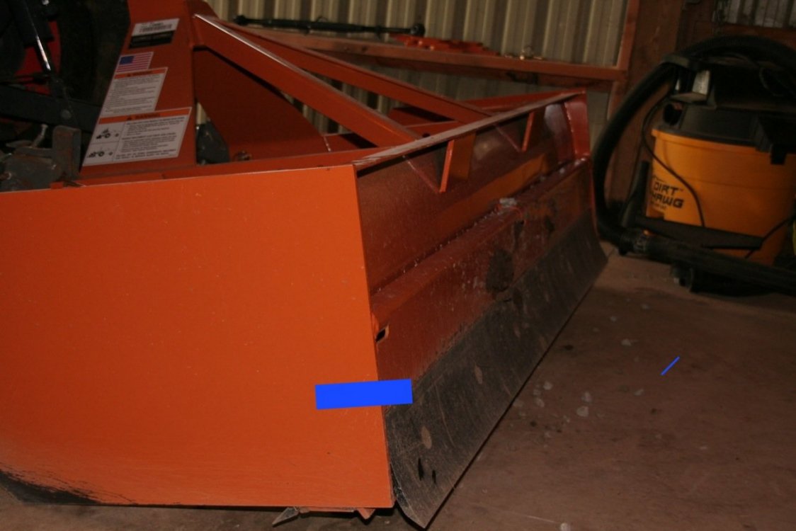

I'm ready to take on my first implement modification project having gotten to the point where I think I can weld well enough to do something simple.
My box blade is the kind that has a hinged rear blade and I want to set it up so that the rear blade could be fixed optionally. Others have noted that a fixed rear blade works well for final grading... figured I might as well have the option.
There are some box blades that come from the factory so that the rear blade can be adjusted to either be fixed or not. I've never seen one like this. If you have one, can you describe to me what the mechanism is that either locks the blade in place or allows it to move?
I have attached a picture of my box blade. My current thought is to weld a 3/8" plate to each side so that it over hangs by a couple inches off the rear. Then I would drill 2 3/4" holes into each of these side overhangs through which I can insert two 3/4" pins.
The pins alone might do the trick but the rear blade is not shaped exactly straight (unless one 3/4" pin would do it).
Thought was to cut another 3/8 piece for each side which would be loose and would fit up against the rear blade. It would also have two holes to align with the welded on side plate, through which the 3/4" pins would go.
Not sure if one 3/8" piece on each side supported by two 3/4" pins will adequately hold the rear blade in place.
Your thoughts are appreciated.

Oops.. here's the blade.

buy some 3/8" thick by 2" angle iron. Bolt it on the edges so it holds the edge down. The bolts will go from outside to inside. Inside the box, weld nuts so you only have to loosen / tighten from the outside.
Align the angle. Clamp it in place. Drill the holes thru the angle and the box. Remove the angle. Grind off the paint on the inside. Assemble the angle with bolts & nuts. Protect the bolts so the weld slag doesn't freeze them. Weld the nuts. wire brush off the burnt paint, prime, paint, photo and admire.

john_bud - glad I came and asked here!
In bed right not but I will check the blade tomorrow. Pretty sure that area I would have to drill would not be terribly accessible from the inside of the box blade even to weld on nuts.
That said, I'm thinking of a simple modification to your idea. Welding on a 3/8" piece at each end jutting out of the back two to three inches, so that I have something to drill that I can access. Bolting on the angle iron except reverse to the way I'd have to do it as per your description.
Now that I think about it, I have some 1/4" thick angle iron about 3-4" sitting in the shop that I picked up at a scrap yard to practise welding. I think it might work perfectly if 1/4" won't be too weak. If it is - well it was scrap anyway, and I'll go replace it with something stiffer when it bends up!

If you use loose nuts you access them from the bottom. Just put it on the 3 point and lift it up. If you want to weld the nuts on then set the blade on its endplate
canoetrpr said:
john_bud - silly question from a welding newbie. How does one "protect the bolts so the weld slag won't freeze them"?
Put a bolt in them that sits flush with the nut face before you start welding. Remove it before the nut cools completely.
That said, I think you'll be disappointed with nuts welded on. The welding heat turns your nice grade 5 or grade 8 nuts into something that's softer than hardware grade fasteners...

Looks like welding nuts or putting hole in the side plate won't work out for me. The area is inaccessible even from the bottom. This is the area between the two (front and rear) blades and there isn't a way to get to it on the other side.
However the modification to john_bud's idea will work. I'll weld up a 6" by 3" 3/8" plate so that 3"x3" juts out behind the side plate. I'll drill that and hook the angle iron to that.

You could bolt a flat bar to the side of box overhanging the back and bolt angle to rear blade so the two could be pinned/bolted together. In this location.

cleatus.. that's exactly the modification of john_buds idea I had in mind. Except instead of bolting the flat bar - as there is no room on the other side (and because I have recently acquired a welder :D), I'm going to weld that flat bar on. To give it strenght it is probably going to be a 6" x 3" 3/8.

Your idea will work good, but if it was me, I'd make it a little different (since you asked:) ). My idea would be to make it easy to switch back and forth and not end up with any loose components that could be lost. Of course, it's a tiny bit more work. But hey, you wanted the extra welding experience, right?
I would weld on tabs just like you said, using fairly heavy stock like 1/2 thick plate and holes in them, except I'd use 3 tabs on each side, or one long one that would span the distance needed. The center tabs should be located about where your hinge pivots now. The lower tabs placed just above the cutting blade and the top tabs an equal distance up from the middle tabs. You want to make a pivoting lock (pivoting from the center tab) that can be pivoted up and down to lock or unlock the hinged blade.
So the lock would have a hole on each end to fit a pin. One end of the lock would be pinned to the middle tab permanently. The lock could be shaped like a barbell or a piece of steel welded to it, so when it is pivoted down to the hinged blade, it would touch the blade. Then you put a pin through that end and the lower tab to keep it there...which locks the blade down. When the lower pin is removed, you can pivot the lock up to the top tab and pin it there, which retains it in the "up" position and allows your hinged blade to work freely. Use the same hitch pin and lynch pin so you don't need and spare parts and there's nothing to stowe or lose.
You can radius the edges to make it look better and use one length tab like I said before. So that's my idea...:)
What do you think?

I think it is a great idea. Originally I was thinking of welding the tabs so that they would overlap on the outside of the side plates of the box blade - so fillet welds... but I'm thinking that your idea calls for the tabs to simply be extensions of the side plates - so butt welds.
That sounds good... I'm a little more confident with my ability to stick two pieces of metal together with butt welds anyway :)
I like the idea of going with one larger tab - it will keep things simple. Do you really think I need to go with 1/2" stock? The box blade side plates are 3/8" and I have 3/8" stock lying around.
The only thing I'm not sure is how big/thick/wide the lock needs to be in order to old the rear blade in place. What do you think of the idea of using a couple modified top link pins for the locks? I think it should be big enough. Its got a lynch pin sized hole pre drilled at one end. I could just cut it to size and drill another hole at the other end for the hinge.
I suppose another option is to weld a two to three inch wide piece of stock, onto a top link pin cut to size with the extra hole, to act as the lock.

You can surely use 3/8 stock but I was thinking the force from the back blade might kick it out a bit and the hole would elongate? Perhaps use 2 pieces spaced apart a bit sort of like how the lift pins are boxed in so they don't bend or flex out. You can butt or overlap weld them to the side plates.
Yeah, a pin like that would work great. Use the small existing hole for your center pivot and on the other end instead of drilling another hole, you could weld a pipe or thick tube to the end that would accept the pin diameter? Or, like you said weld a piece of metal to it with a hole drilled in it. I always like to make stuff as simple as possible when I can or ... lol ... as hard as it needs to be to work.:) You've got a good imagination and mechanical skills, so just fit whatever in there that will make it work and not fail.

Rob, I've decided to go with something based on your idea. After mulling it over, 1/2" is DEFINITELY the right thing to do here. That rear blade on this box blade is really thick stuf. Lots of 1/2" steel on this box blade.
Just picked up 4 feet of 2" x 1/2" flat bar today for the project. I'm going to practise some more fillets and Ts on some scrap before getting into it but I think I've almost got enough confidence to start welding onto my box blade.
