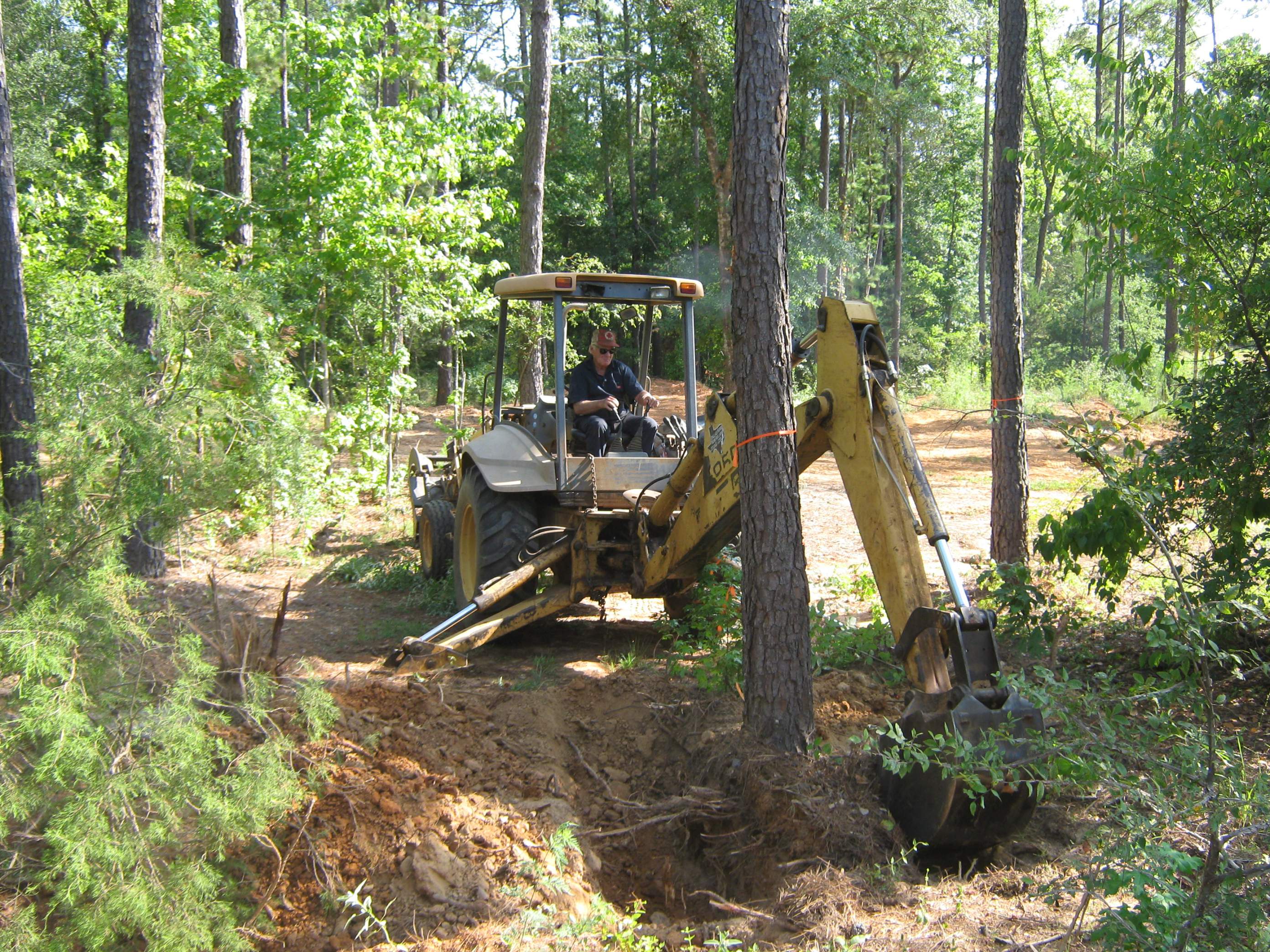

Only picture I could find that might give you an idea of how it's done. After digging down two sides, you change position and dig out the other two sides, to create a square. On some trees, especially big ones, you have to undercut the stump a little to get it to break free. Other trees you have to go down deeper, but for small pines like this, it's pretty simple.
I dig my first two sides where I want to three to fall. Then I dig the other two sides, then lift the hoe stick as high as I can and push. It always falls right where I want it to. Out in the open, where I can either pick it up with the grapple, or get a chain around it and drag it to the burn pile.
Sometimes you get a tree in one of those awkward locations where you can't drop it in the most ideal place to remove it. Then its more work either cutting it into smaller pieces, dragging lengths of chains to it, or taking out other trees to get to it.

Gravity keeps it in place. The hardest part of it is pushing them over once you have dug a trench on all four sides. .
It's not a good idea to dig around 4 sides of a tree as it leaves little margin of error. Digging 3 sides then push the tree towards the undug side can stop the tree from coming back on you. Sure it may take a little longer. This work I did for a living at one time, never put a scratch on me or the excavator

I also use my backhoe to get tree and root ball combos. Only I first throw a long rope high in the tree and tie it off in direction of desired fall. Then I dig out the three sides, leaving a hinge in desired fall direction. Then I attach rope to tractor and pull. It's a very slow and graceful process. And, thus far, 100% successful.
