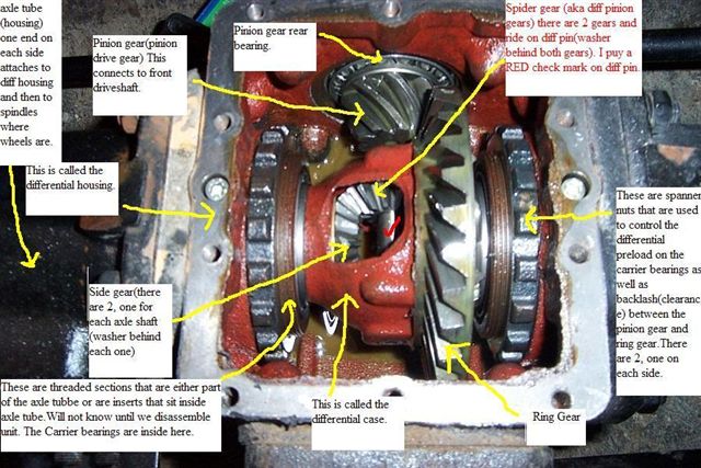

It is not a "planetary" gear set at all. that is a whole different set-up with a Sun gear, ring gear, and planetary(planet) gear set. Different animal all together.
These are a conventional differential gear set, there are two 'side' gears, two "Diff pinion" gears. These are housed in the diff housing which is your ring and then pinion. Guarantee,,,,,if you place in 4WD and have one front wheel on ice and one rear on ice the tractor will spin those two wheels. Now if you engage your rear diff lock now the other rear wheel will have traction. I helped a guy rebuild one of these Jinma diffs by internet and have many pics of the parts and assembly and know whats in there.
There is NO limited slip diffs in these Jinma's. Maybe, It is just a coincidence that Greg had equal traction on both front wheels and they both spun, this I don't know for sure. Unless they(Kama) do have a different system that uses a locker type for the front. This would place tremendous stress on the front shafts as they have to transfer torque thru the shafts on angles. Makes it even more critical operating on hard surfaces in 4WD if this is the case.
Attached is apic of a Jinma diff with parts labeled.
