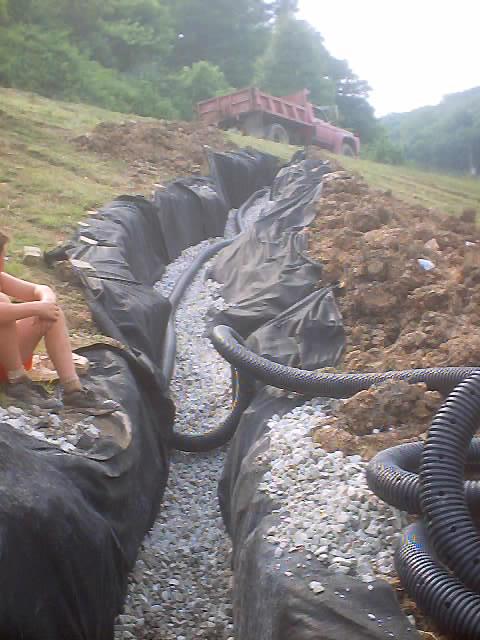

I just put in a french drain along a hillside to collect spring water and collect runoff from the hill.
I dug a trench about 3 feet deep, laid down some geotech fabric, and put a 4" perforated pipe into a bed of 1 1/2" to 2" gravel and wrapped the fabric over the whole thing. It took about 12 tons of gravel for 70 feet of drain, but this thing was pouring out the water with the recent storms we've been having!
This thing will handle more water than a sock-wrapped pipe, I'd bet.
