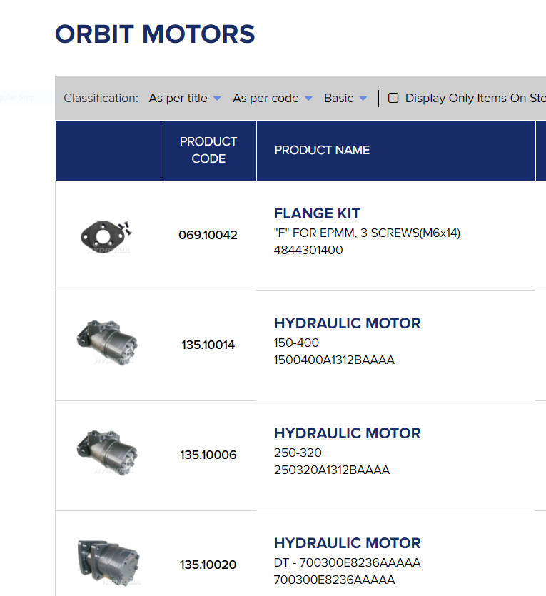

Orbit motor? Are you referring to a travel motor? As far as I know all hyd motors are used in a rotation function
Sorry I have no clue what a "travel motor" is. Below is a photo of orbit motor.

All motors are an orbit rotation. Aka they all turn as fast as they "told" to via flow. A travel motor is a motor that turns a tire or final drive gear box.

So is a travel motor hyd powered?

Yes. It's the same ( can be ) as what you showed. But they can get more complicated than a fixed displacement one like you showed. I deal with alot of this type.
