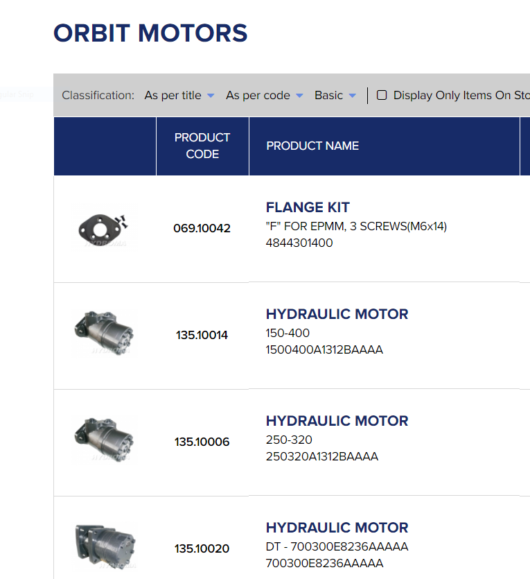

"Orbit motor" is a somewhat generic term like "bandaid" I had never heard the term "travel motor" until this thread. An orbit motor would be used as a travel motor whether direct drive or reduction.
Here's an illustration of the orbit motor internals. I believe that Char-Lynn may have been the pioneer in orbit motors but not sure. The rotor rotates in an orbit.
https://images.search.yahoo.com/ima...p&sign=10ahc8r6p&.crumb=thc0suckgEI&fr=mcafee
