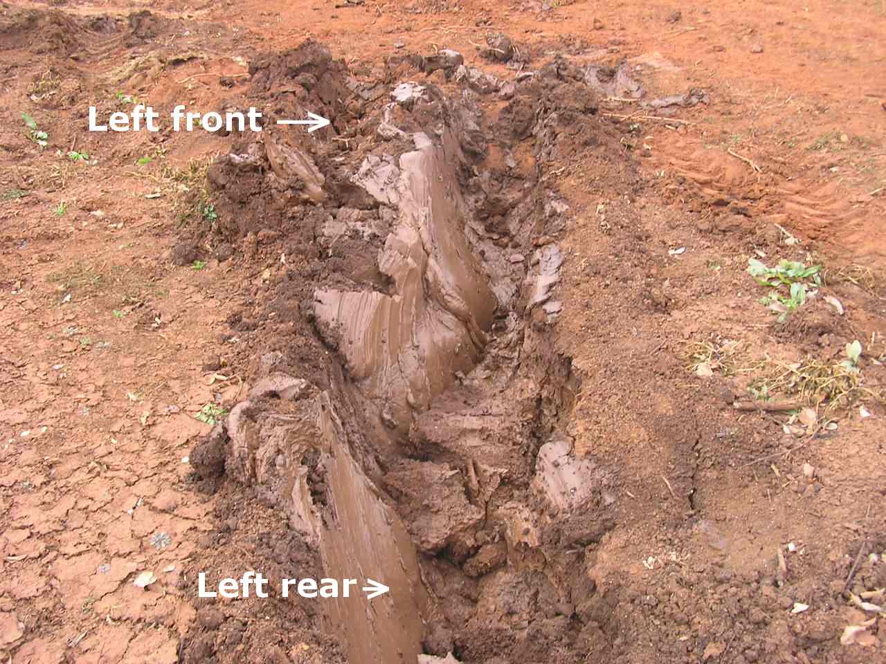

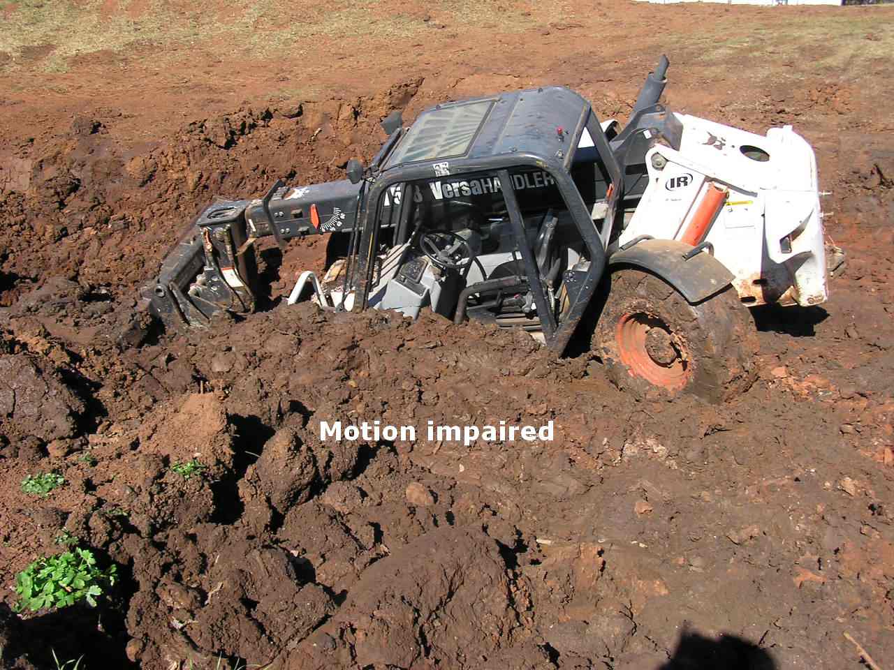

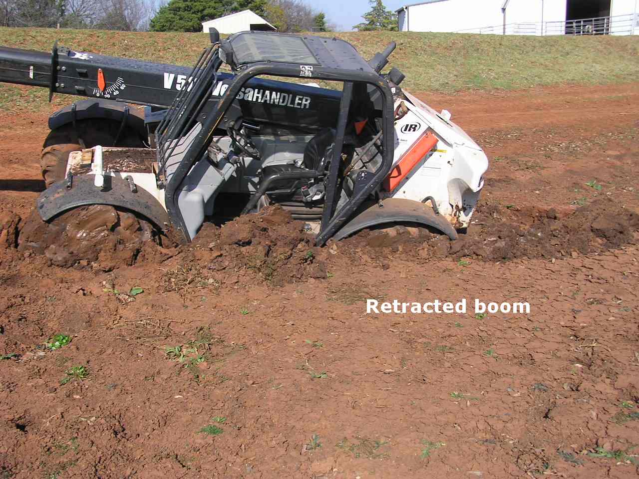

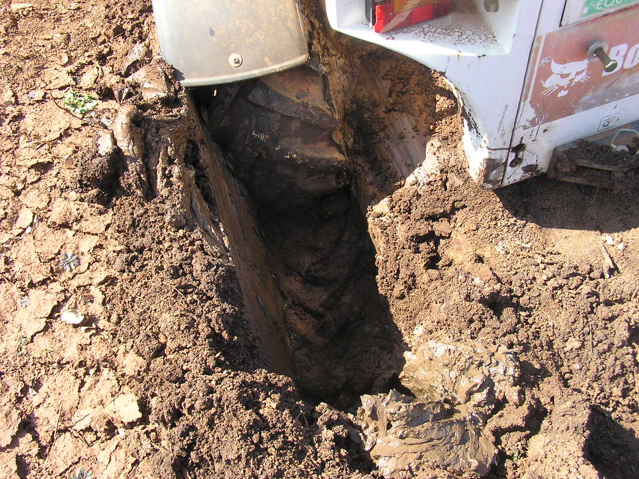

I have a lot of experience with silt, cleaned a 2 acre pond, silt was 5' deep.
Here is an unexpected stuck.
I turned the back wheels away from the silt, curled the bucket down, pushed the boom down, raising the front end, and extended the boom.
Third time did it.

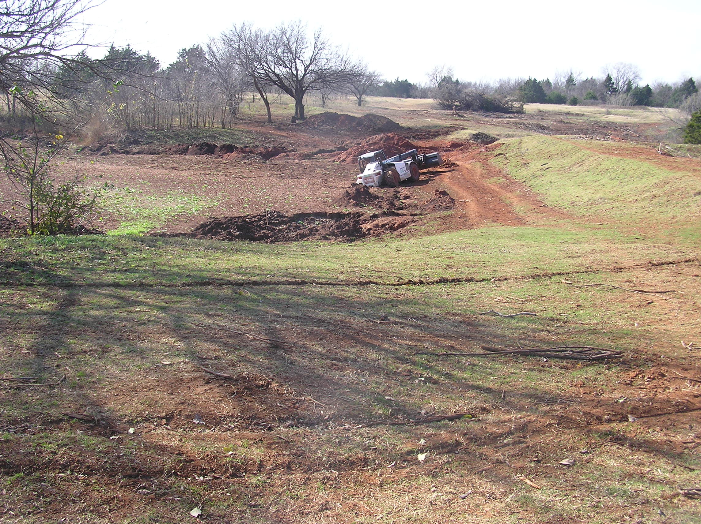

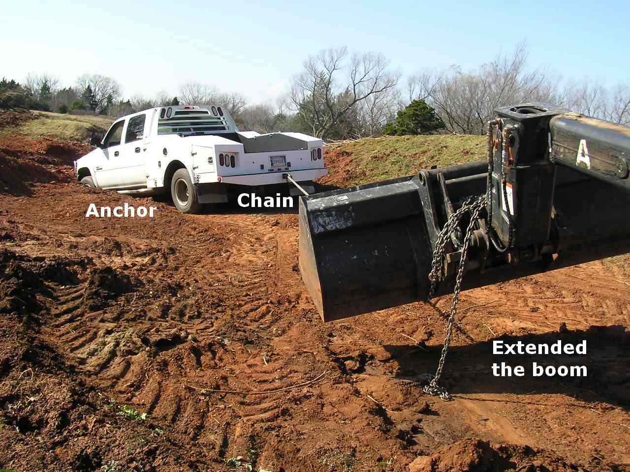

That Versahandler never needed to be pulled out. It always got its self out.
Like this time.
It had to have an anchor to pull against, though.
The tracks in the pudding! :D
