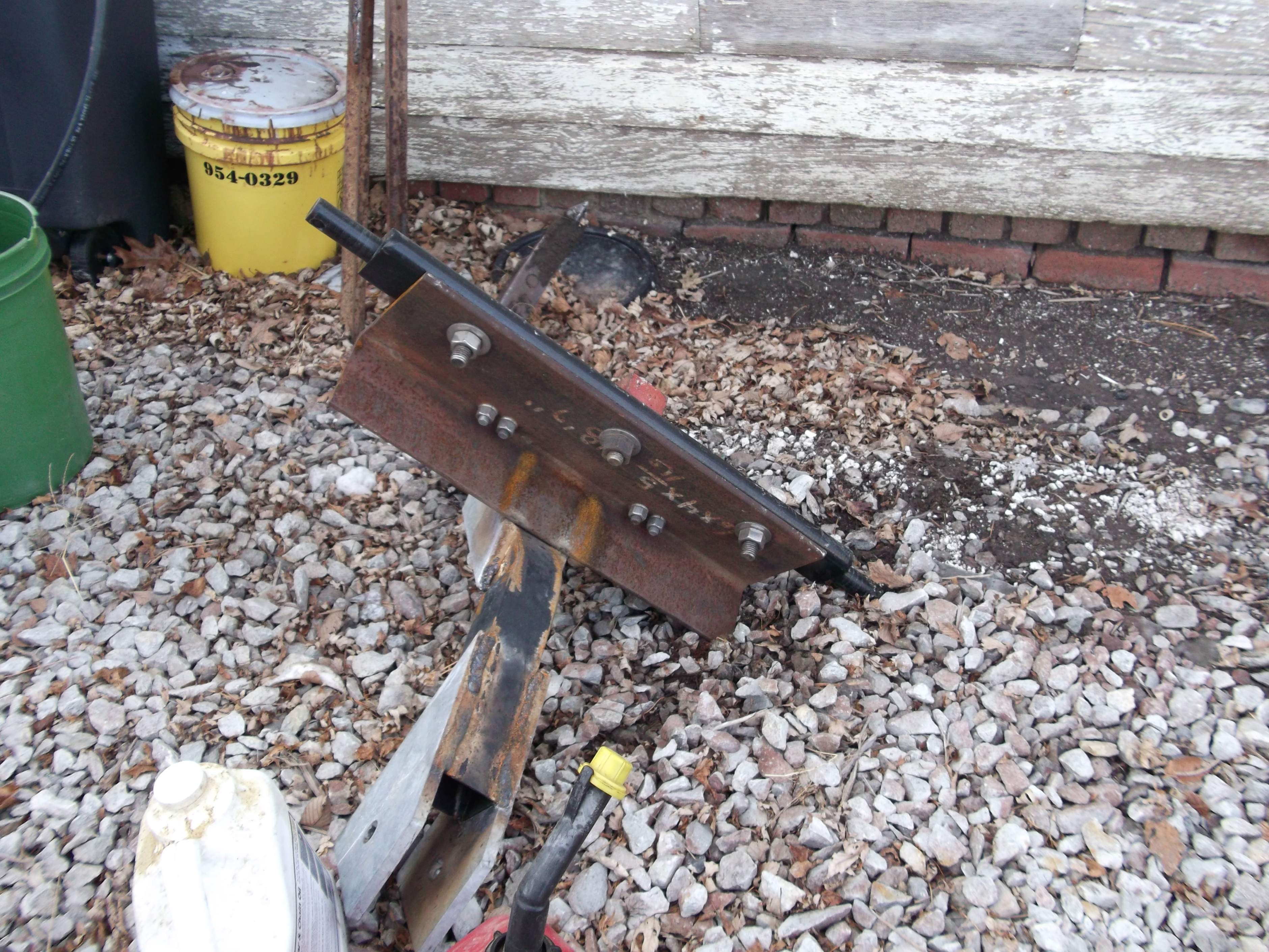

Well I've tested out the abilities of the 5530, bit more earth engaging ability(still like that term) than I figured on, I should have built my ripper a bit stronger and reinforced my blade(just a light duty king kutter) a little but I've cleaned up a good amount of fence line w/ them and removed several Osage Orange trees(yea I know I should not have used the snow blade when I have a box blade but the box blade is much wider and I am working in tight spaces, and I have a little platform on my scraper blade made for strapping on my chainsaw, fuel and bar oil).
Oh well it gives me that much more use on my new wire welder.
If only I had the right metal here thats what I get for being a tightwad and using what I had.:D

With yours skills as a millwright, there should be no doubt that you will be able to fabricate the necessary repair. Keep us informed.

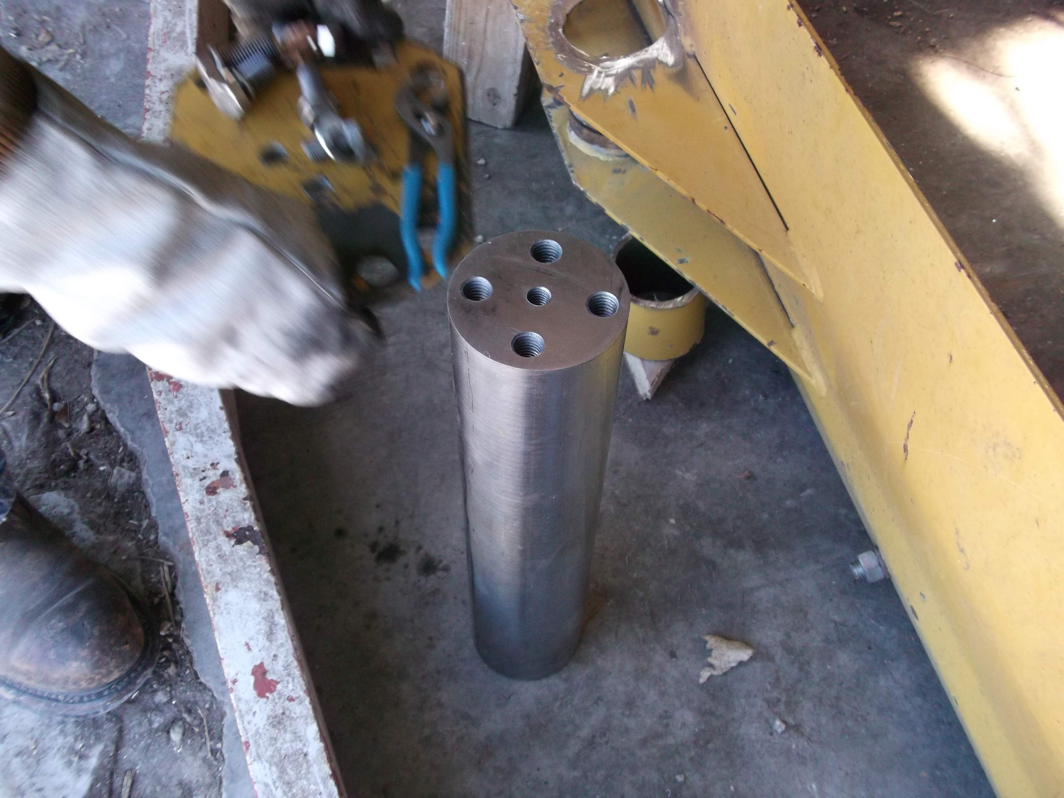

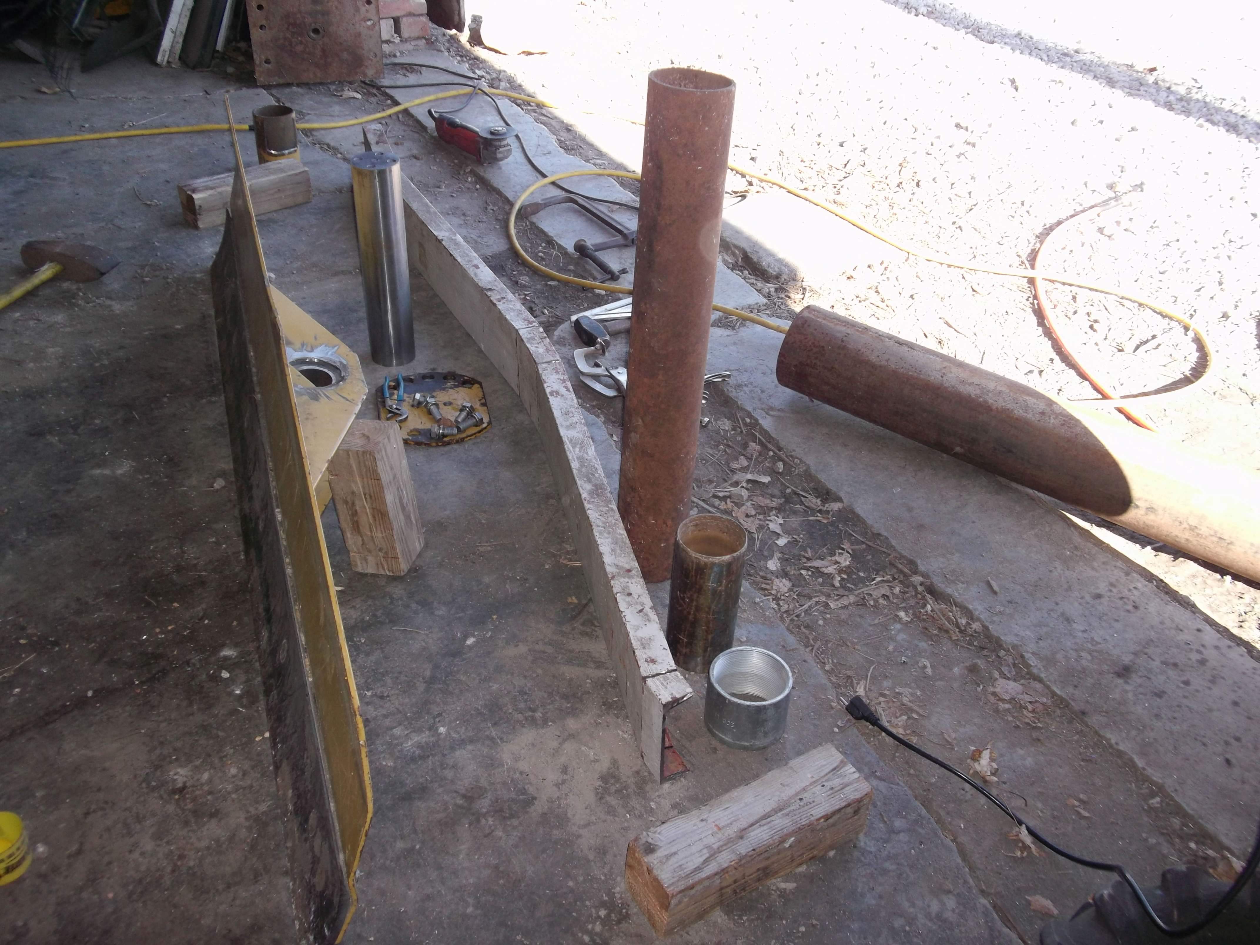

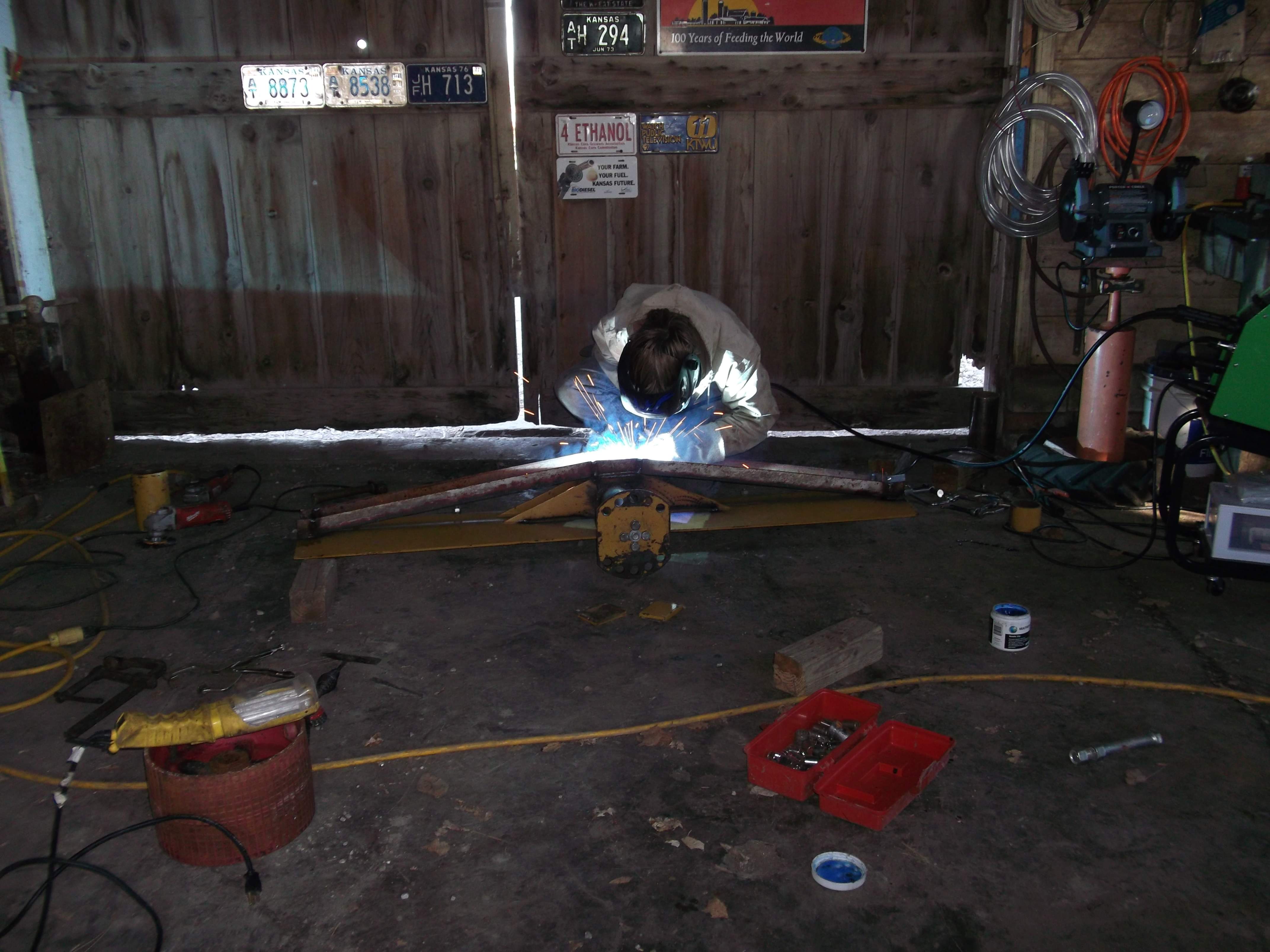

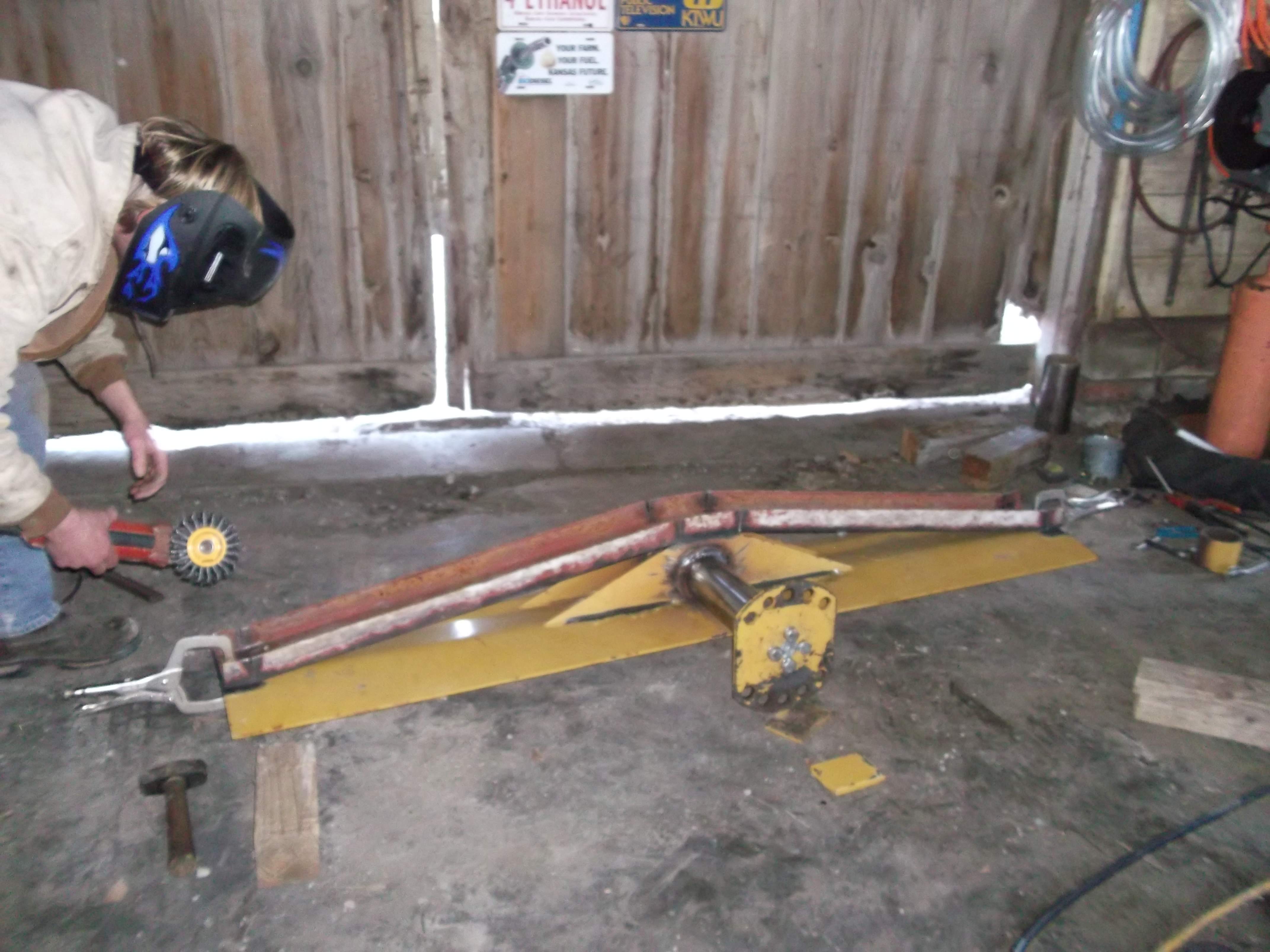

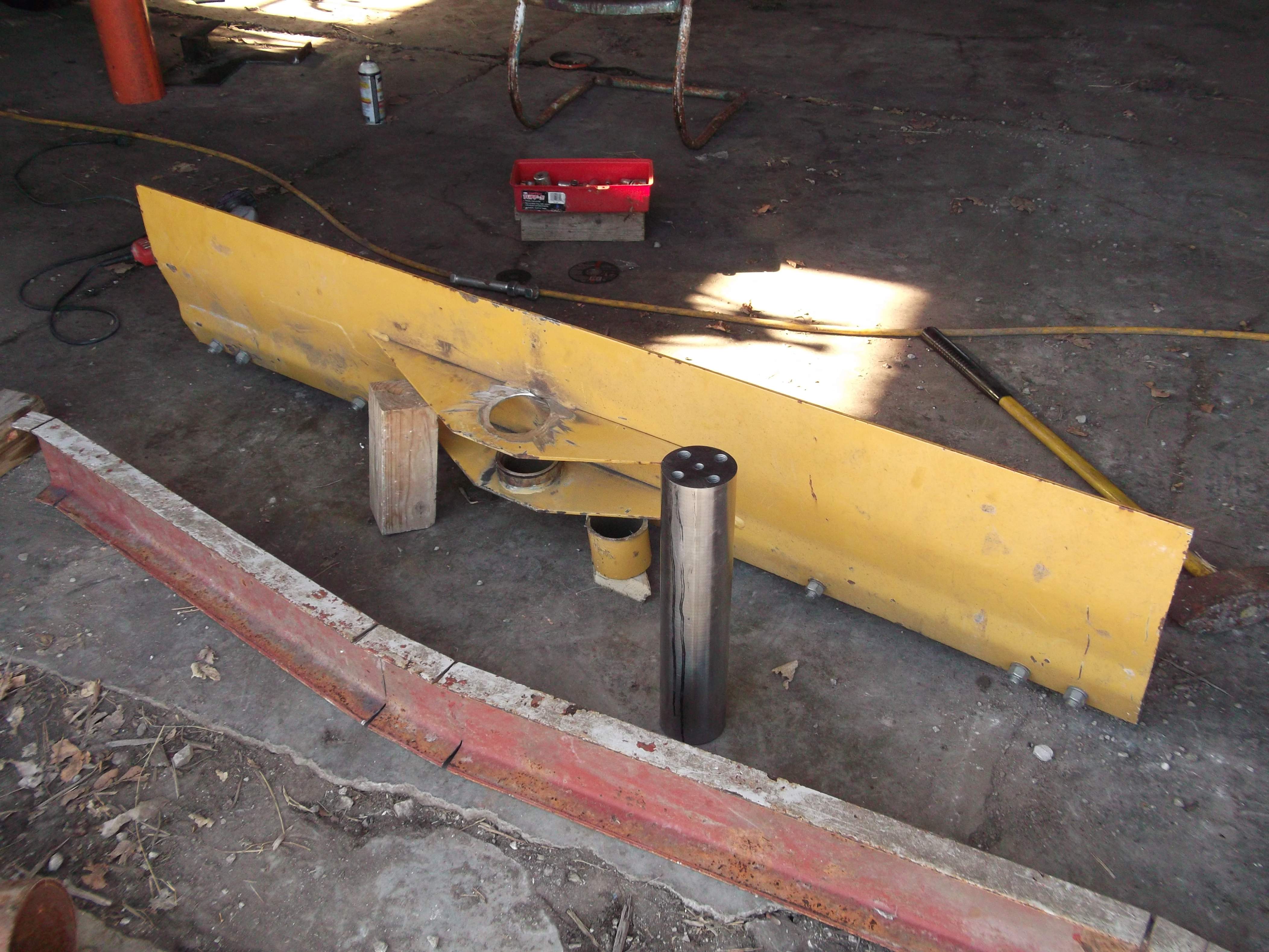

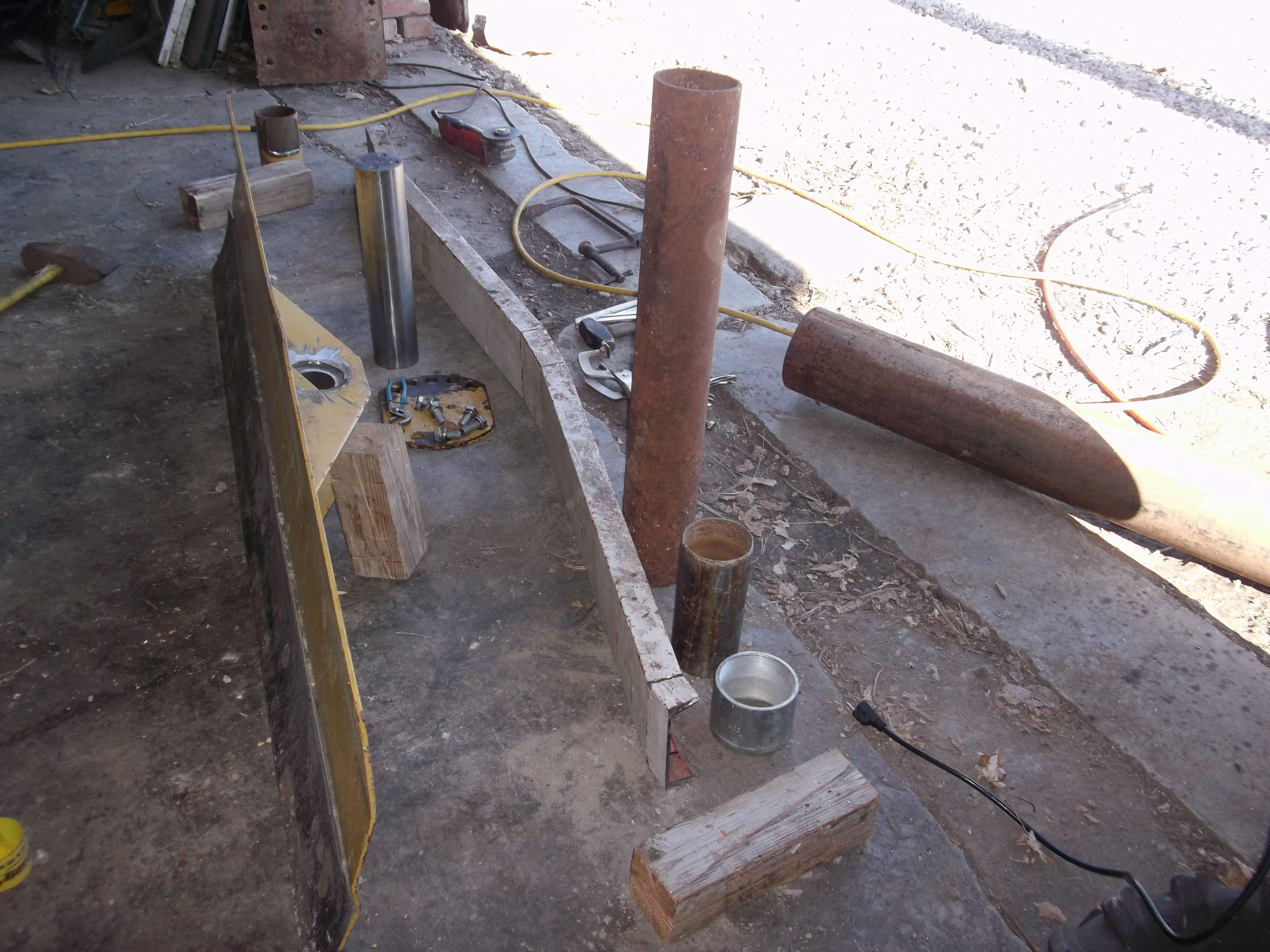

Figured I'd just show the repair of the damage I did to my blade on this thread instead of starting a new one.
Finally got some time to start working on and getting pics of improving my blade.
I went and got some solid shaft from a buddy and decided I would drill and tap holes in the shaft instead of welding it. Figured I may make an attachment for the front of the tractor and I wanted to be able to slide the blade out from the 3pt brackets.(Might have been quicker just to build another blade though cuz drilling & tapping those holes took forever) Also I did not want to cut up more of the 3pt's bracketry than neccesary to put the blade back in, as I do not yet own a set of oxy acty bottles and using a 4" grinder sucks and those dang cutoff wheels cost a mint.
Then I went and got an old door frame and started to re-purpose it into gussit material for the blade itself. I still need to add some flatbar material between the channel iron and the blade and reinforce the 3pt bracketry but momma wants to enjoy some quality time while I'm off work so i'll get back to it later in the week and hopefully I can get her to take more pic's of the progress.

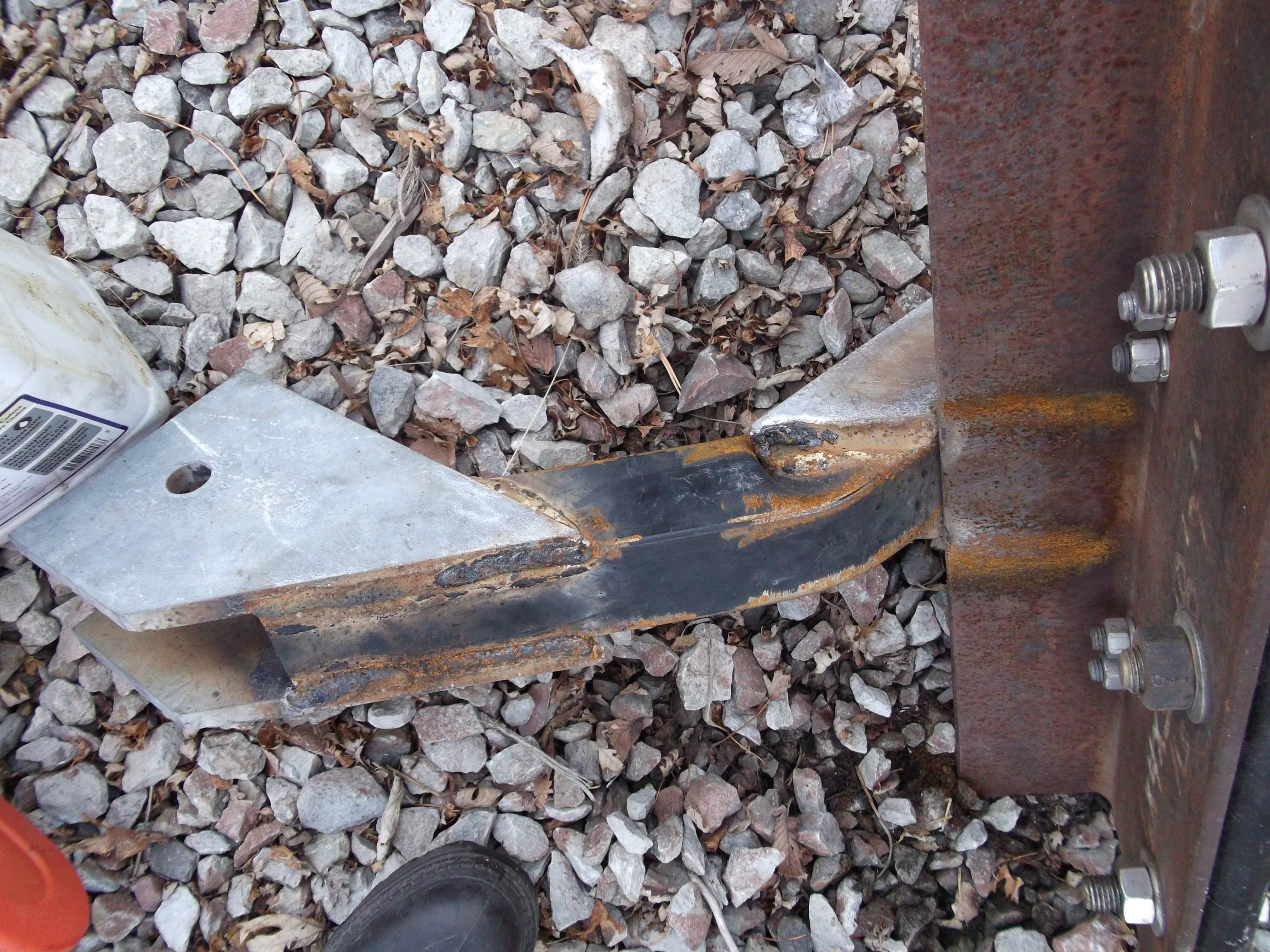

Wow this tractor can put it to the ground. I have found the next weak spot in my ripper/subsoiler and it's a good one this time. Oh well I think I will just start from scratch and build it all around heavier. On a good note I was pulling out 5-7 inch dia. roots with it so not too bad.
Also found that the Kodiak heavy duty box blades have a breaking point while popping out a couple trees. I broke the two further back bolts that come from the top link down to the box(Not ramming stuff just butting up against and lifting 3pt while pulling) but I am darn impressed w/ the strength of this machine it really puts the power to the ground as compared to a skid steer.
This makes clearing along the fence fun. I just need to build my attachments heavier than I thought.(Never figured on bending steel that thick:thumbsup:)
On a good note the blade I reinforced is working nicely but now I am thinking I should have gone ahead and made it wider and just bought a 7 or 8 foot cutting bit for it. Oh well something to look forward to buying or building in the future.:drool:
