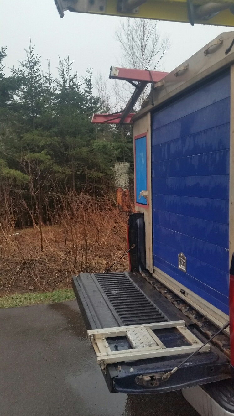

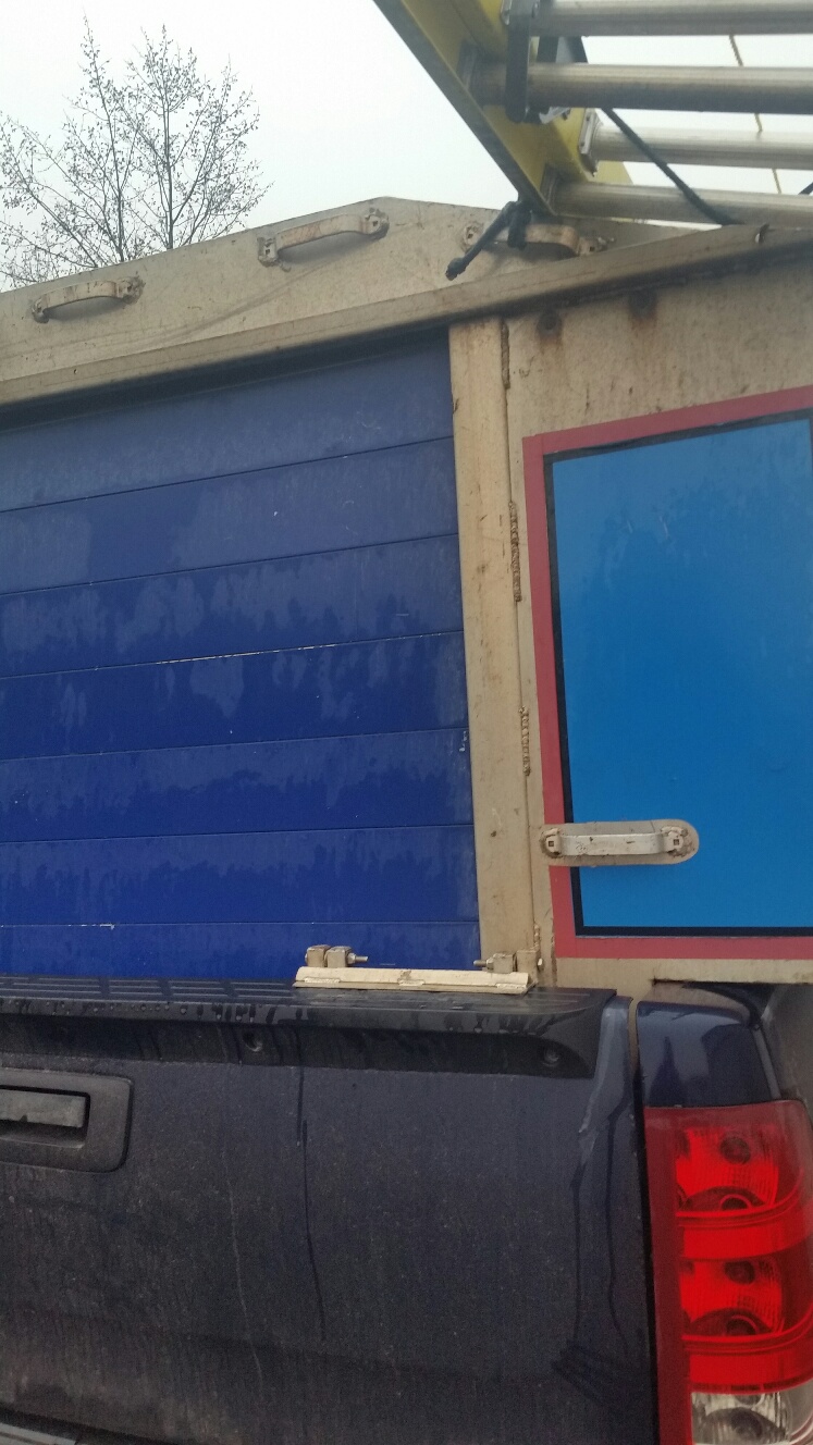

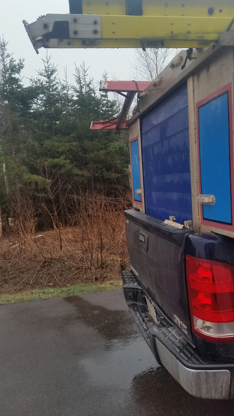

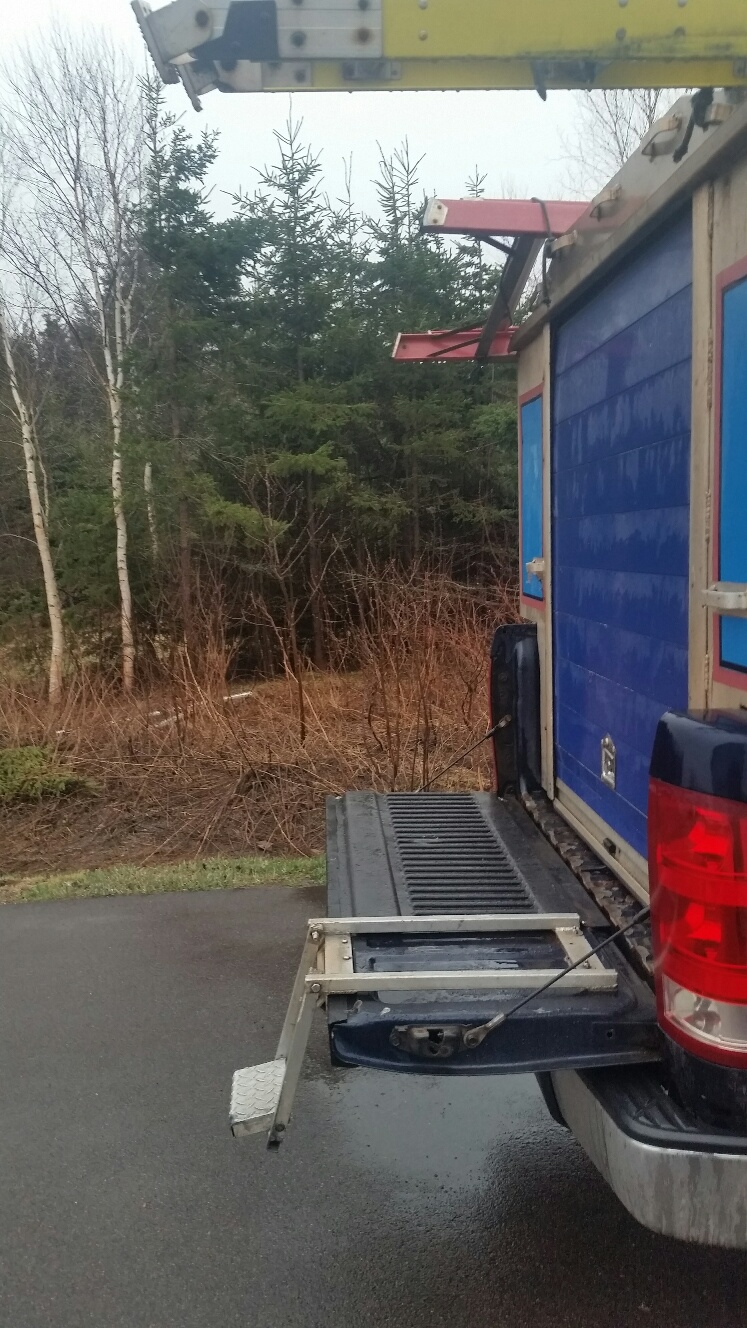

One of the past threads was on the sidestep and the flex they had. Part of this was from the rubber mounts the deck the rest from a light deck. I have noticed that when the tractors is running I can feel the vibration on this one under foot when on the step. It is great when getting on and off with the MMM on the tractor. I don't like stepping on the deck with it up.
When I got my 09 work truck the extra springs for the load was higher than the old truck. As I am in the back of the truck several times a day, my knees were taking a beating. So this project came from a couples hours at the local welding shop (I am their a lot) one afternoon. I just had a thought when I walked into the door and started going through the bits and pieces rack. As I chopped and played with the pieces I got one of the guys weld it together.
Was the best couple hours I spent. My knees love me for it.
Al

Nice, and I hope it is as sturdy as you say because the gusset is in the wrong place... You don't want the gusset on the face of the tube (in the middle like shown), but on the edges where it can bear on the vertical wall and not just the face of the tube. Putting it on either outside face works well, or at the edge of the tube (outside is easier, IMO). The phrase I have seen used is that it acts like a can opener if placed like it is in your build. If the overall structure is strong enough, then probably not an issue, but just not ideal. Just something for future reference...
Now that is something I didn't know or even think of. Still learning.
Al
