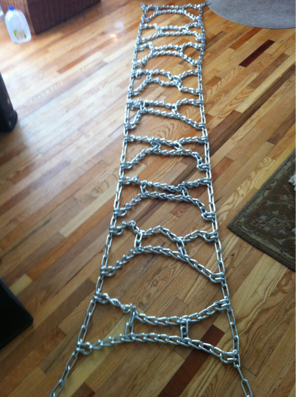

I've checked all over the place for chains for my tractor and finally found what I am told will work best for my use.
I'm going to get Aquiline mpc chains for just my rear tires for now. They allow for minimum clearance issues for my fenders, and R-4 Titan Heavy Duty Industrial Tractor Lug tires sized at 14.9 x 24
I am coupling that with a HLA brand, lateral float, with crossover valve, 2000 Series 7' all steel plow, made in Canada. I considered a Sno-way plow with vertical float, crossover valve, and plastic moldboard; which is also a good choice for my tractor, but I want as little stress on my loader assembly as possible. Lateral float seems from an engineering standpoint to best accomplish this task. There is another forum on snow equipment use and it has tons of useful information and detailed videos by guys like 4shorts. I learned today from one of his recent videos that to keep from slipping on the front tires he drops his plow on the ground and then raises it slightly to keep the weight on the front tires, INSTEAD of on the loader. Seems like a no brainer, but it makes perfect sense, especially coming from a former heavy equipment operator and experienced snow tractor specific professional user.
Here are links to the chain type I was referring to: Aquiline Tire Chains
And to the HLA Plow: HLA Snow

These I got today do I put them on tried it on a hill that was a sheet of ice they worked great I never had to put it in 4 wheel drive.
   / Only front chains? #49
That's what I have and don't use unless I really need them. The mile and half on the road to my shop will knock you silly. Be careful because you will still slide sideways going across a hill. They are fantasic in mud.
CM, know you will, but would really like to know what you think about the chains after you test them. Them look like my solution. Looks like they address packed snow and ice. Also side slip going across a hill.

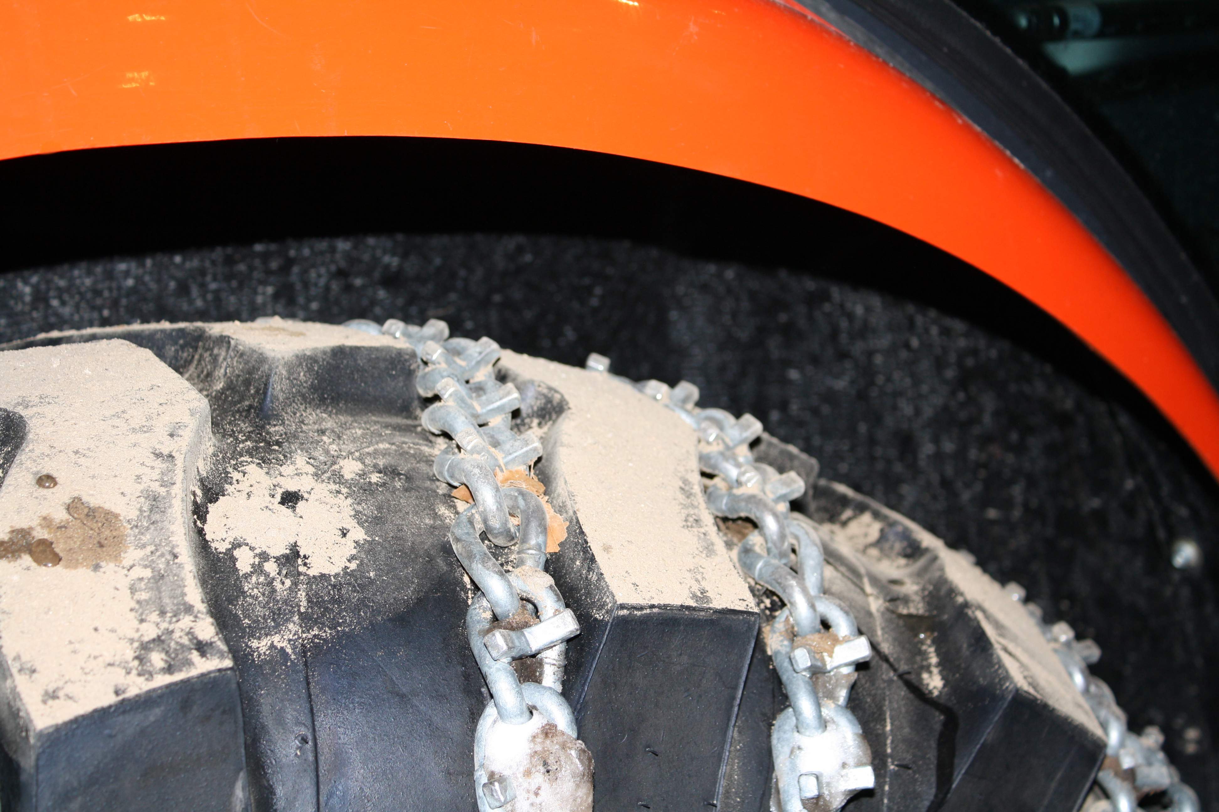

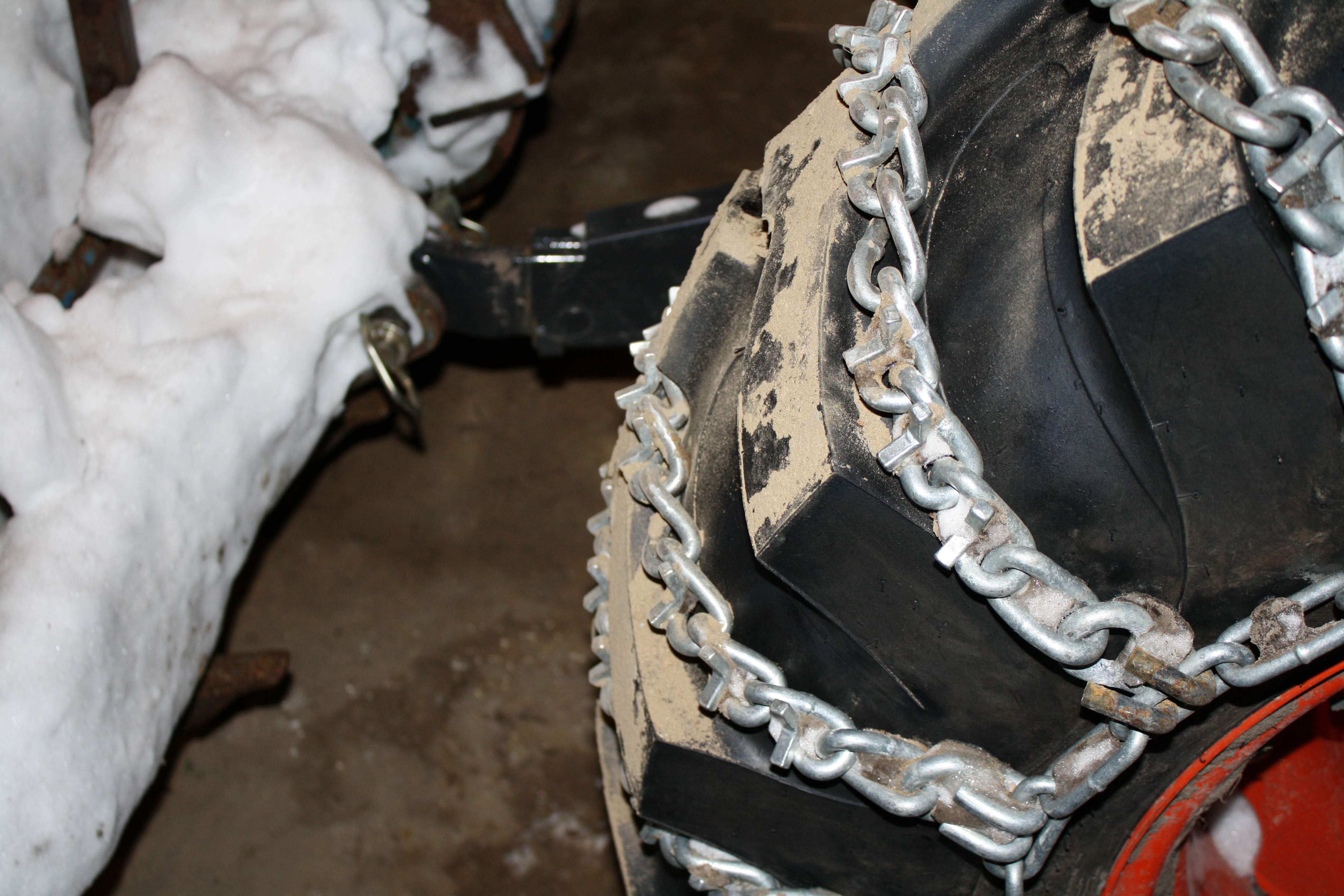

Coyote, DO NOT get a Snoway plow with the lexan moldboard. I have broke at least 3 of them and just patched them with steel. The plow is good just a poor idea with the lexan.tractor 020.jpgtractor 021.jpgtractor 023.jpg Included a few pics of my rear chains also. I finially figured out how to do it. [computer handicapped!] CJ
