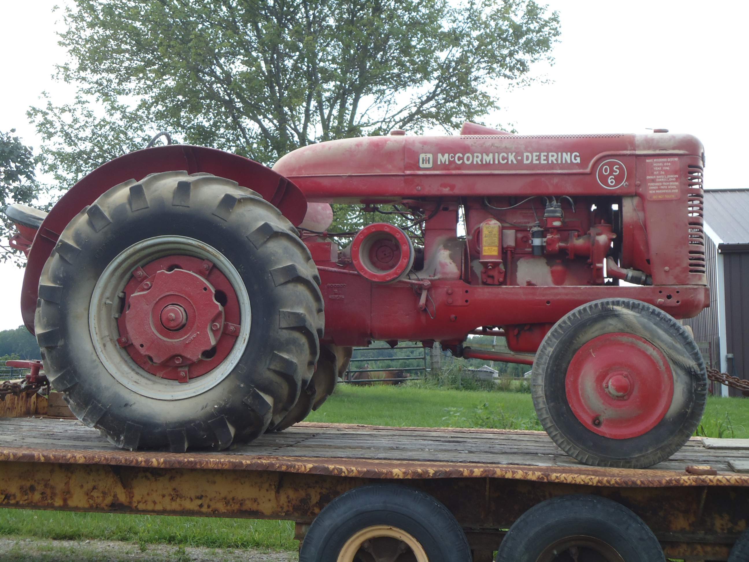

Nothing like on RFD. My prize possession is my '46 McCormick-Deering OS-6. Should be a picture of it down in the vintage tractor thread. I went as far as replacing leaking seals, and any other leaks. Stripped of old paint, primed and painted. Used to collect & show, but stopped doing that in '88 when I changed jobs. Still have it, and brought the ole' girl home last fall. It needs a good cleaning up, and touch-ups. Gas tank needs cleaned inside. At the last show it was shown at, I let one of the guy's grandson's take it around the Fairgrounds. They were trying to get the OH fuel tank emptied, that the club supplied gas for the members. Little did I know, I got the bottom of the tank with the crap, crud & water left in the tank. He thought he was doing me a favor... Brought her home, and backed in, and covered in the shed where it sat for at least 5 years. When I tried to move it to the other place, found the fuel system all fouled, and scaly rust in the once pristine gas tank. Talk about sick... So..., another job to do one of these days.
