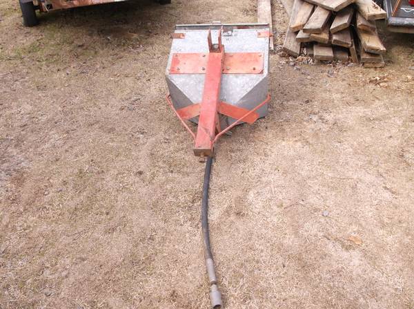

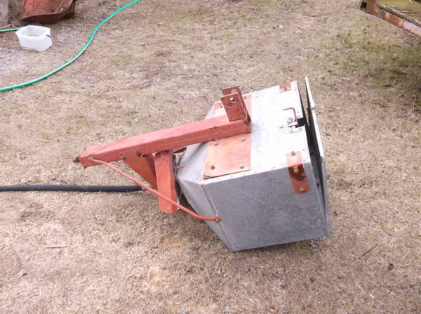

Would a spreader like this one work?? It's actually for sale on my local craigslist. The seller says the tractor has to have have a drawbar to mount, and it will work with 2pt or 3 pt. I am not familiar at all with those older farmalls, so admittedly I am not very knowledgeable about 1 pt hitches. I do know enough to realize this one is not a 1pt hitch (well the ad didn't claim it was either lol). I was just wondering if a spreader like this one could be adapted to the 1pt quick hitch??
/ One-point Spreader 1968 IH Farmall 140
Yes, sir; that one just might work with a little modification. How can I find out more (price, shipping, etc.) about this spreader? And thank you very much for the reply!

Not sure what type of lime you're planning on using, whether bagged lime, or Ag. lime from a quarry, but neither will spread very well through this type of spreader. It's so fine, it will pack, and bridge over, unless it has a really aggressive agitator, which I doubt. It'd probably be best to be searching for a pull type, drop type spreader. Important thing on those it to make sure the agitator is in good shape too. Plus real dry lime to feed well.

The one in the above picture appears to be more of a seeder, than a fertilizer spreader. I didn't look at the ad, but if it at least had the name in the ad, you have a look see. At best maybe 200 lbs. of fertilizer in it. And I do realize that's better than spreading it by hand. Just depends on how big the slide opening is, to meter it out. If it's a small slot, you could be driving around for a while emptying it. I've got a round cone type that does my small acreage just fine. It holds probably 500-600 lbs. And a drawbar mount seeder about half that size.
You definitely want a calm day to spread seed, otherwise, you'll have to be calculating some windage, LOL...
