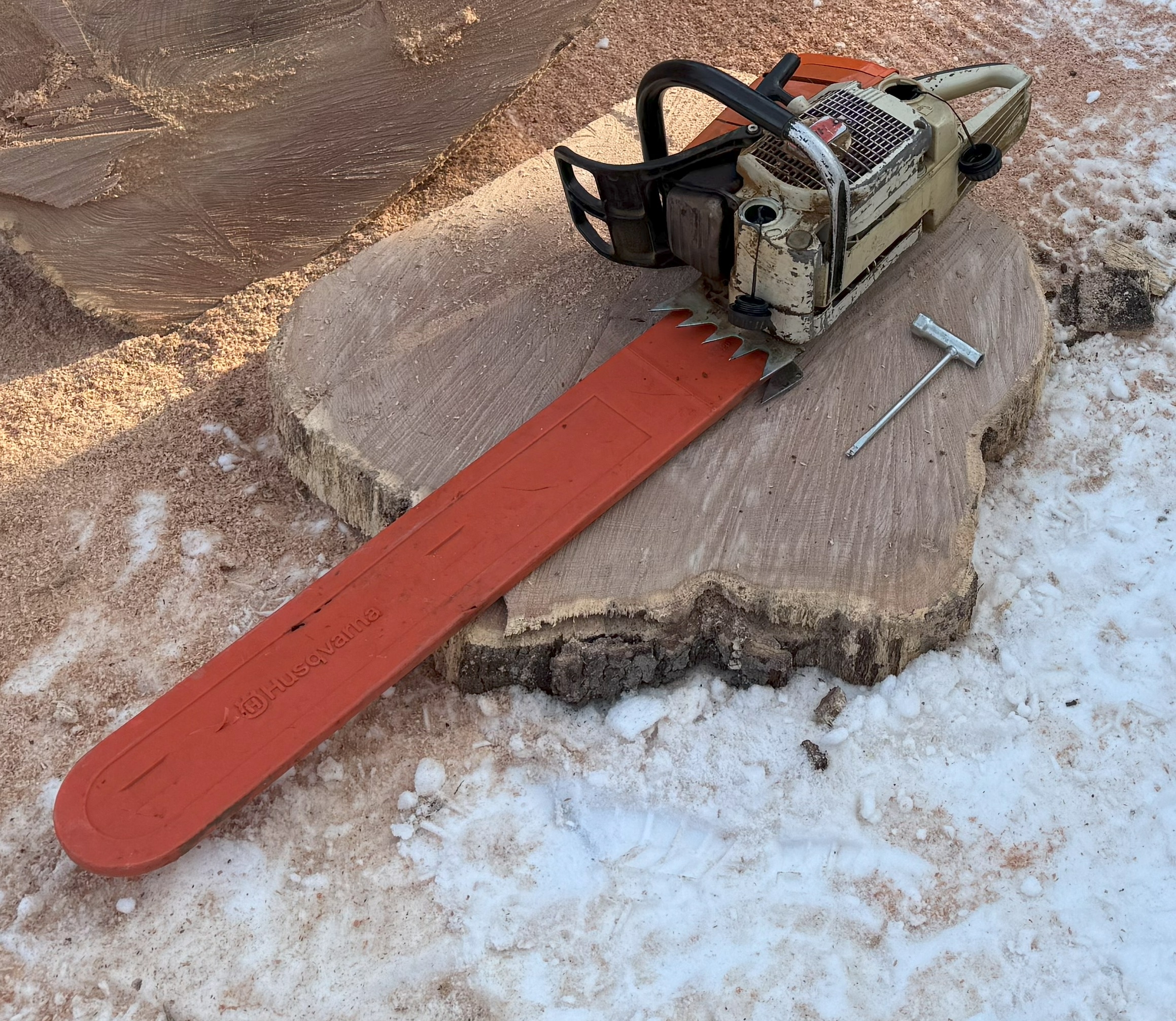

I have a Husqvarna 266 I bought new (1984 model) and it still screams. It seems to be heavier than it used to be but still runs almost like new. Several old guns from the 60's and 70's that are much better than new ones today, but they have been taken care of. Old don't mean junk if it has been taken care of regularly. Don't buy a new car because the ash tray is full. Neglect and lack of proper and regular maintenance is death on any machine. A grease gun makes any farmer money if it's used regularly.
