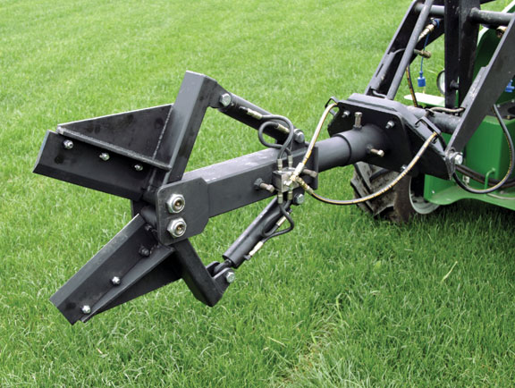

You mentioned a tree shear. Here is a home made tree shear that I made, and the next one is by Power-Trac. I also have a hyd chainsaw that could be mounted on a boom.

That is awesome J-J - How thick of a branch can you cut. How many control levers does it take.
/ Old Toro Reelmaster Project #23
Just one DA control valve. Will cut about 4 in. I can turn it side ways and cut level with the ground. I can also put it into the ground and cut roots, if I can see them. Here is a picture of it in a tree.
The lift arms uses one valve, and tilt another, and a third valve for the shear.

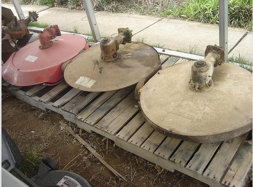

Toro actually makes mowing decks for machines like this look at Toro 4700D and 4500D machines and machine they call the side winder (forget the number). We have a 4700D at work great machine. However rotary mowers take a lot more horse power than a reel roughly 20x the amount (if i remember right). You might run out of horsepower for this plan especially if you are mowing tall grass. If you look at the reel equivilent of the 4700 it has a smaller engine. Good luck.

How did you couple the motor and spindle. Is there something to lock down the hyd motor to keep it from turning? Are you planning to cut off part of the deck housing to bring the blades closer so as to overlap?
As far as the HP to turn the pump, and then on to the blades, if the mass of all the reels is about equal to the mass of the blades on the decks, then you should be close in power application. If you are short on HP, then just drop one of the decks.
One other option might be to use light weight blades, not as thick and not as wide.

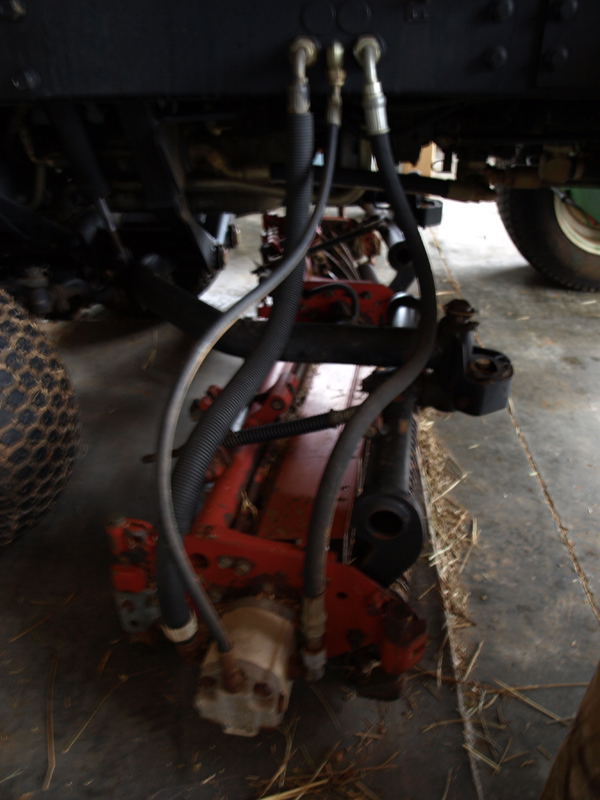

I used the mounting block off of the reel mower. I welded to a piece of 2.5" metal conduit. Then I welded a threaded 2.5' sleeve to the spindle. I did not have anything to get it dead on straight so Made a rig on my wood lathe to spin it and tap it into place until it did not wobble - Not high tech but it worked. I welded the spline sleeve coupler directly to the spindle shaft. Spun it the same way.
So I can unscrew the whole top part if I have to get to the spindle Shaft.
I put some wheels on it and a mount (Very rough) and ran it today. into some fairly thick grass. It cut it but I had to throttle the machine up to get enough power to the blade. I still have a blade speed issue to work out. - I have not run the line from the second pump yet. And the other 4 motors I have wired up out of the way - They just spin. I am wondering if when the deck is cutting into the higher grass, If the other motors speed up because they are not under load. That could explain the loss of power.
I still need to work out how to run the line from the second pump.

The one joystick drops the decks and starts all five motors. - But I am only using the front 3. I wonder if those motors are going to be big enough. Thats why I am just building one deck (roughly) to see if the HP is enough. I found that the 3 front motors run in series (dont know if I am using the right terminology), the exit port from one motor goes to the input port of the next.

R3 is a 1500 psi DPRV relief valve. Each motor develops about 7 HP. If you keep the blades light weight, you might get away with it. With 7 GPM, the blades are spinning at 1394 rpm. The third hose eventually goes back to tank. What did you do with the hoses once removed from the hyd motors? So the one valve is putting fluid to three hyd motors?

Have not taken the motors off yet (From the back) Just have them hanging from a wire to get them out of the way. So these motors are running in series. Input motor, out of motor, into next motor... Running in a line.. last motor exits fluid back into seloid valve block, and then I guess back to tank.
The back motors are running in a similar loop, In series. So I am thinking of running the output line from the back (after the valve) to the output line in the front (After the valve). And then do the same for the return lines - So I will have enough capacity to handle the increased flow rate out of the return lines. -
I am trying to keep it as simple as I can because a lot of these lines are connected as shown on the schemata. - So I would not be changine anything else - Just one input and one output.

The relief valves across the motors is 3000 psi, so I am assuming that the pumps are 3000 psi pumps.
In a series hyd motor circuit, the pressure is divided across each of the motors, so in a three hyd motor configuration, each is getting the same GPM, but the 3000 psi, is divided, and the load is represented by each motor, develops 1000 psi. In a parallel circuit, the pressure is the same if the load is equal, but the GPM is dropped across ever how many motors in the circuit.
Since you have two 7 GPM pumps, why not power 2 hyd motors in series with each pump.
In a three motor series configuration, each motor is developing 1000 psi, and developing about 185 in lbs of torque.
In a two motor series configuration, each motor is developing about 1500 psi, and about 277 in lbs of torque.
In a single hyd motor configuration, the hyd motor is developing 3000 psi, and about 554 in lbs of torque.
